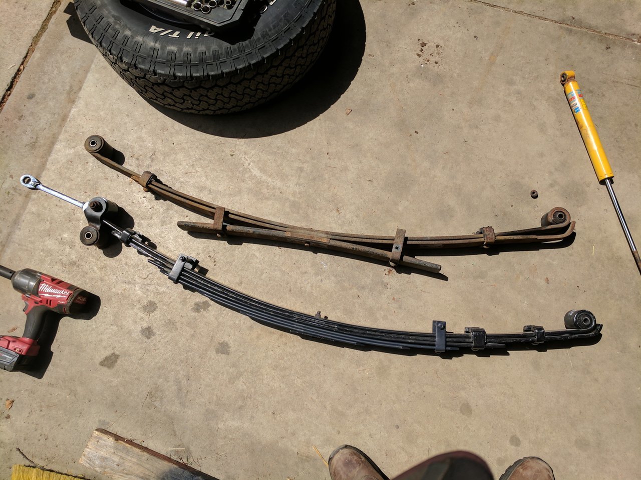

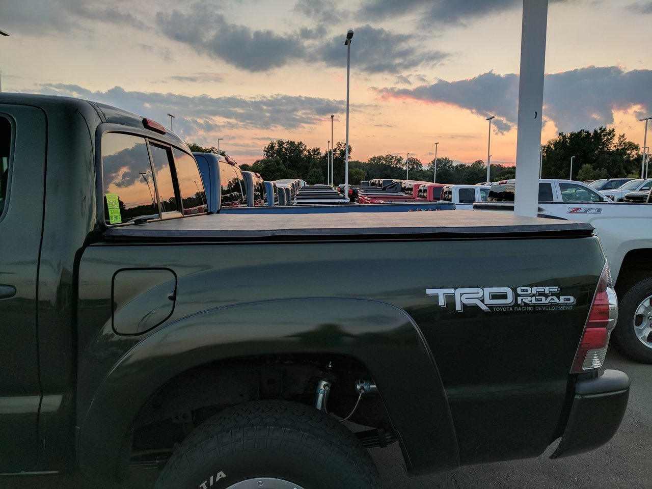

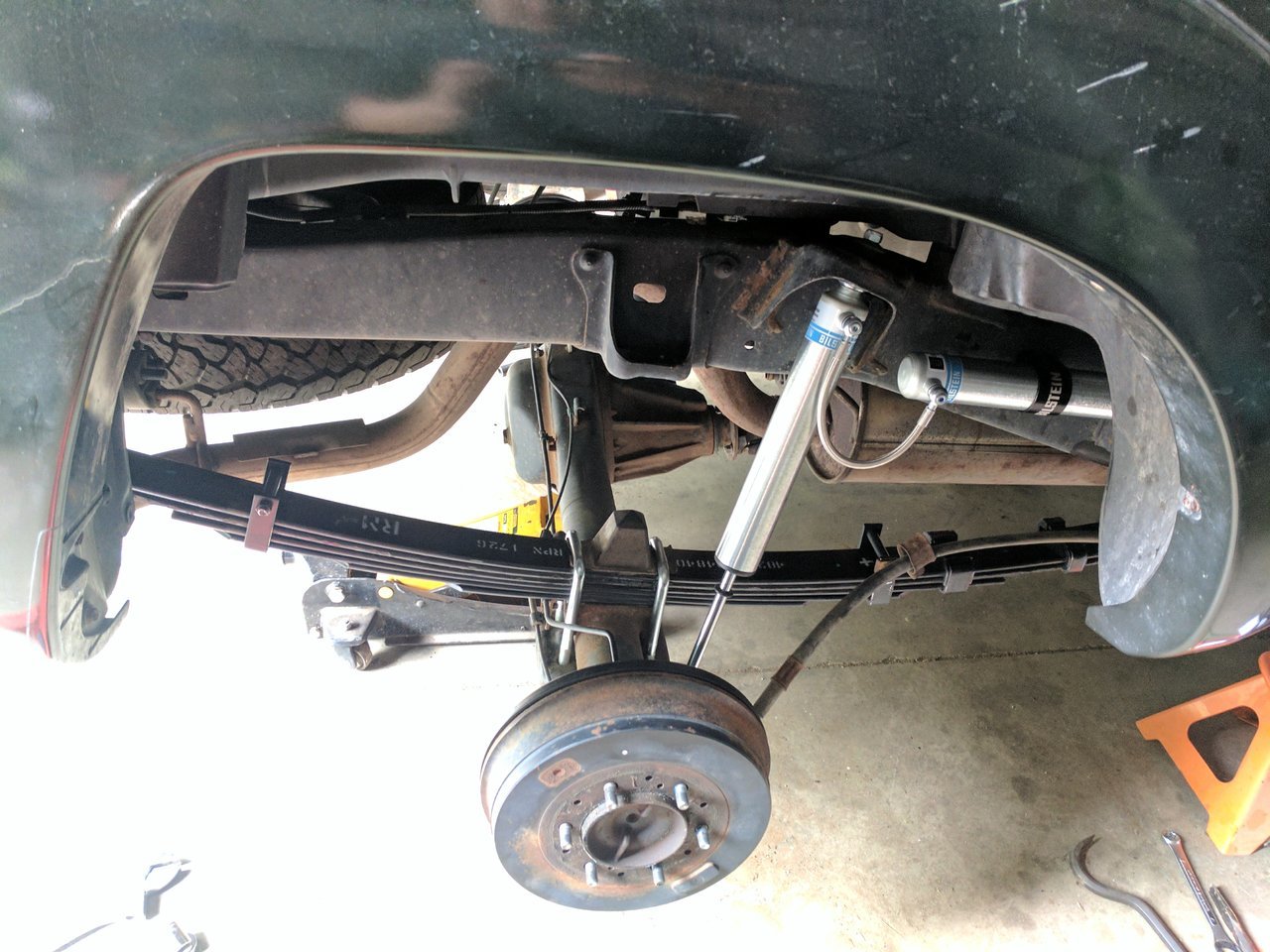

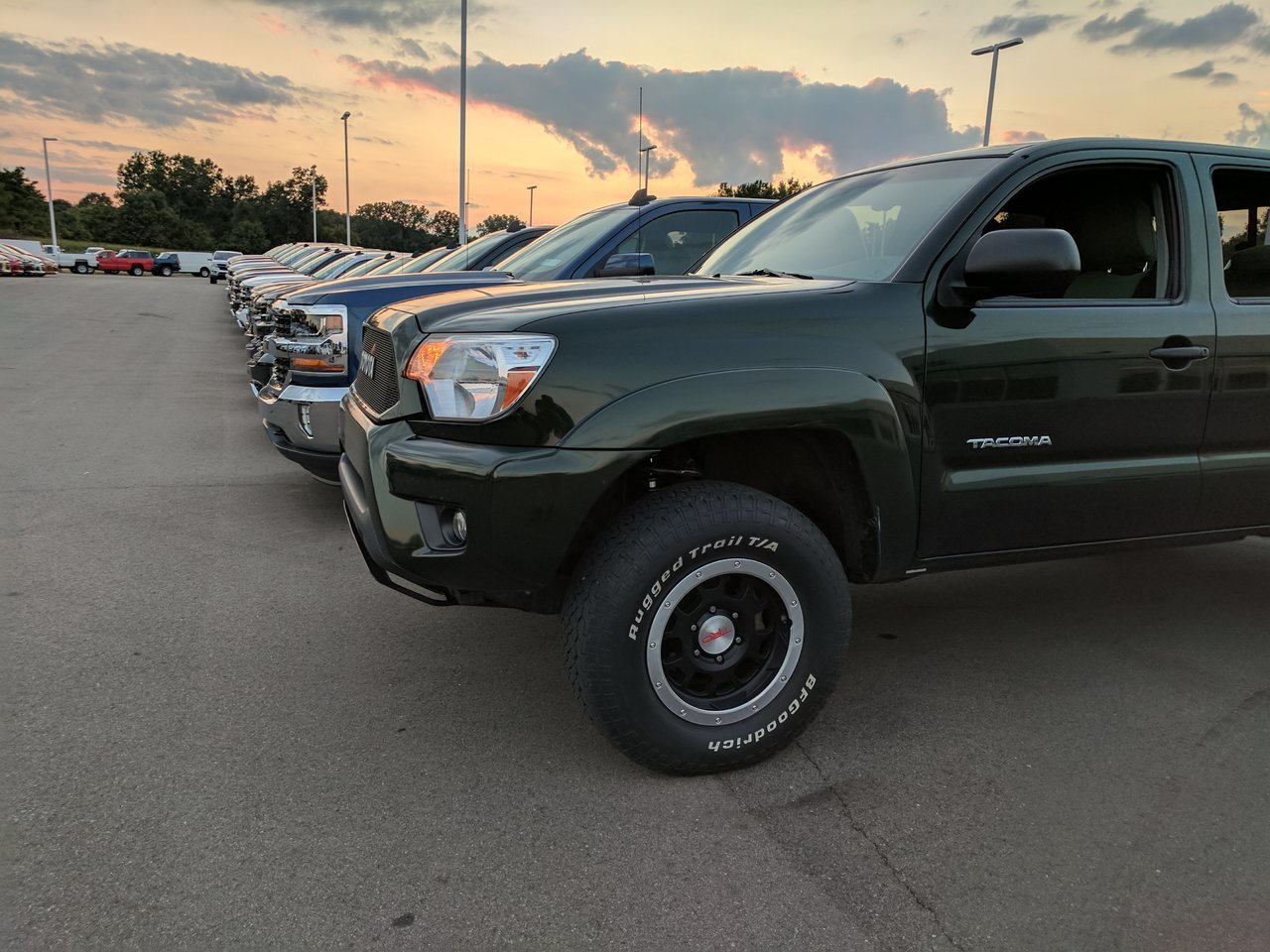

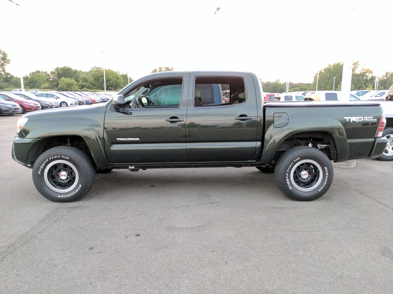

    Alright boys, so this is the final product.
    I should start by saying I had a very tired 2-leaf + overload stock pack before, that was literally on the overload 100% of the time unloaded. I was shooting for a full-size half ton-like capacity, and I couldn't be happier with how this turned out.
    I started in the rear with 5160s, a 3-leaf 2016 leaf pack and then a 3-leaf AAL from headstrong offroad. I dropped the overload and just went with a simple 6-leaf pack, with no overload.

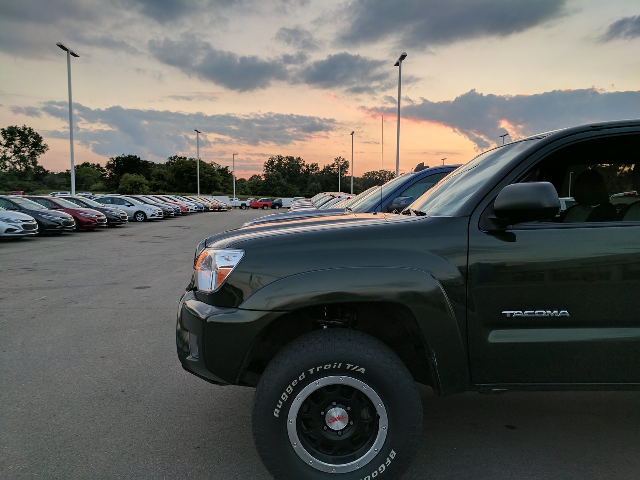

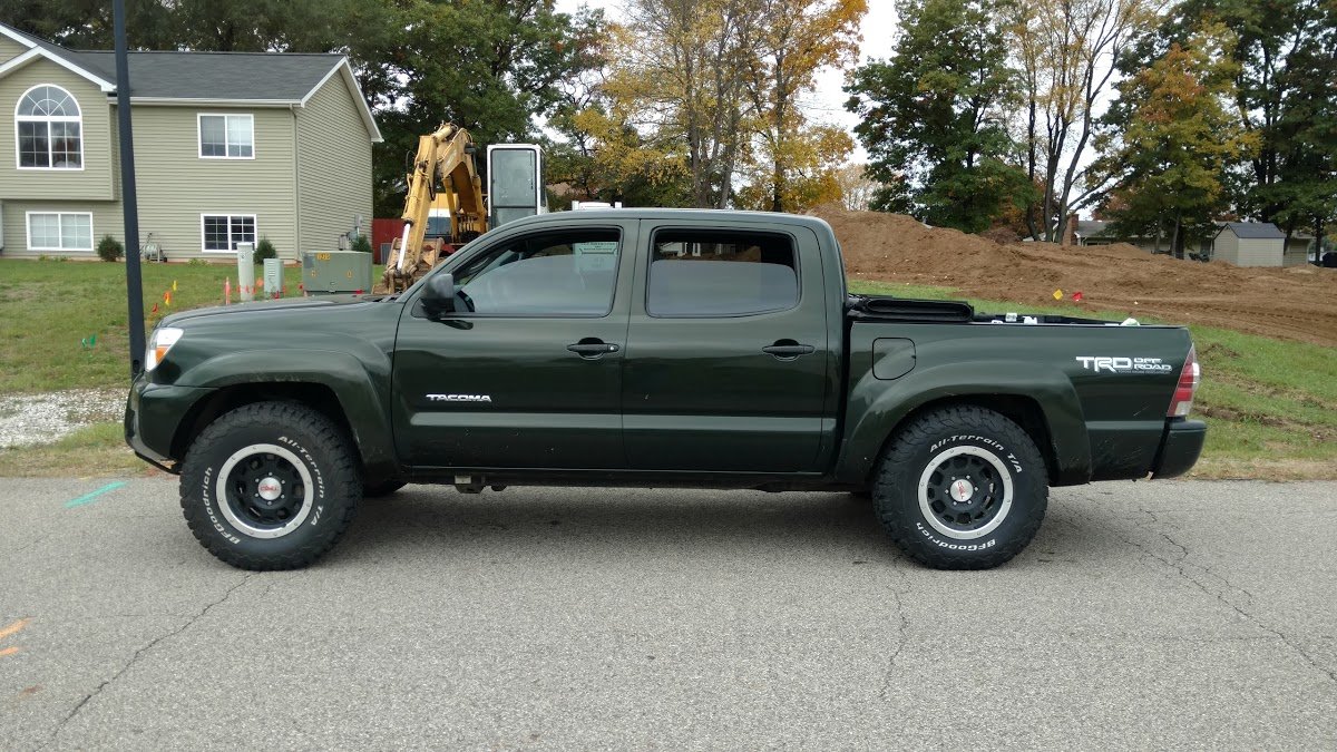

    In the front I went with 6112s on the second clip. I wanted to keep the stock UCA and also have some rake, and it turned out perfect (for me).
    Those of you looking to level your truck with this setup probably would be disappointed.

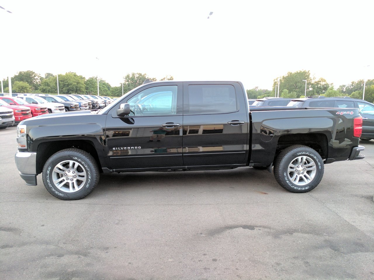

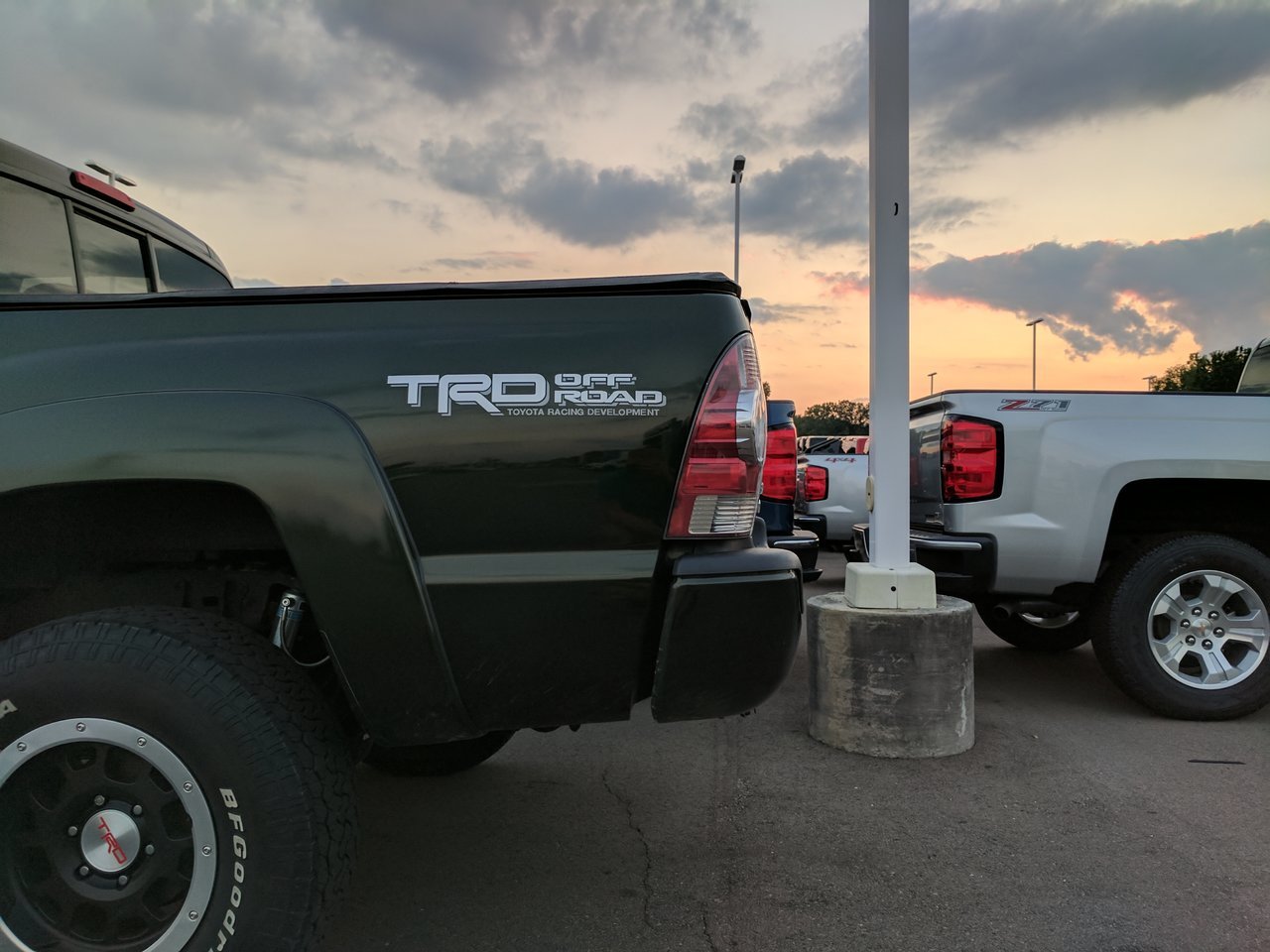

    I parked it next to a brand new Chevy 1500 to see how it compared. See for yourself, the bumpers, bed height, hood and rake all look very similar.

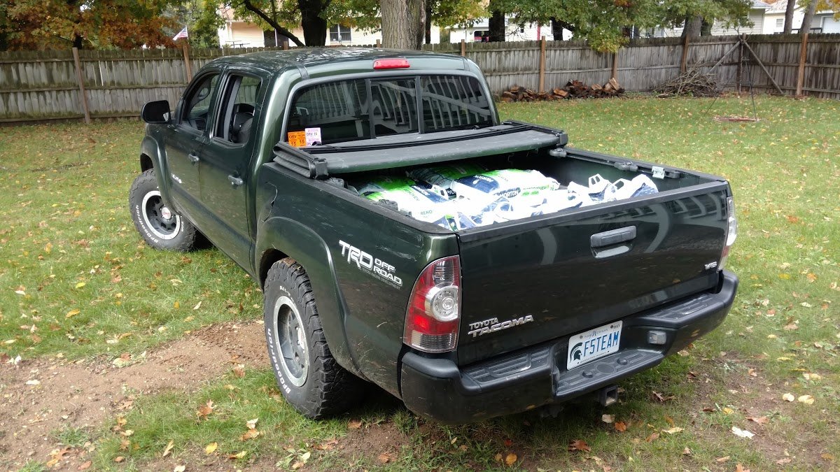

    Lots of take-offs, that's what made it easy for me. Another member on here sold them for $100+shipping.
    I'm not sure if they're actually more stout than the 2nd gen springs. If anything, I think it's the exact same as the TSB 3-leaf + overload packs that some 2nd gens had from the factory.
    As you can see, mine was pretty unlucky and I got a 2-leaf + overload and it was downright pathetic.
    This is what it looked like when loaded near the factory spec payload, 1,120 lbs of salt in the bed.

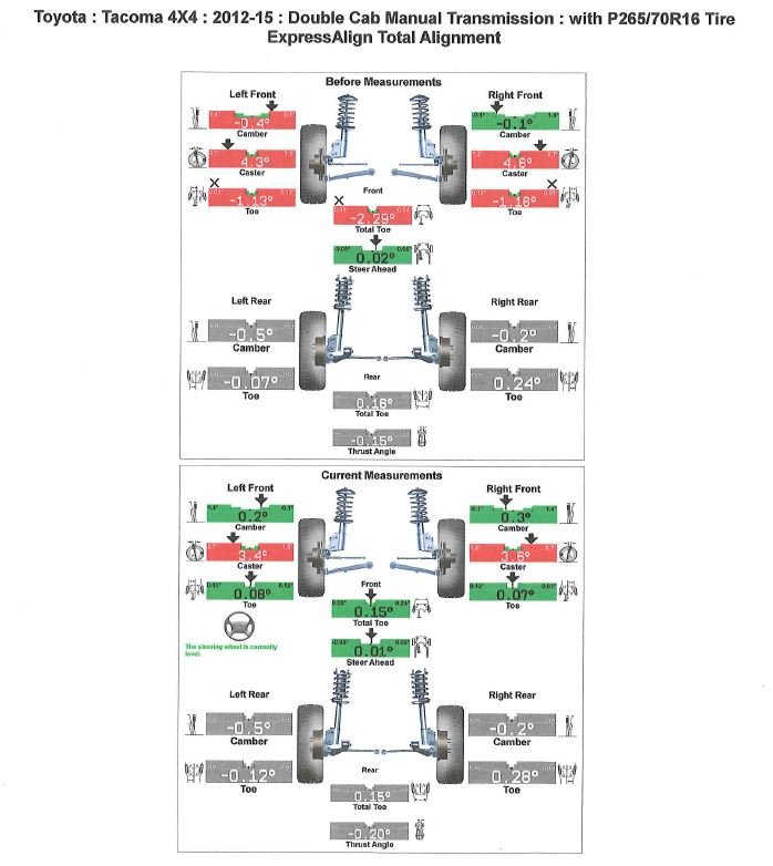

    I have B6112's and B5160's........................Just installed my OME095R leafs and JBA HD UCA's.
    I had no lights come one when i was driving it a local off-road shop to get my alignment done. After the alignment, the Tech said one of my light is "on" and that the "steering angle sensor is out and is at 270 degrees." They charged me $175 for the alignment but are clueless with the light, i should've just took it to Toyota for the alignment. Now i'm going to be $100 deep from Toyota just for a diagnosis from Toyota. The local shop is going to have a conference with their Techs and call me back in the morning.
    This is the light......
    Here's my before/after alignment....
    PreTaco170 likes this.

    You need to ask Toyota to do a "Zero Point Calibration" on your truck after the lift. That should take care of the problem. I can't remember how much I paid for it but I believe it was around $100-$125?? Maybe someone else has gotten it done recently and can give you a better idea. Mine was done over two years ago.

    What's a "zero point calibration"?

    Well I'm not a mechanic so I don't want to get technical about something I don't know much about. You can search it on the forums in the search bar or just Google it. Lots of stuff comes up. It needs to be done after replacing suspension components that change the height, steering angles, etc. The vehicle's VSC system is getting confused now that the vehicle has been lifted. All I know is I had the same problem and I brought my truck into Toyota. The Tech said, "Oh yeah, we see this all the time...anytime you change the suspension geometry you need to have a "Zero Point Calibration" done. I didn't have time to research it myself to see if it was something I could do so I had them do it. Fixed my problem.
