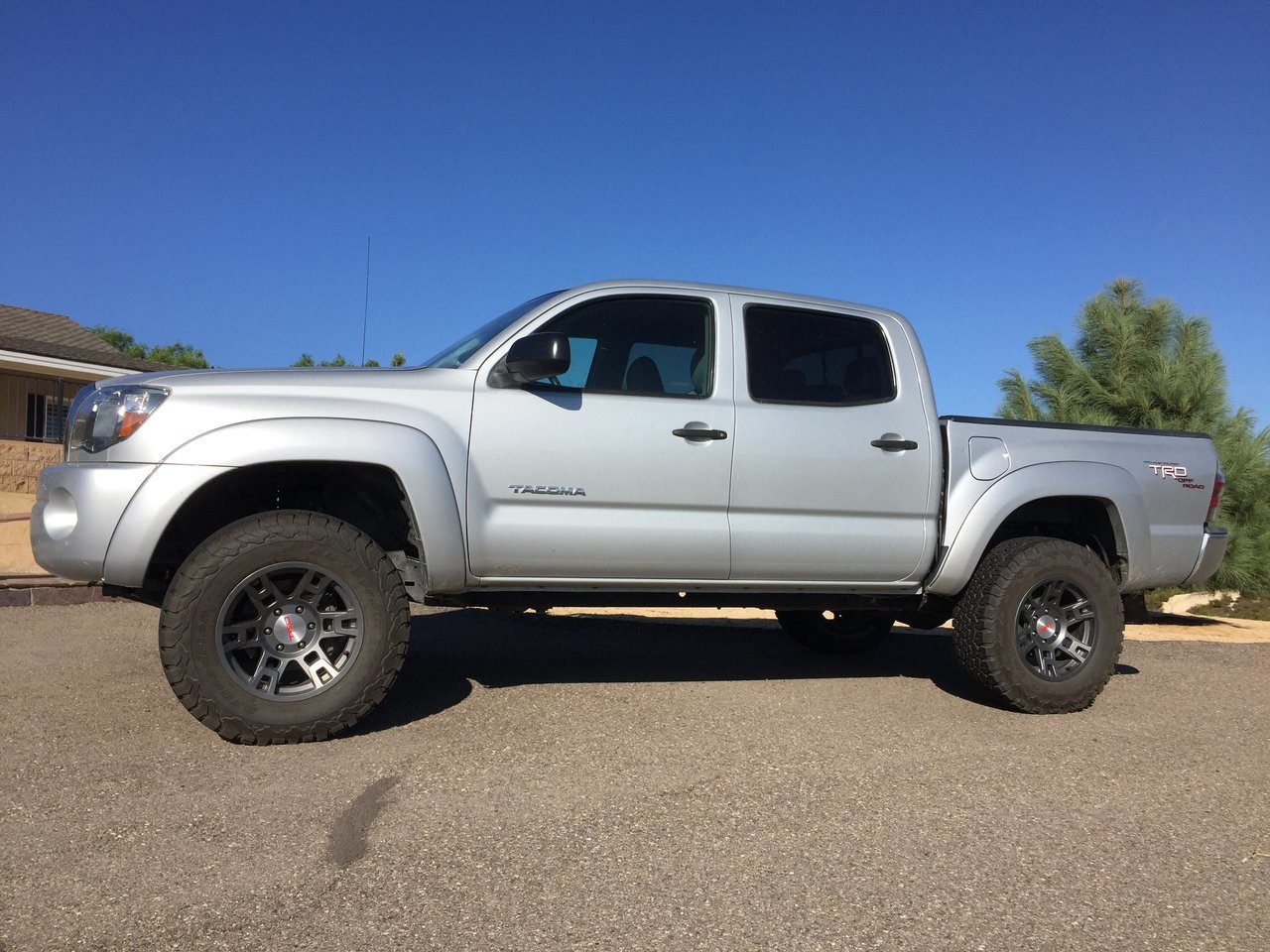

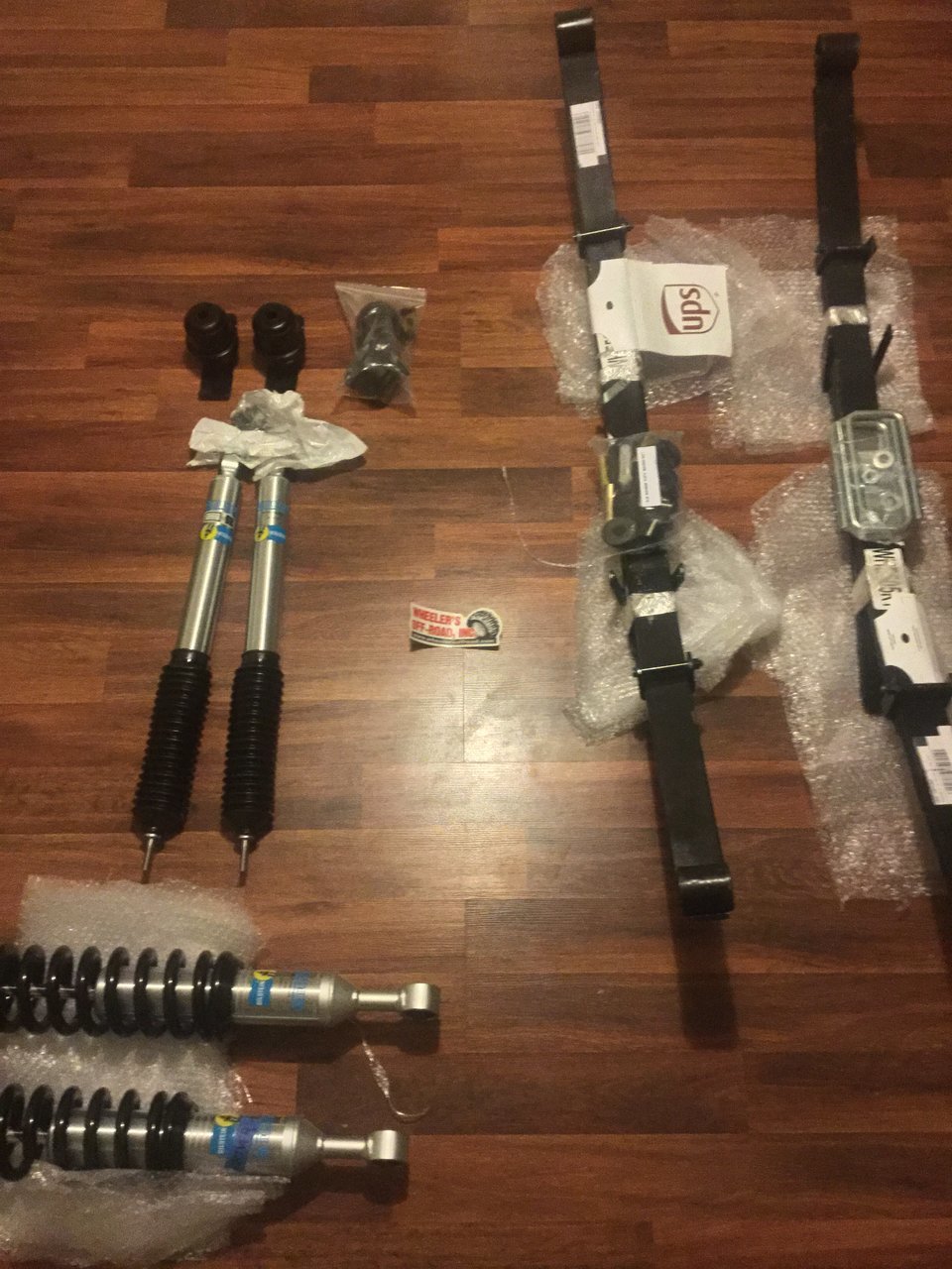

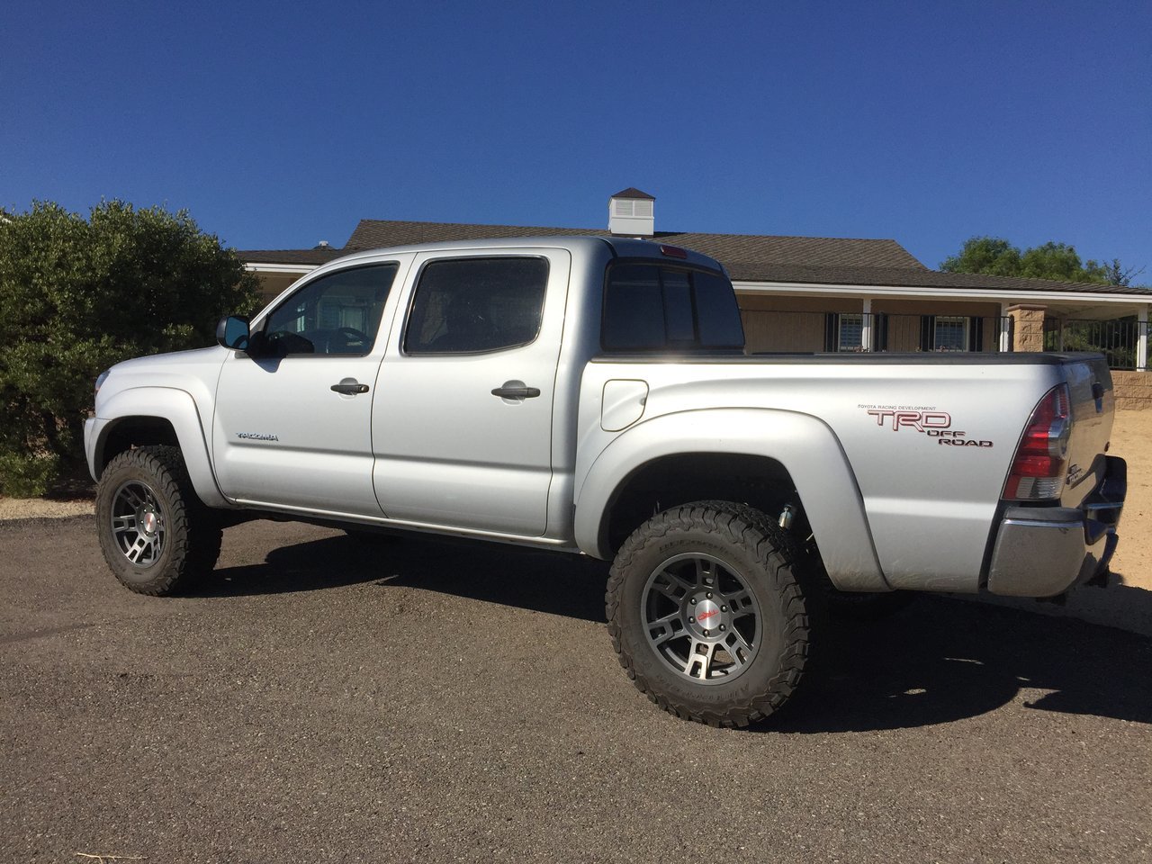

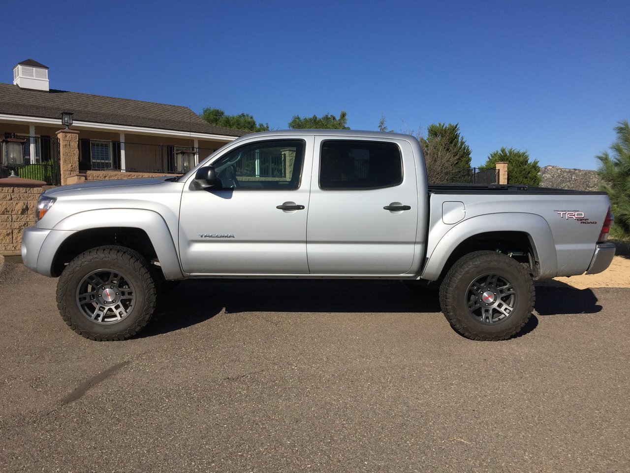

    IMG_4644.jpg IMG_4645.jpg IMG_4647.jpg After removing and reinstalling the 6112s a few times to try different clip positions, I'm getting pretty good at it! :D It really does go pretty quick once you've gone through it a few times. Of course, it definitely helps that I have access to a spring compressor for free!
    I ended up with clip position two (passenger) and clip position three (driver) with a 1/4" spacer on the driver side as well. I tried it without the spacer first since I was using staggered clip positions but I still had the TacoLean. I reinstalled the spacer and it got rid of almost all of the lean except maybe 1/8". I am running a modified Dakar leaf pack in the rear with the third leaf removed. This has resulted in approximately 2" of lift all around. I am a PreRunner and I currently have 1 3/8" rake with this setup. The suspension is definitely working smoother after lowering the front from clip position four.
    I haven't totally decided if I like the current amount of rake or if I may want to remove the top overload from the Dakars as well. That would probably drop the rear approximately 5/8" from what I've read. That would leave me with about 3/4" rake which I might prefer. Planning on driving it for a while to let it all settle in before making anymore changes. The pics aren't exactly on level ground but that's all I had available today.

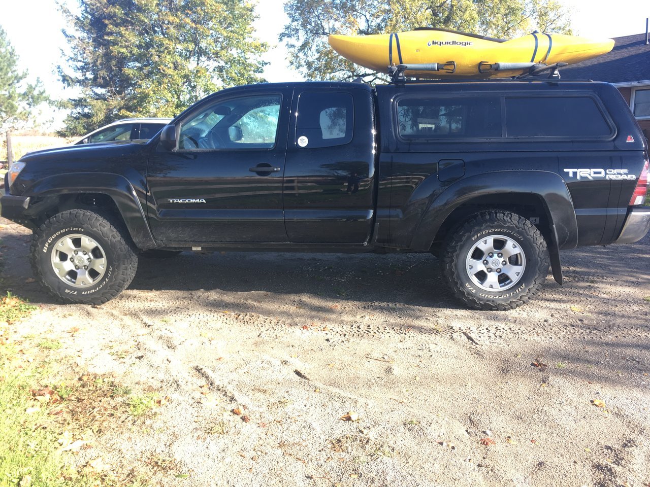

    Bilstein 6112 (2nd notch) & 5160, Leer 100XQ canopy
    Did anyone installed 6112 on second notch? How much actual lift (or hub to fender measure) did you get? Anyone saw a difference in ride from 3rd notch to 2nd notch?

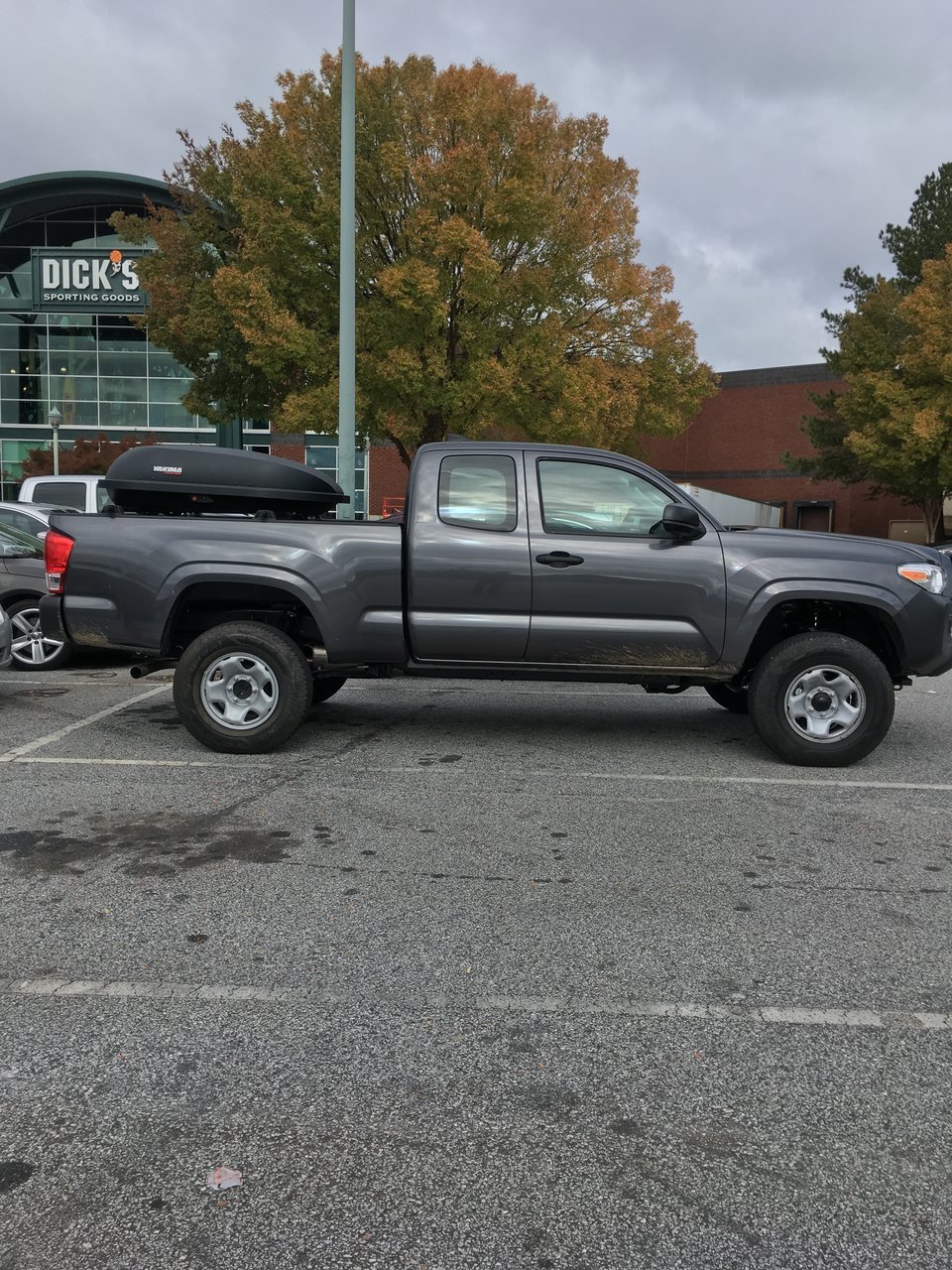

    3rd gen 6112
    5100 standard + Wheelers 5leaf HD pack
    On setting 4/3 front D and P are ~22.75 hub to fender
    Rear with the pack are also the same height at ~24.5 D and P
    It is a sporty ride I like it. Some vibrations arose, but that was expected.
