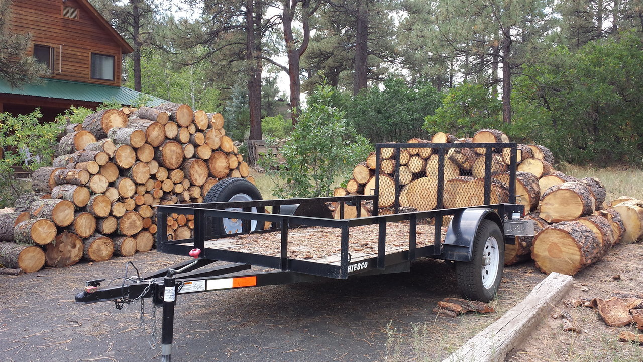

    That's the perfect combo. I did the 2nd notch on the 6112s, with a 3-leaf AAL and 2016 leaf pack, no overload and I love how it turned on. Handles just as good as stock, got rid of a little bit of vibes at certain speeds, less axle wrap and it handles a load so much better.
    Full cord of wood and 3 people and it's sitting just about perfectly level. I can finally use it like a truck without dragging the rear bumper around on the ground.

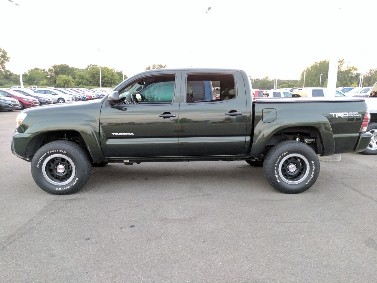

    Wish they kept the green paint job going for the 3rd gen...Nice truck btw!

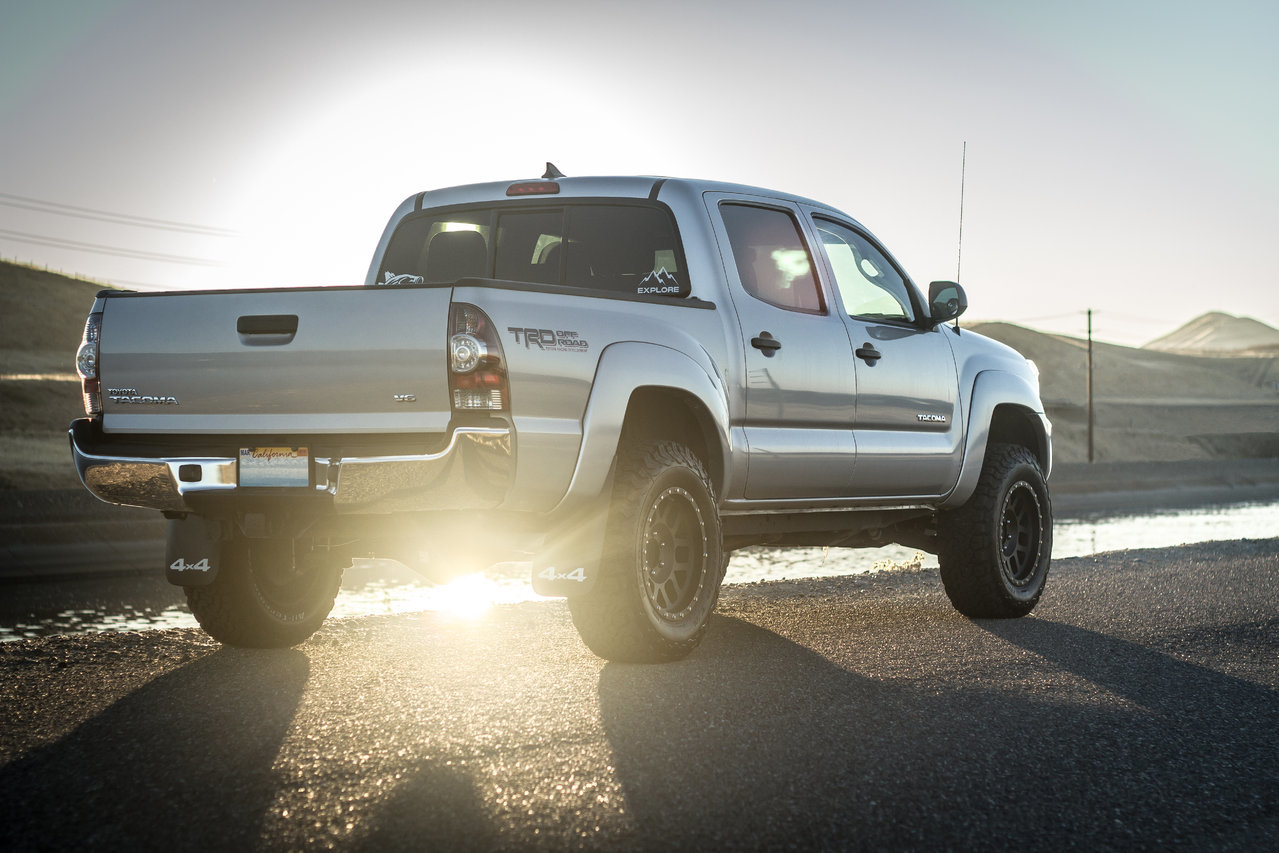

    If those are the dimension it is not. It's probably a half full cord (face cord?) Wood measurements are dumb. It was 4x8, but only 18" wide pieces of wood.
    I've posted it somewhere before, but here it is unloaded. There's definitely rake to it, but not to an obnoxious degree, and more importantly, it still rides well unloaded.

    6112 Front Shocks setting #3 with 5160 shocks in the rear with 3 pack add a leaf with the overload removed. The back is 3/4" higher than the front creating a small rake. Barely noticeable. Tires are 265/70-17. I'm pretty happy with the results.

    How much do you have wheel centre to fender?
    Thanks!
  8. Nov 4, 2017 at 1:33 PM
    #828
    Tacoma _2013
    Tacoma _2013 Member
    Mar 10, 2017
    #212927
    13
    Thanks! I take my own pictures & edit them :)
    It's 22 inches from center of wheel to fender in the front & 22 3/4 inches in the rear.

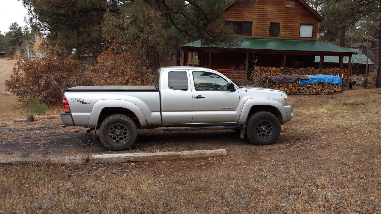

    That looks perfect IMHO. I think there's no way around knocking fronts up to #3 if you go with 3 leaf AAL minus overload, at least on the gen 2's. I like the level look with as little rake as I can get. Plus handling wise at least where I live and the snow etc., too much unloaded/high rear you get this snap oversteer after bad understeer which is a pretty awful combo.
    Looks great mon. I like less of a rake though I think I'll just have to resign myself to upping front to #3 if I go with 3-leaf AAL. Here is my dirty truck as of today, not on level ground but close. 265/75-16's Falken Wildpeaks. So this is 6112's on #2 in front, 1/4" spacer driver's side, rear TSB leafs & 5160's.

    I don't have the exact measurements and there is virtually no level ground around here. But I did measure on a level pad at a gas station before/after (but with my old wheels and tires) and got right at 1.5" lift in front. I was mainly concerned with leveling it after getting the TSB leafs vs actual overall lift and that was hit virtually on the nose F/R when I measured last. As I said earlier even with the DS spacer I need to tweak it very slightly with the RR adjustable sway bar link (the Helwig kit) to get the LF up a tad, like 1/16".
    So the point is I guess with the TSB leafs on gen 2 you get pretty close to level with 6112 on #2 in front. Add the 3-leaf AAL w/o overload looks like you need to go to #3 to stay close to level, even with a bit of settling in back on the TSB's. Even then you'll have maybe 1/2-3/4" rake F/R.

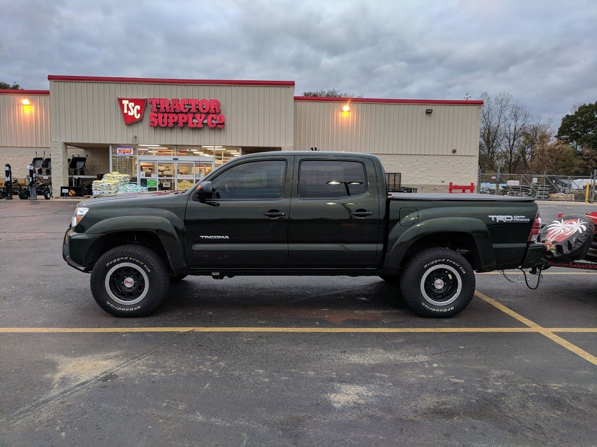

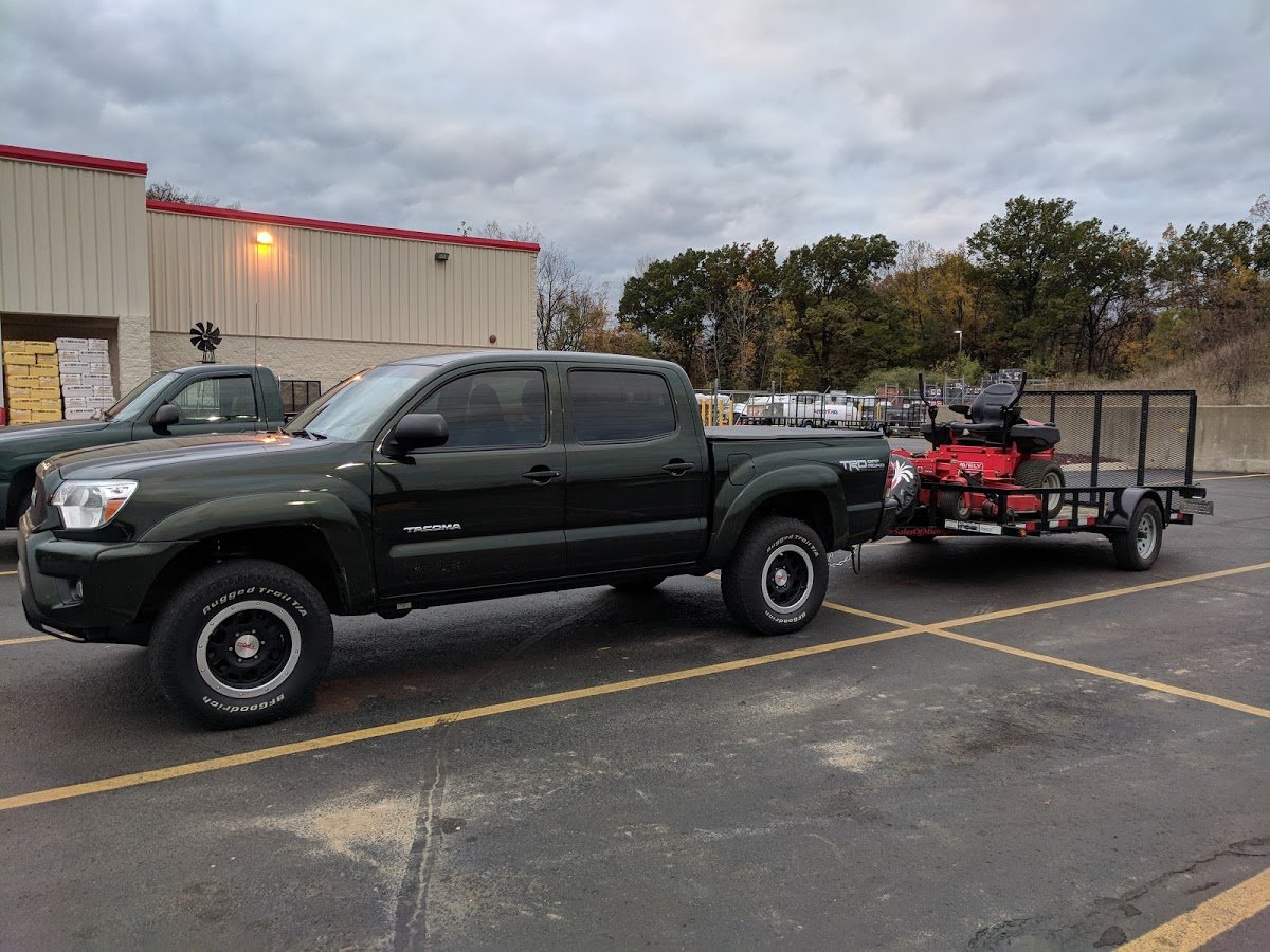

    If you're going for a more level look with very minor rake I agree. I tend to load my truck up fairly often through the summer, so I went with more rake to let it handle the load of either a heavy bed or heavy tongue weight.
    This was just a week ago. Fairly heavy tongue weight because of where the mower was sitting, I needed room to load 3 bails of hay on the back of the trailer. As you can see, nearly perfectly level with that sort of load.

    Oh I agree completely. It's funny I have nearly the exact same trailer now, and I used to have a 7x14 enclosed double axle trailer I used to haul big motorcycles (a lot). With the latter trailer it was almost impossible to load it up with 2 big bikes so that the tongue weight did not crush the rear suspension on the Taco. This was the OEM OR suspension prior to the 6112 & 5160's. So I put in a single AAL. Truck sat perfect when hauling and looked stupid (ass 2" high) + handled really evil when not hauling the loaded trailer, esp in snow. So I removed the AAL and ended up hauling less often when I moved to where I'm at now, and sold that trailer. However even hauling that bigger trailer unloaded or lightly loaded, the rear looked fine sat mostly level without the AAL in. FWIW I hardly ever load the bed up with heavy stuff, most is a dirt bike or tools. Mainly because I bent the tailgate trying to haul a big cruiser in it, way back in '06.
    Fast forward, I needed a trailer for hauling small things and a single bike from time to time, so I got an open 6x10 with rear ramp like yours. Mainly for hauling wood (my primary source of heat in winter) which worked fine with the stock susp if I was careful about loading the trailer without too much tongue weight. Did that for a few years. The stock susp was getting tired, rear was sagging badly under load, so did the TSB leaf spring recall. Then it looked stupid high in back again, and the scary bad handling came back in ice & snow. Grrr. So that is what triggered the 6112/5160's, then found this summer that it stayed pretty level even pulling loaded trailer full of wood. I do try to load it up pretty evenly without too much tongue weight though. I can get about 1 to 1.5 cords of rounds in that trailer. Don't have any pics loaded but you get the idea (prior to splitting). The pile on the right is all green wood, some of those round weighed over 200 lbs each and were lots of fun to load and unload.
    The second pic you can see the Taco with the 6112/5160's but old OR rims and worn out Yoko Geolander tires. Still sits pretty level after hauling ~ 7 trailers of wood out just prior.
    So what is the point? In my case it is more than just for looks that I want it leveled or just small rake. I have found handling in ice and snow (up to 6 months of my year) to be very dangerous and unpredictable when unloaded and rear 2" higher than front. Raising the front of the truck up 1.5-2" to match, and then loading a (smaller) trailer more evenly eliminates most/all of the rear sag associated with towing, at least for my present needs. Also gets rid of some of the scary handling due to too much front weight bias. And I did not want to mess with air bags.
