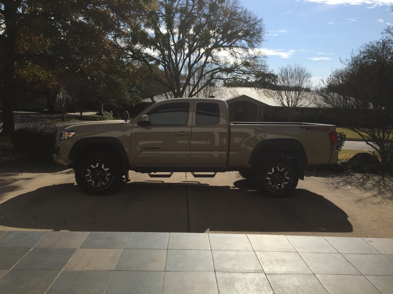

    How about those pics of the whole truck?

    The lighting isn’t the greatest but I can get some more today.

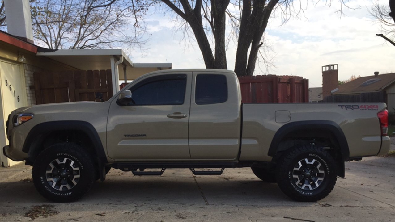

    Here’s a pic with better lighting.

    Could we get some hub to fender measurements from you? I ask because I don’t see many 3rd gen access cabs around.

    I told myself to get before measurements and I completely forgot to do it.
    Front: Both sides are at 22”
    Rear: Both sides are at 24-1/2”
    **Measurements were taken in the garage, not on my angled driveway you see in pic**
    That’s a lot more rake than it looks. I was surprised by that. I’m not too worried about the rake though. I’ll have a shell with roof rake and it still needs to settle. Good news is I still have room to go up one setting in the front eventually. Which I may need to when I get a hidden winch.
    If I was to leave my truck as is (no shell or roof rack) I’d suggest going the 4/5 setting if you are getting the Dakar leaf pack. Which I recommend you do, it rides amazing.

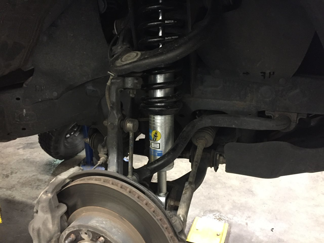

    Bilstein 6112 up front set at the third notch with SPC UCA’s, Bilstein 5160 in the back. 285 75 16 Yokahoma Geolander MT
    0207B99B-6CFF-4A7E-870D-7BDFF2D94689.jpg 6067E70D-81B1-4FB2-ADC4-0D032844C3DA.jpg
    I’ve had mine on for just over a month now and have not settled at all. The 6112s are on the highest setting and netted about 4” of lift on my DCSB. With the blocks on the back I’m sitting perfectly level and I’m clearing 285 75 16 tires.

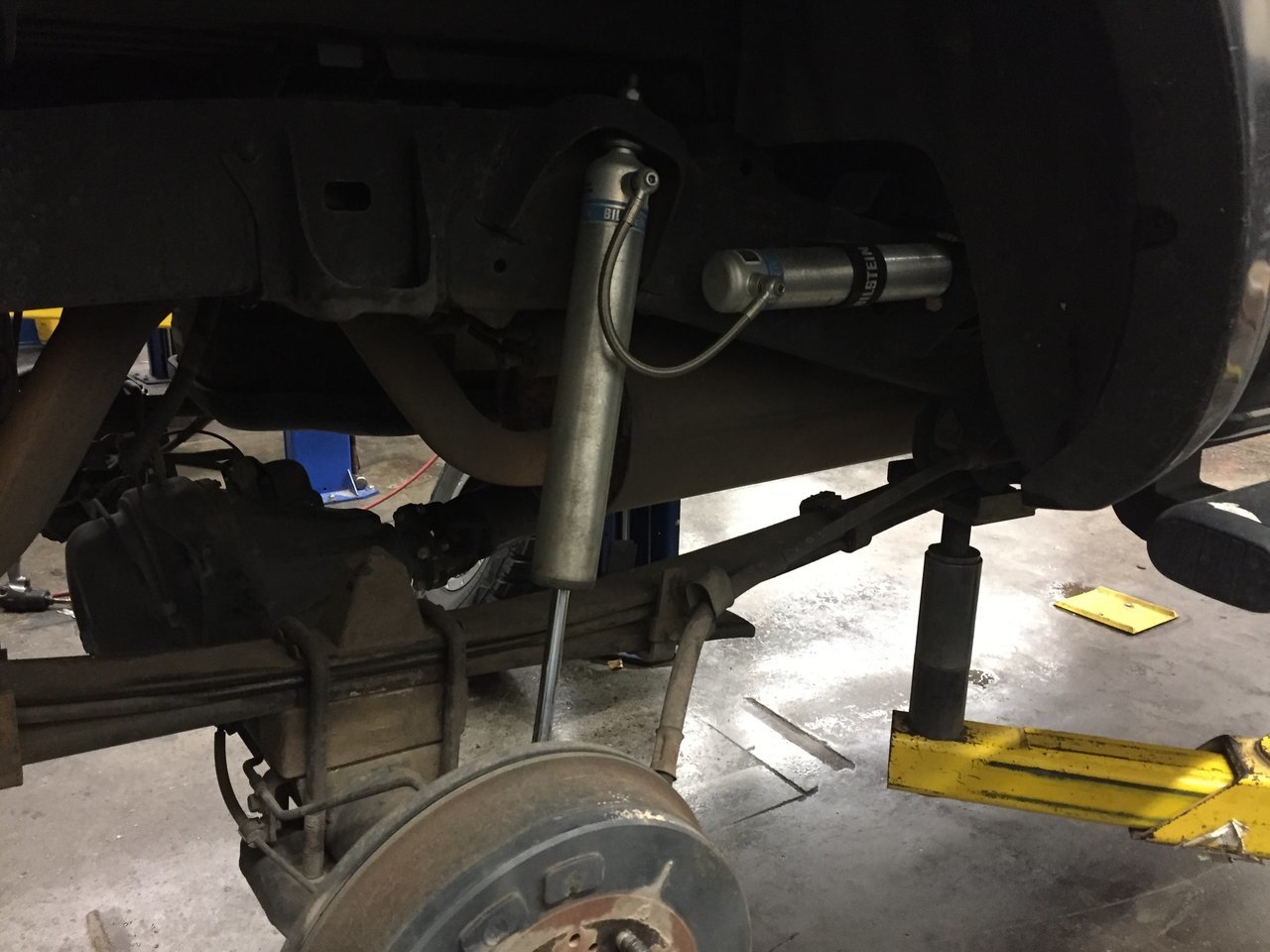

    As I mentioned earlier I got a set of 5160's to replace the 5100's. I installed them the other day. Getting the resi's on by myself was a pain especially on the muffler side! A little driveshaft grease on my neck and bumping my head into the rear end never hurt anyone! Just trying to see and get the things mounted to the frame. Anyhow its all good now. So far just on the street I cant feel much difference maybe just a tad firmer but I'm sure they will work much better off road. I did get 1.25" more droop due to the longer extended length which was one of the main reasons I wanted them. I've had one of the rear wheels off the ground several times so this will help. I didn't want to have to extend the bump stops for longer shocks, so these suited me well and they are the matching shocks for the 6112's up front. Plus they just look cool. The 6112's have settled about 1/4" since installing 1.5 years ago (3rd setting) I have about 3/4" rake now and its perfect. I hope I'm done with the suspension for a quite a while, no time for this anymore. PICS
    before
    after
    how she sits now

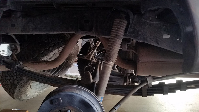

    I noticed this on my drivers side yesterday. It slides up and down easily. But the passenger side it’s on the shock body. Ride hasn’t suffered at all.
    Hard to tell but it looks like the top cap of the shock body. Anyone had this before?

    Is that a washer? it almost looks like you lost the top little spacer that's under the washer and rubber bushing

    It doesn’t seem to be a flat washer. It has multiple “levels” to it. Like it is a cap that fits into the top of the shock body. I have to get my last free service done on my truck soon so I’ll have the dealer look at it since they did they install.

    They’re talking about the small little washer as shown in the picture it lets the lowest flat washer sit on top

    yeah have them take a look see at it. they might have to disassemble and check the shock make sure nothing is damaged

    The term in the instruction manual believe is an adapter . It goes adapter - flat washer - rubber - top cap , rubber , flat washer - nut - I have a brand new set of shocks at the house, that if you need a picture of the exact part close up I can get it for you when I get back home
