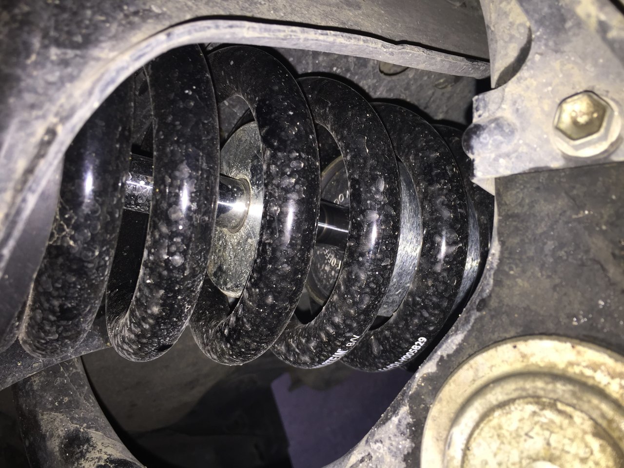

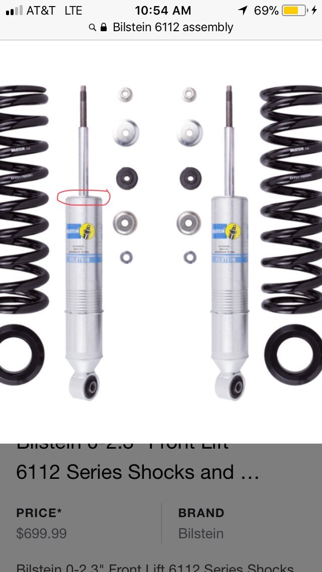

    Yeah I’m talking about this piece. That’s what appears to be loose and floating up the shaft.
    Also, your phone battery is at 69%... lol. Yes, my sense of humor mirrors a twelve year olds.

    well that's the top of the shock body, if that's the case then the top of your shock is blown out

    That’s definitely concerning... looks like I get to swing by the dealership on the way home... awesome.

    yeaaahh that's def not a good thing. The odd part is you saying the ride is still ok. So if its just a "decorative" piece then you might be ok for now just get a hold of Bilstein and see if they'll take care of it. Let us know what it turns out to be. Since you haven't noticed and oil all over the shock then the body may not be fully compromised yet. But again let the dealer take a look see

    Yep that’s truck would need to be replaced, probably under warranty . The spring Is what is holding the truck up, but the front of the truck should be really bouncy On that side

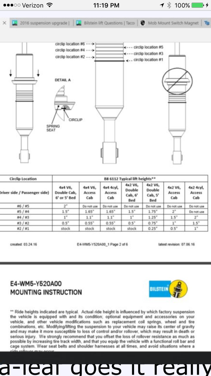

    You will need notches 5/6. You will likely need a CMC. I don't think you will need UCAs really. The 6112s on those notches still ride good as the springs that come with them are made for the whole range of the shock adjustability. Mine don't clunk at 5/6.

    Here ya go, CMC all depends on your wheel and tire specs. Not all 33" tire are the same but I assume you may need a CMC. Always plan for it. Very inexpensive to do. Can buy the CMC plates from most aftermarket retailers.... mobtown, relentless, pelfrybilt, about 20ish buck. Just have to find a good welder.

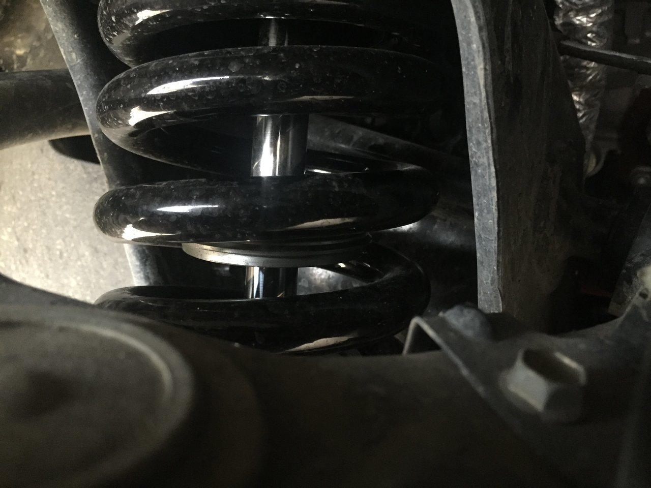

    Turns out it is a "scraper cover" that acts as a cleaner for the rod as it enters the shock body. the top is still sealed as seen in this picture. It's just a press fit part that came loose, I guess. Google search showed several other people having the same issue but Bilstein didn't seem to want to warranty it. I went ahead and sent the pics over to the dealer anyway to see if they'd look at it. I am considering moving up one notch setting anyway so it may be beneficial to have the top cleaned and then have this cover pushed back down during that process.
    That would explain why the ride hasn't suffered. But it still seems like a shitty thing to happen less than 200 miles into ownership. doesn't do much cleaning when it's halfway up the rod...

    well then. sucks something came loose, but same time glad its nothing super serious. Bilstein probably considers that in the same issue as coating coming off. It affects the looks but doesn't really affect the performance

    Exactly my thought. Seems to be a non issue and I’ve got it documented in the case of premature shock failure. I’ll try some stuff to get it to stay seated where it should be and just let it be. Still thinking about moving up a notch...

    I wouldn't accept that. That's an obvious defect. IMO

    6112 notch 3
    3/8" DS spacer
    This should get me around 2"
    I see the 5160 is recommended for 1" or less of lift, would they be okay on a 2" AAL? Or would there be a better option. Im open to all ideas on what to do on the rear as far as an AaL/spring shock setup.

    Spacer shouldn't be needed with 6112. Go 4 driver 3 passenger and I would recommend leaf springs myself. With my Dakar leafs 300 pounds in bed they just start to move.
    I have a 17 at max notch 6driver 5 pass I gained 3 inches exactly. Dakar leaf gave me about 2 inches with 200-300lbs in the bed. Lots of options and all depends on budget I would give headstrong a call too.
