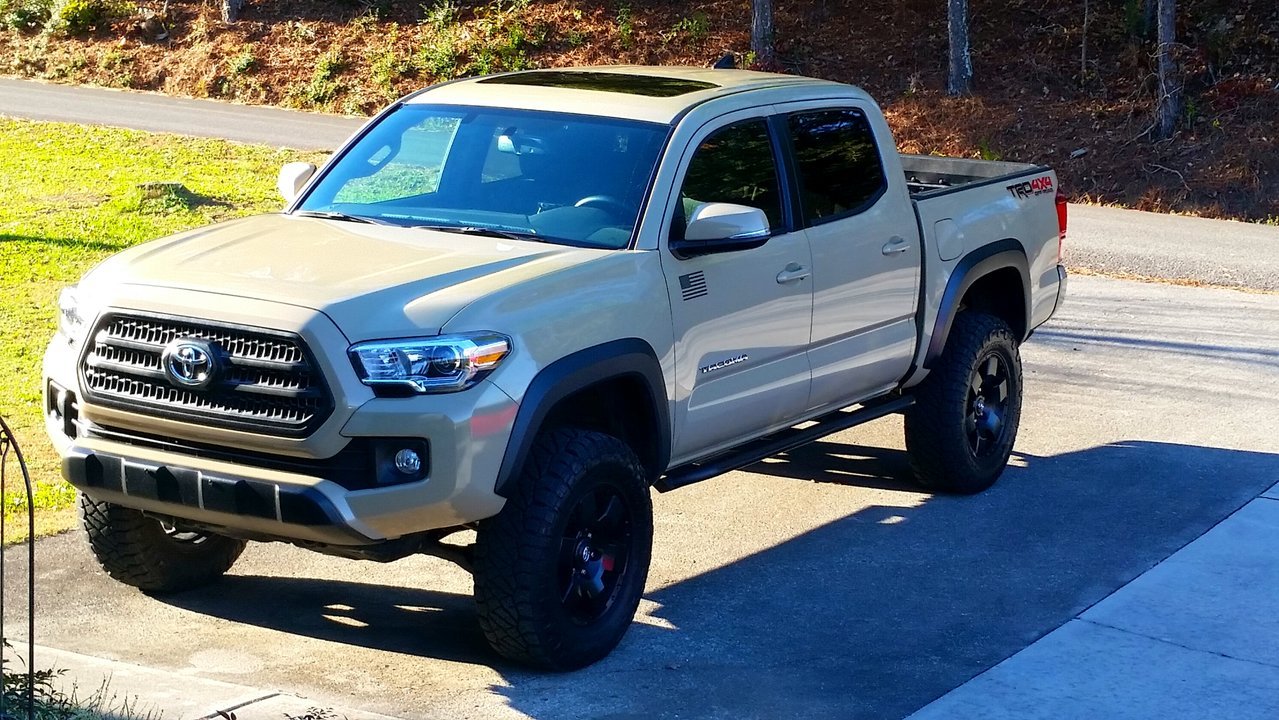

    2017 trd or dc quickaand

    So stock.
    Great, thank you! Your truck looks awesome btw. I really like the stance.
    Thank you. I am very happy how it turned out.

    2017 Tacoma TRD Off Road MT
    Looks great! Did you have to change the UCAs or where you able to get the alignment in spec w/ the stock UCAs?

    Thanks. The alignment was fine. No UCAs.
