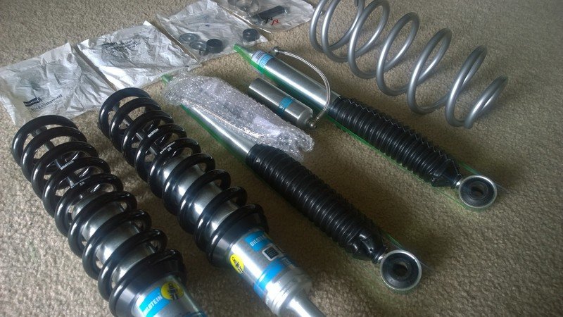

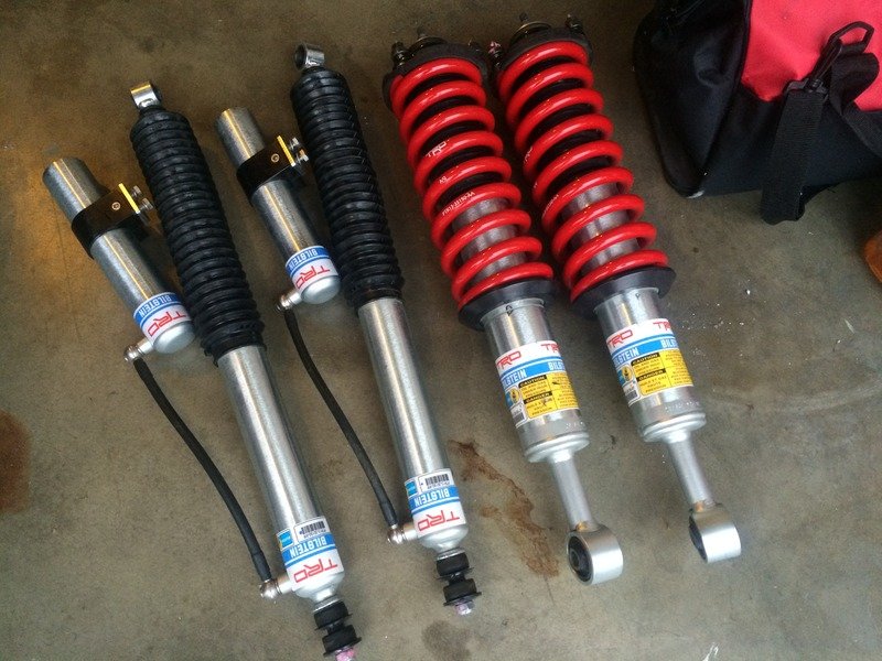

    No not at all, just I have read they are very similar, at least in front w/ 2.5" Bilstein shocks and similar damping etc. I think they are not adjustable though but not sure. Have also read this was done in conjunction with TRD idea being to mass market what Bilstein did for the Pro to ordinary Tacos (and Tundras, 4runners etc.). Then for some reason they switched over to Fox in 2017 IIRC.
    Decent article here:
    https://expeditionportal.com/did-bilstein-just-make-the-ultimate-4runner-overland-suspension-system/
    Pulled these off another site, these are Pro vs 6112/5160 for 4runners I think:
    9A55004F-E7F2-4198-8B5E-E904DCBBF8FB_zps_a0021c837b22ca667a1a538e8516fffbebe98258.jpg

    Same components but no adjustability on the fronts. They are fixed at 1.75" I think? The spring is a little different too depending which kit you get? One thing I do like with the TRD units is the dust boots. I wish I had those just for longevity and protection. Also much more $$

    The rears have reservoir don't think the fronts do in either case (pro or 6112). The res is a bit bigger in rear on the Pros vs 5160's
    https://trdshop.carlocktoyotaoftupe...oma-tx-pro-baja-trd-suspension-kit-ptr1335120
