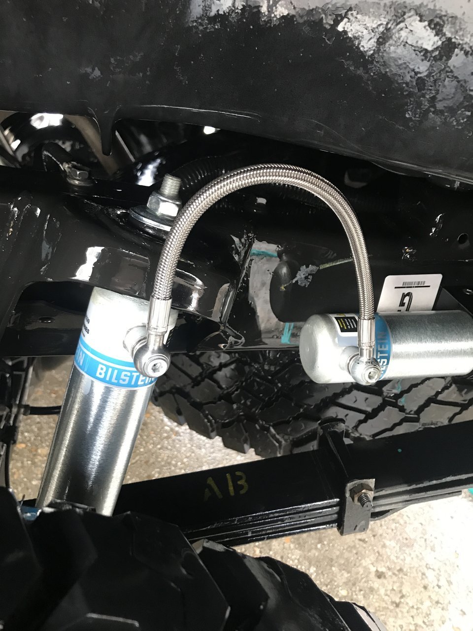

    Got my 6112/5160 installed yesterday, paired it with camburg ball joint UCA’s. Install took about 5 hours from start to finish. Couldn’t be happier with the results coming from 5100’s all around.

    Any blocks or aal on the rear?
  6. Jan 16, 2018 at 6:19 AM
    #1006
    snowmanwithahat
    snowmanwithahat Well-Known Member
    Jan 11, 2014
    #120444
    1,555
    2013 Spruce Mica DCSB, TRD OR, V6, Auto
    Looks like an AAL based on his pictures.

    was wondering myself, says Dakar medium duty leaf pack on his sig

    Picture show EL095R which is the OME leaf spring pack. Same ones I have. I'd recommend them over the AAL all day. Way better than the AAL I had before.

    This is correct, I have the OME medium duty leaf pack. I had a block previous and this leaf pack was well worth the money.

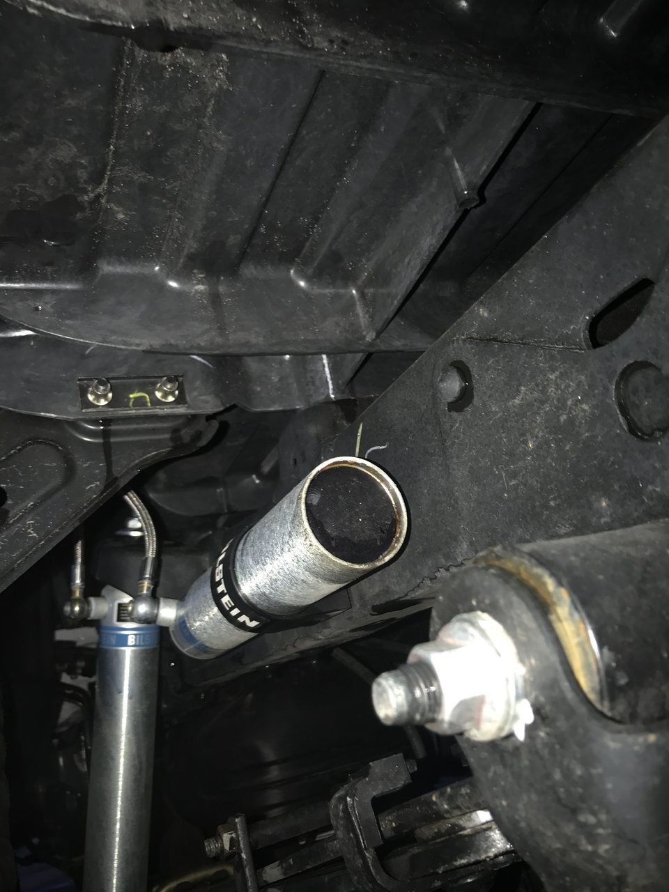

    FYI: Salted roads suck during winter season, both sides look more or less the same for surface rust and that's me rinsing it quite often with a powerwash. I have fluid film but I was sick at the time before the snow fall. IMG_0068.jpg

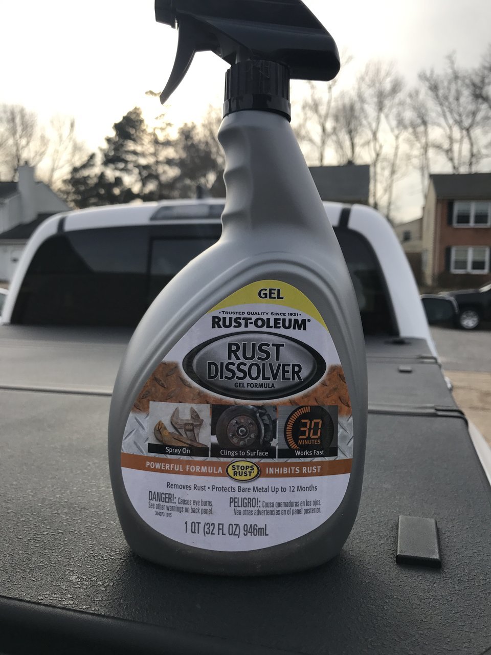

    Good ol Home Depot, but I was looking for Corroseal, but they didn't have it in stock so I took a gamble on this...only 10 bucks vs Corroseal was double the price for 1/2 gallon. IMG_0071.jpg
    20min of dissolving and rinsed thourughly. (No need for a wire brush) IMG_0074.jpg

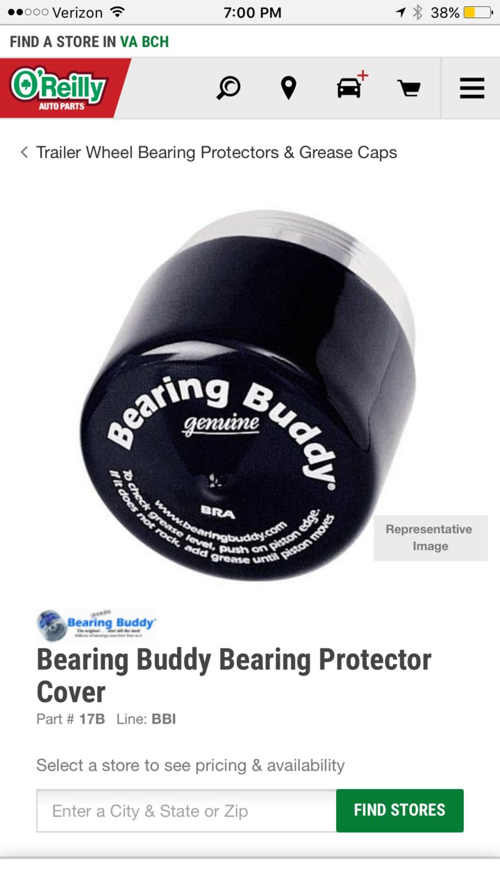

    The part is #17b for those who wanna cover your Resi so rust doesn't build up. I just ordered mine. Saw this on other forums to fix the problem.

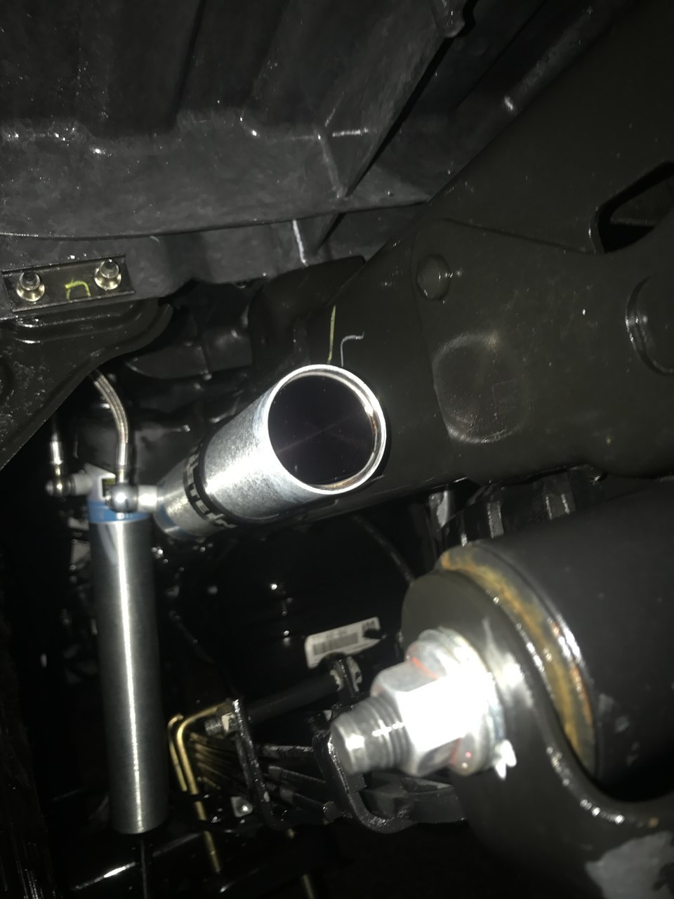

    Before
    After: a little bit better but it's cold as hell outside and didn't let it sit as long. Directions says results are better if it's 70 and above and should let it dry. It's 34F lolIMG_0083.jpg
