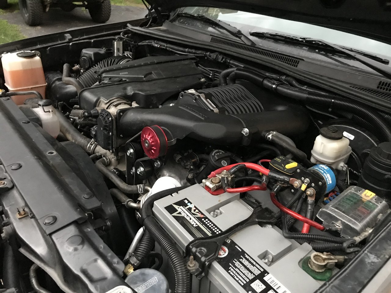

    Slightly heavy with front plate bumper w/ full hoops, 12k winch, dual batteries in engine bay and 1/4” reinforced skids.
    And yes, the 6112/700# combo work very well.

    Yeah my 75 pound battery cost me about a hundred bucks. How much was your 75 pounder?
