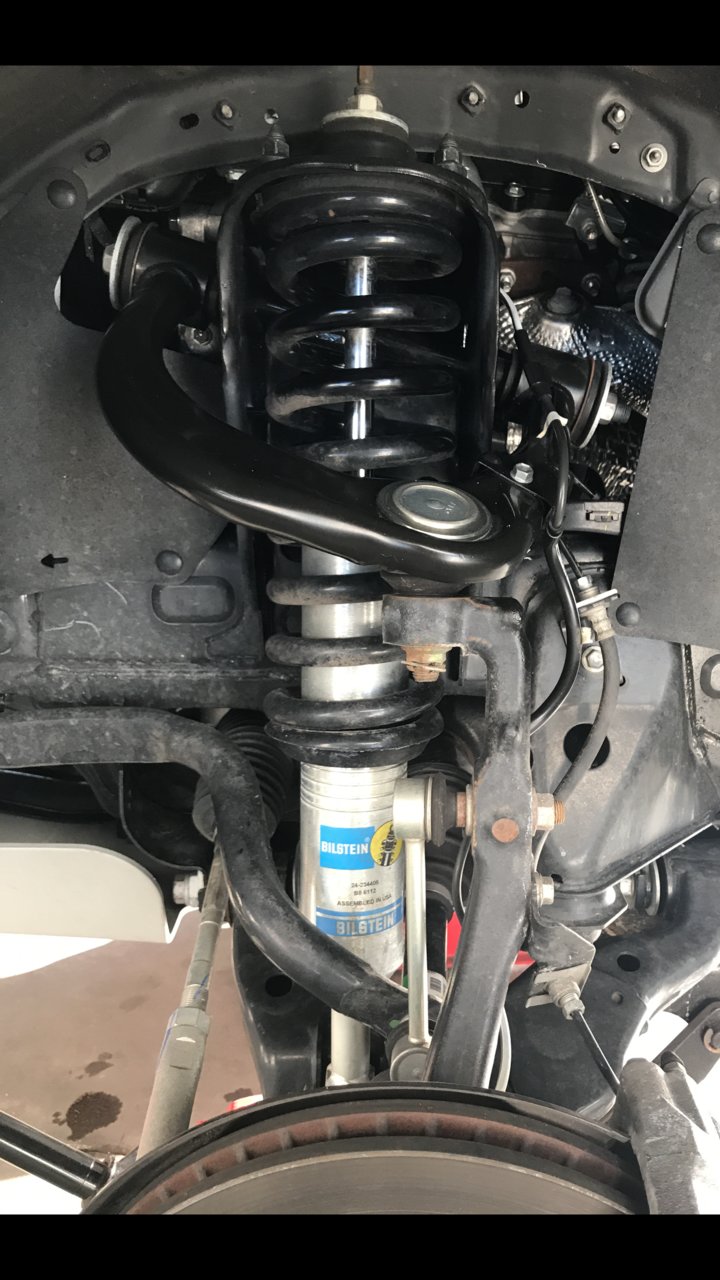

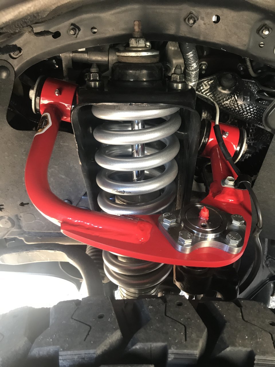

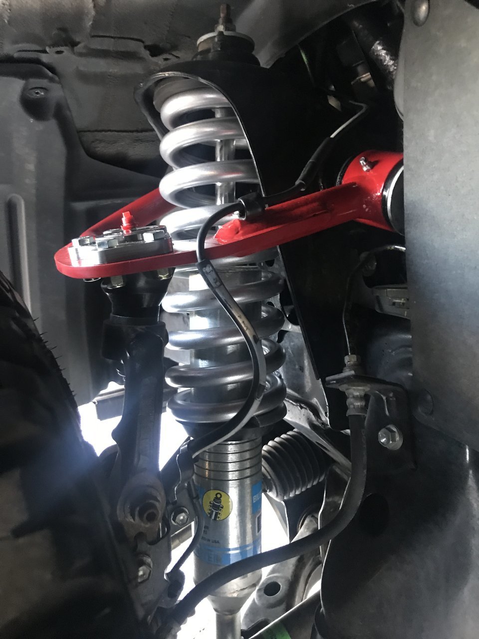

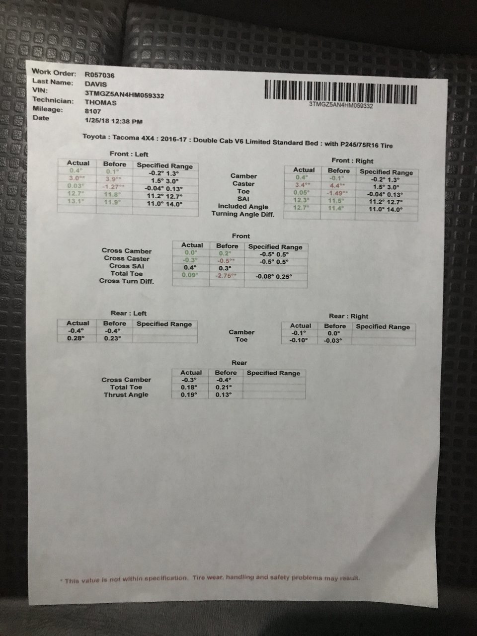

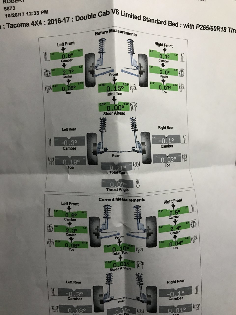

    I just added the 650lb Eibach spring, jba UCAs, and 6/5 setting. 38.25" in the front from ground to fender and pretty much leveled the truck some how...hope the front settles down a bit. No side shots sorry it got to dark outside for a pic. Will update later with a pic.
    **Headstrong 3leaf prog AAL in the rear with overload out on 5160s. On 255/85r16 ST Maxx
    Before: 5/4 setting 37" ground to fender driver and 37.25" on the passenger
    After
    Original alignment sheet from the 5/4 setup
    Current Alignment sheet
    I drove 105 miles back home and I will say it's a far more superior ride than the 610 spring it comes with. I'm coming from an SSO slim line bumper, skid plate, and bamf grill though so my opinion will differ from others as far as weight. Stiffened up the ride where it needed to be compared to my previous setup.
    My suggestion is if you have a lot of weight up front I'd get a 650lb spring otherwise it will drop your front about 1/4" and if you had a winch probably 1/2" or more. Another suggestion is get an aftermarket UCA or make sure you get an alignment every month or so from firestone.
    MY original alignment sheet and my current alignment sheet was 4K miles apart from each other. Huge difference....MPG on the way to the shop was piss poor I forgot to calculate it but I was just above half tank...for a 105 mile trip. On the way back home I didn't even reach 3/4 tank I was way above that marking. I calculated 20mpg. That's me going 65mph 90% of the time and passing people when needed and dealing with hills
    As a note for mpg I was running 34psi all the way around. I think if did 32psi in the rear it could have been better imo. Also went to discount tire days before install to get tires balanced and rotated cuz they do it for free!!
    Will update with pics later!
