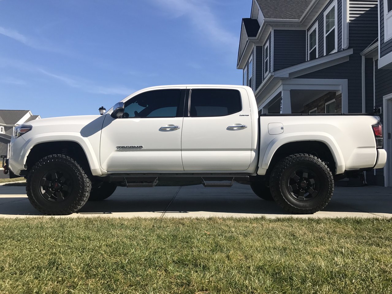

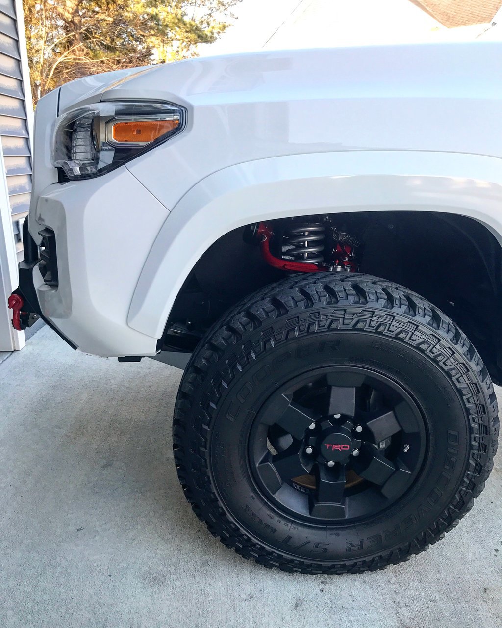

  20. Feb 10, 2018 at 4:11 PM
    #1080
    oscolivar1
    oscolivar1 Well-Known Member
    Oct 30, 2013
    #115568
    2,267
    Oliver
    VA
    2017 Tacoma Limited
    Bilstein 8112/8100, JBA UCAs, Icon RXT leaf pack, work wheels 17x8.5;-10os, 285/75/17 cooper LTX AT3, Mobtown HC rear bumper and Sliders, SSO front bumper, BAMF greceased grill.
    Forgot to give update with pics on 6/5 clip with 650 springs
    Here ya go
