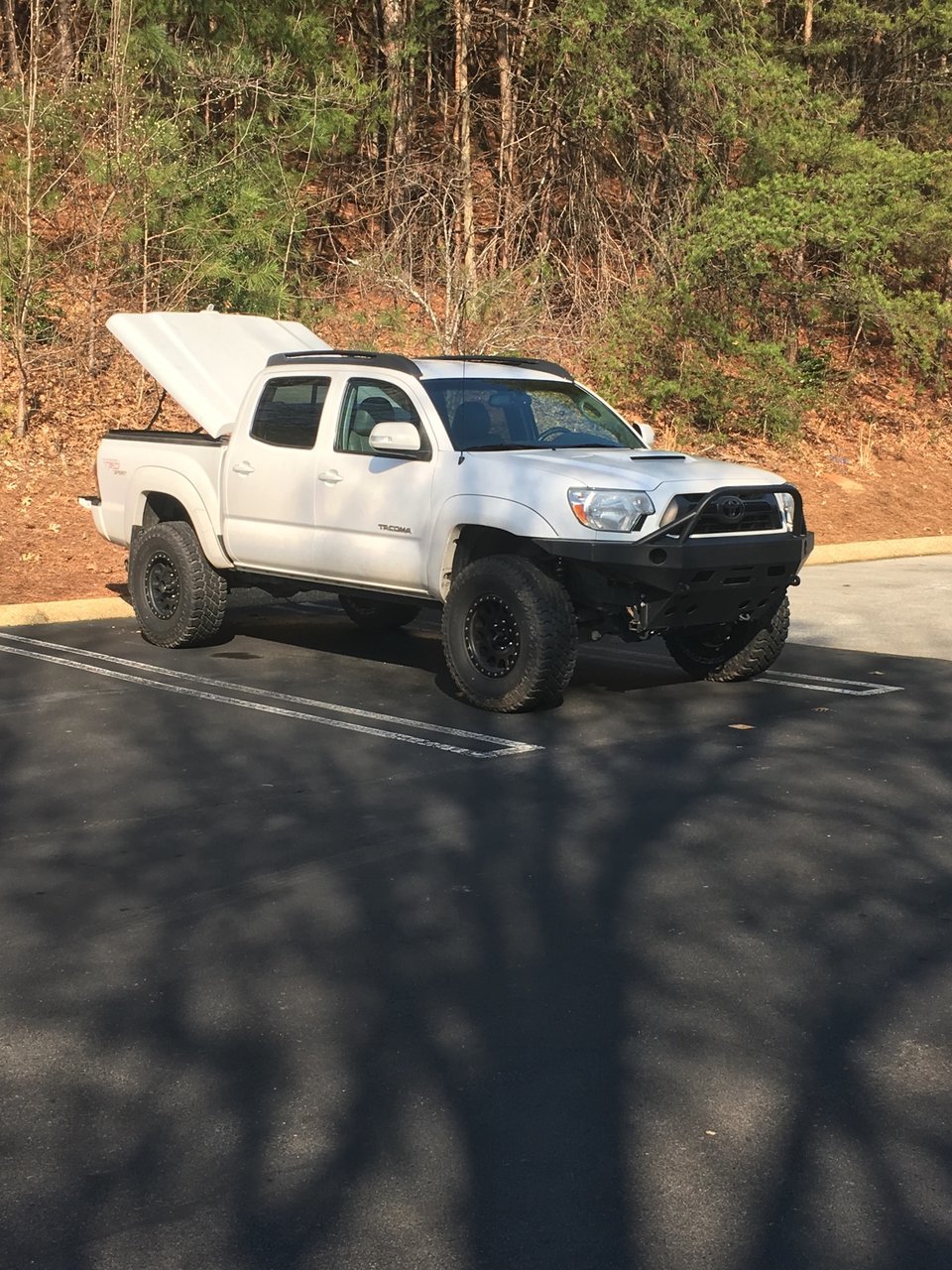

    17 OR 6MT
    a lot
    Thanks! After putting on the cap it looked different than adding the lift even more so.
    If you remove the overload that will take off 1/2 inch. My friend has 6112/5160 with a single AAL and he's happy with it.
    they'll all settle but it also depends if your current leaf pack is sagging already or not.
    my wheels are SCS Ray10s. thanks

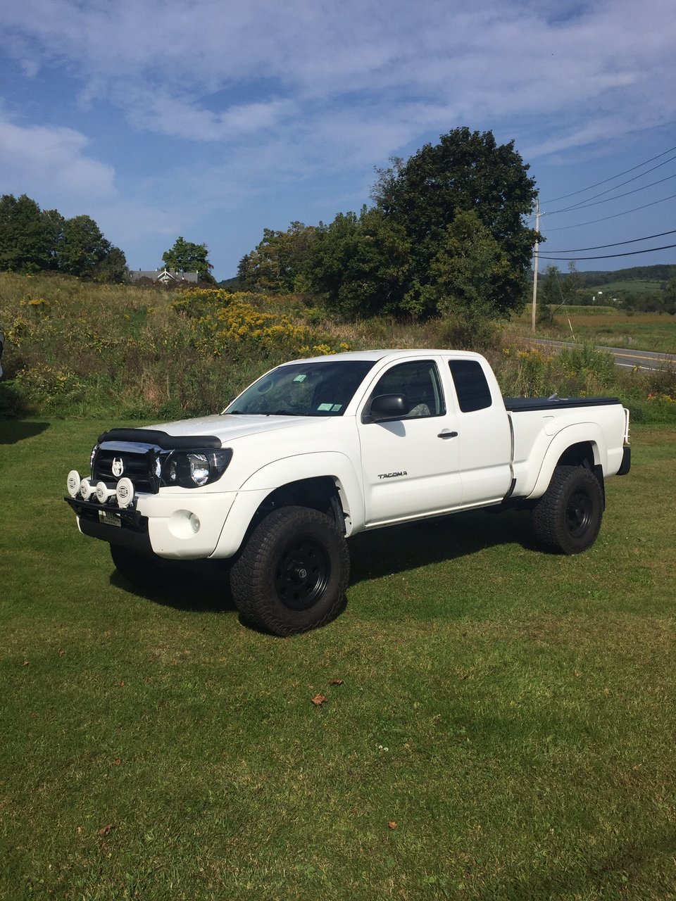

    I have the TSB leaf pack (4 leaf ) with a Wheelers 2" AAL and Bilstien 5125s and the ride is fine !My 6112s are at the top setting .

    Do u have any pics of your lift? Is that just a single leaf your running if so how’s the ride feel?

    Pictures in my profile .5125s are extended length . The AAL is one leaf . Just a little bit stiff in the rear . I went with 2" aal for pulling my camper and loading the bed with firewood and stuff .

    Are u rolling on 265/75/16 tires? Truck Looks good btw

    265/75 16 in the winter .285/70 17 in summer . Falken Wild peak AT3/W
