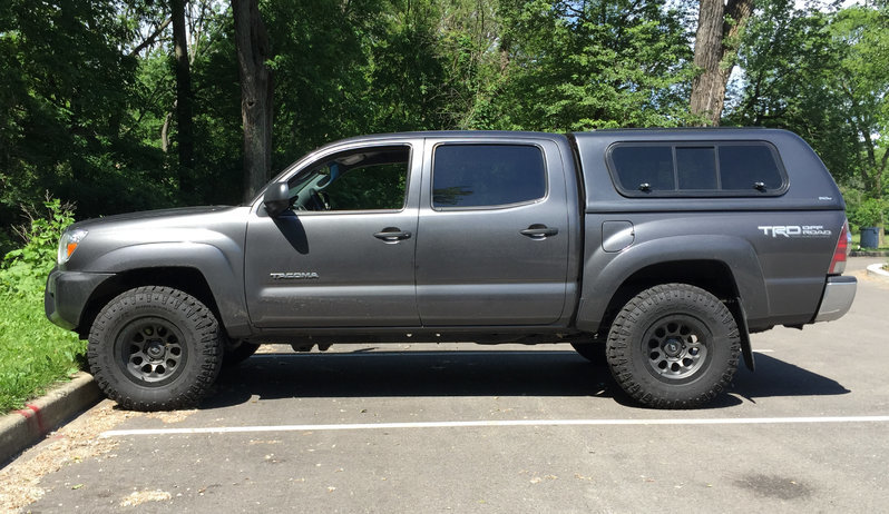

    Finally, happy to say I can give a post-installation report!
    For the most part, the install went exactly as expected. I followed the numerous videos and tips posted throughout this site and used the "no spring compressor" method and let the tuck and lower control arm do the work for me. I didn't have any issues with disassembly, and didn't have any issues with re-compressing the new coilover with the weight of the vehicle. The total install time was around 5-6 hours, but this was my first time and I went slow and meticulous. On re-assembly every single bolt was re-torqued to spec, then marked so that I can keep track if any bolt tries to back out. Can I also take time to say F^#K that damn swaybar!!! That thing gave me so much trouble trying to re-bolt it to the frame that I almost left the booger off. Also in reference to the cam bolts, 2 of the 4 required slight re-adjustment, but I did re-torque them at full droop, not sitting on the ground. Truck has no issues with pull or incorrect tracking right now.
    So with all of that said, I assembled the 6112's on the #3 (middle) notch hoping for 2" of lift. When everything was said and done, the first time the truck was lowered to tires on the ground I had an insane 4" of lift in the front. One loop through the yard settled it down to 3" of lift. I did a +2 mile loop around the block and it's dropped down to about 2.5" of lift right now, very similar to @HB Taco .
    Stock Measurements: 20" Hub to Fender / 35" Ground to Fender
    Post Measurements: 22.5" Hub to Fender / 37.5" Ground to Fender (#3 setting with 3/8" driver side spacer)
    Rear Measurements: 21.5" Hub to Fender / 36.5" Ground to Fender
    The following photos are right before and immediately after installation. I am nose high, but knew I would be until I take care of the rear suspension. If the suspension settles down into the 1.75" to 2" range as so many other guys have reported, it'll look even better in a couple days.
    BEFORE:
    AFTER: Measured at approx. 2.5" of lift. Expect this to settle within the next few days.
    As for the ride... LOVE it. I've only put about 4 miles on it to give it a test drive, but the ride seems to be as smooth as silk. I'm coming from stock TRD-OR suspension that had 12,000 miles on it. So far my wife nor I don't notice any uncomfortable stiffness, everything is an improvement across the board. Big bumps are MUCH smoother, small bumps are felt a little less in the seat. My only real performance test was hitting a really rough railroad crossing near the house. In every vehicle I've driven, if you crossed it over about 10MPH it'd rattle your teeth out. With the 6112's I was able to cross the tracks at 35MPH and didn't even feel them. Smooth as butter. It surprised the hell out of my wife and I.
    I'll report back in a couple of days when I'm able to hit the apartment complex's speed bumps a few times and see how it really compares to the old suspension. But so far I'm very happy and it is a noticeable improvement over the stock TRD-OR suspension.

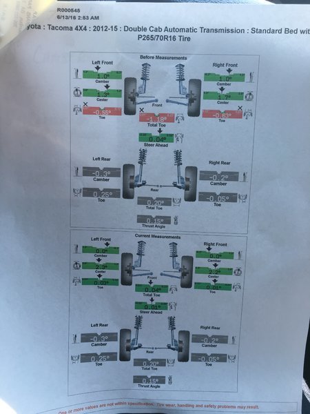

    Plan to get it aligned tomorrow.
    I need to ask for 0 camber, 0 toe, and as much caster as they can muster out of the UCA's correct?

    Last alignment which was about the same lift (2.3") I got 1.9 caster (stock UCA's). I wouldn't want much less caster than that. It still tracks good and straight and is in spec. I don't want more lift than that for that and other reasons. Later if you upgrade the UCA's you could go a little more.

    Alignment results are in:

    West Central Florida Coast
    •TRD OR Tacoma•
    That's excellent. What shop did you use?
