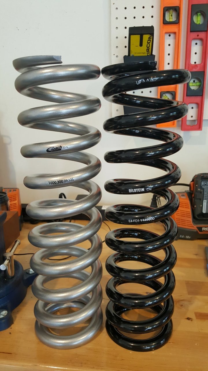

    Look into Eibach springs. rumor has it they are the private label manufacturer
    https://eibach.com/us/c-38.3-ers-coilover-spring-silver.html
    I have the 6112 on my Tundra with the 1600.300.0800S Eibach - 800lb springs.
    Here is a comparison vs the spring that came with the Bilsteins for DC Tundra 4WD:
