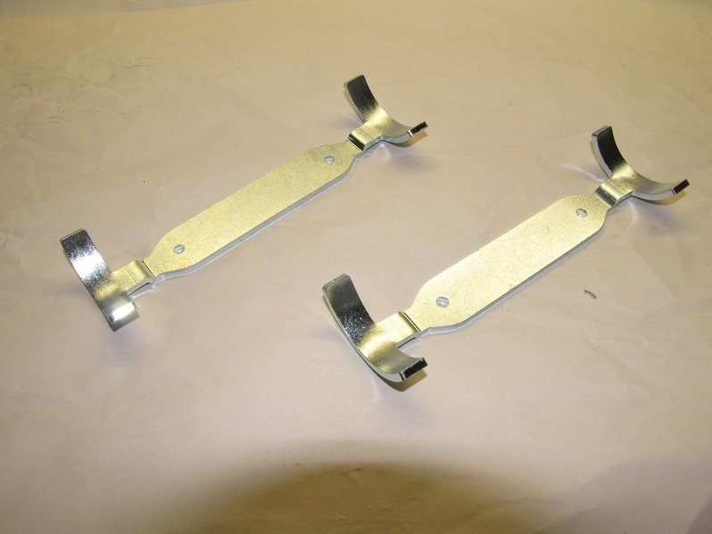

    5.29 gears 6112/5160 w/Dakar Hvy SPC UCA's 255/80/17 Wildpeak AT3 Nitro
    Lots of guys running the 6112's at top settings without UCA's. Chatted with Rogue Offroad, Headstrong and a few local shops. If you have the $$ great, but I'm told its not necessary for 2", especially if the truck is primarily an on road vehicle.
    I"ll know first hand in the next couple days, as the UPS man brought my setup from Headstrong (Heavy Dakar's not in pic).
