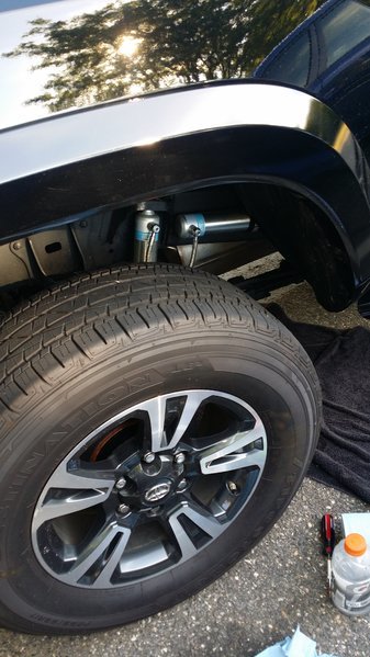

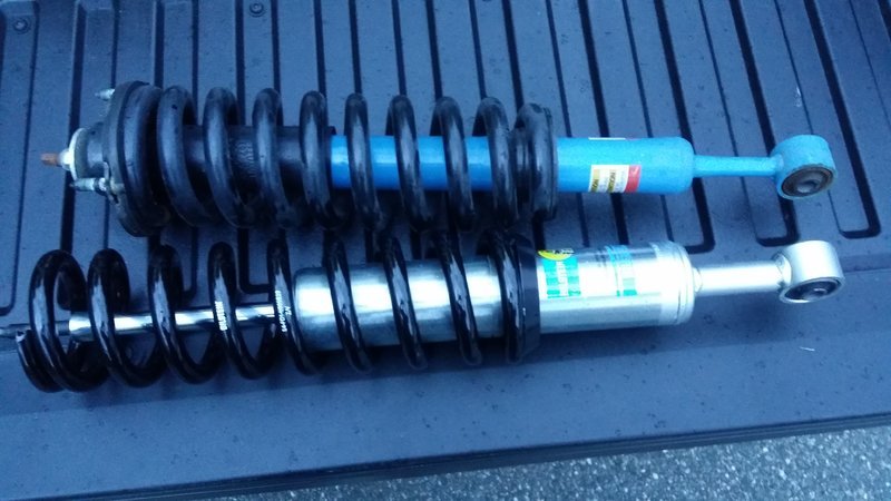

    Just finished the 5160 ext travel on my 16 trd sport ac and what a difference! Hated the way my truck rode stock. Front 6112 was first since i figured it would be most noticable and i did those 2000 miles ago at 7500. Installed on bottom setting mostly for comfort at first with plans to move up when i do uca.
    Completely changed the feel of the truck, soaks up bumps incredibly well, feels like they were engineered to work together (they were). The stock sport spring and hitachi shocks felt like a hacked civic suspension. Big heavy springs on cheap shocks left for a bouncy ride. I do notice truck has a hair more lean than before in corners. May be partially due to sway bar bracket which was unnecessary but installed just because i bought it.
    Now the rear shocks i just finished an hour ago surprisingly feel perfectly matched to the front. Im surprised because again, the rear felt springy and quite bouncy unloaded and was doubtful for same results as the front with the same stock spring packs.
    Overall lift is negligable, didnt even do an alignment or adjust headlights because i think the front was up maybe .75" and doing the rears looks like it returned a bit of rake.
    Im new here and new to lifted trucks but many years of being a sports car nut, autocross enthusiast, and general gearhead taught me the requirements of strut/spring combo are less complicated than many people think. Why wouldnt these work on a 3rd gen? Weight is similar which is most important change there could have been. Most other parts are the same (suspension parts and mounts). Maybe they will develop a random symptom at a random speed like so much else on a 3rd gen(sarcasm) but i seriously doubt it
    -B

    So for the rear, the only thing you added was the 5160's and that took care of the harsh bouncyness of the stock ride quality?
    I'm in the same situation you were in. I've got the 6112's installed in the front which are super smooth, and nothing changed in the rear as of yet. If I can swap out the stock rear struts for the 5160's and that dampen up the rear suspension so that it feels as plush as the 6112's then I'll be doing that ASAP.

    The only thing i did was the rear 5160. Im almost hesitant of the next stage i was planning which was icon aal and spc uca and moving to middle setting on 6112 because it is so smooth.
    Highly recommend grabbing the 5160 and tossing them on. Actually pretty easy job done at home too with very basic tools. 17mm lower shock bolt and 14mm upper nut, vice grips and that was about it.
