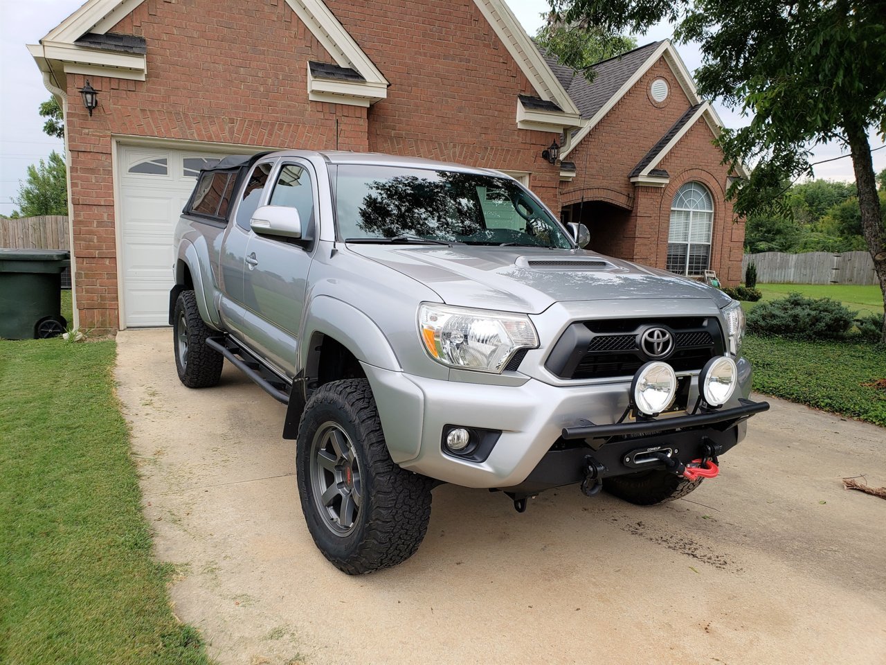

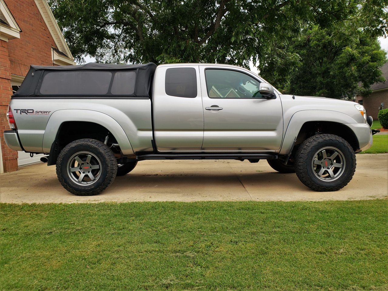

    Finished installing a 6112/5160/Dakar lift on 22 Jul18.
    Up front I installed 6112s with TRD (PTR13-35120) 650 lb coils, a ¼” spacer on the driver’s side, and SPC LR UCAs . The 6112s were set to the 4th position and the LR UCAs were set to the neutral (+2 degree) position. Went with the 650 lb coils due to added weight (~300 lbs) up front; US OffRoad Hidden Winch Bumper, ComeUp DV-9s winch, IFS skid plate and rock sliders from SOS Concepts.
    In the rear I added OME EL096R leafs. Not currently carrying any significant added weight in the back but looking to doing some long term traveling with a small travel trailer (Casita) in the near future.
    Initial measurements before adding the extra weight and the lift were:
    (Center hub to bottom of fender flair)
    LF: 20.0”, RF: 20.0”
    LR: 21.0”, RR: 21.0”
    Initial measurements after added weight and lift showed an increase of about 3.75” to 4.0” front and rear.
    after an alignment (3.25 degrees caster, 0 degrees camber and 0 degrees toe) and 10 days later the front has settled down to 2.5” and the rear has not really settled much; 3.75”.
    LF: 22.5”, RF: 22.5”
    LR: 24.75”, RR: 24.75
    I haven’t noticed any vibrations at all and the truck actually drives better than it did before. Overall very pleased with the outcome.
    dzking, Tainted, Sotelofam805 and 6 others like this.
