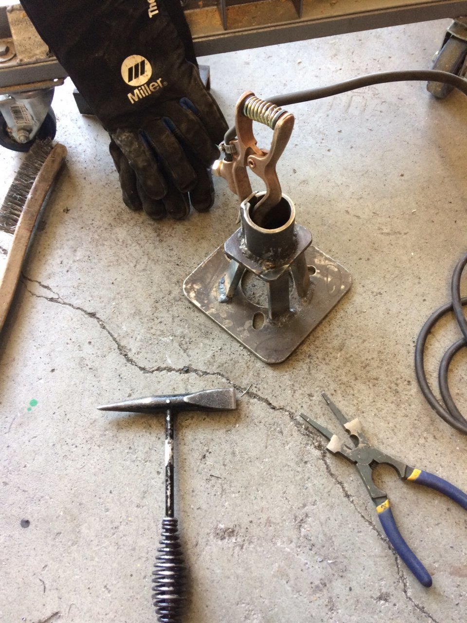

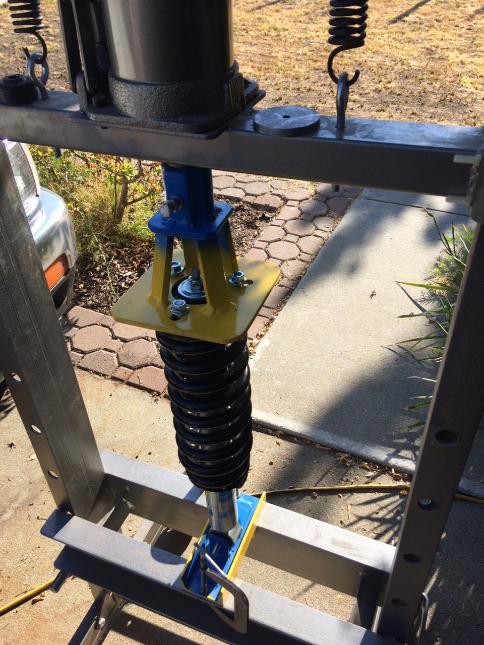

    IMG_3386.jpg I ordered 5160 for the rear and still waiting for the 6112's to arrive. In the meantime I fabbed up a spring compressor for my hydraulic press. I assembled my friends 5100's on it. Its easy on the coils and relatively safe to use. Much better than my oem screw compressor..Can't wait for the 6112's to get her so I can get them ready to install.IMG_3393.jpg
