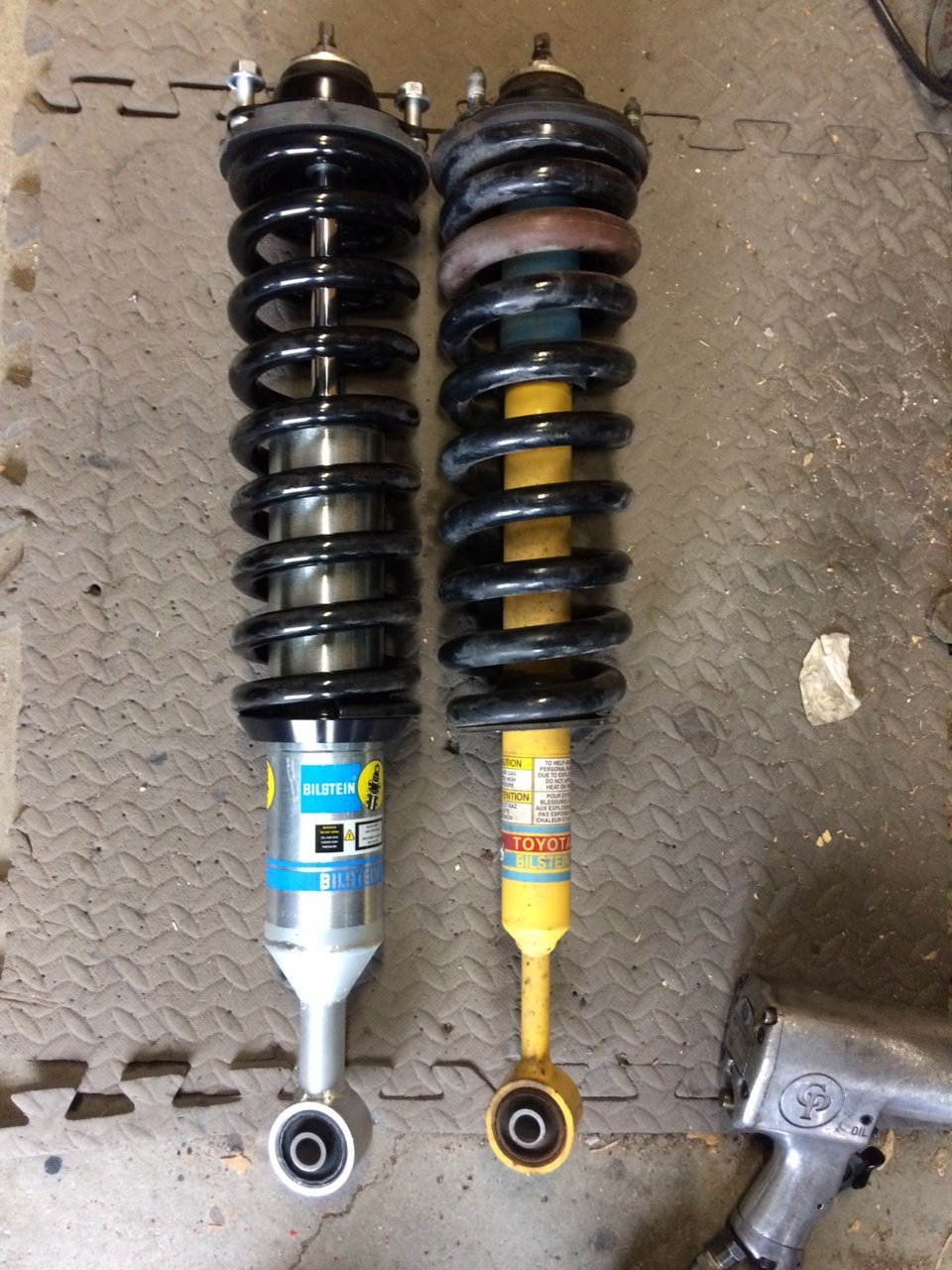

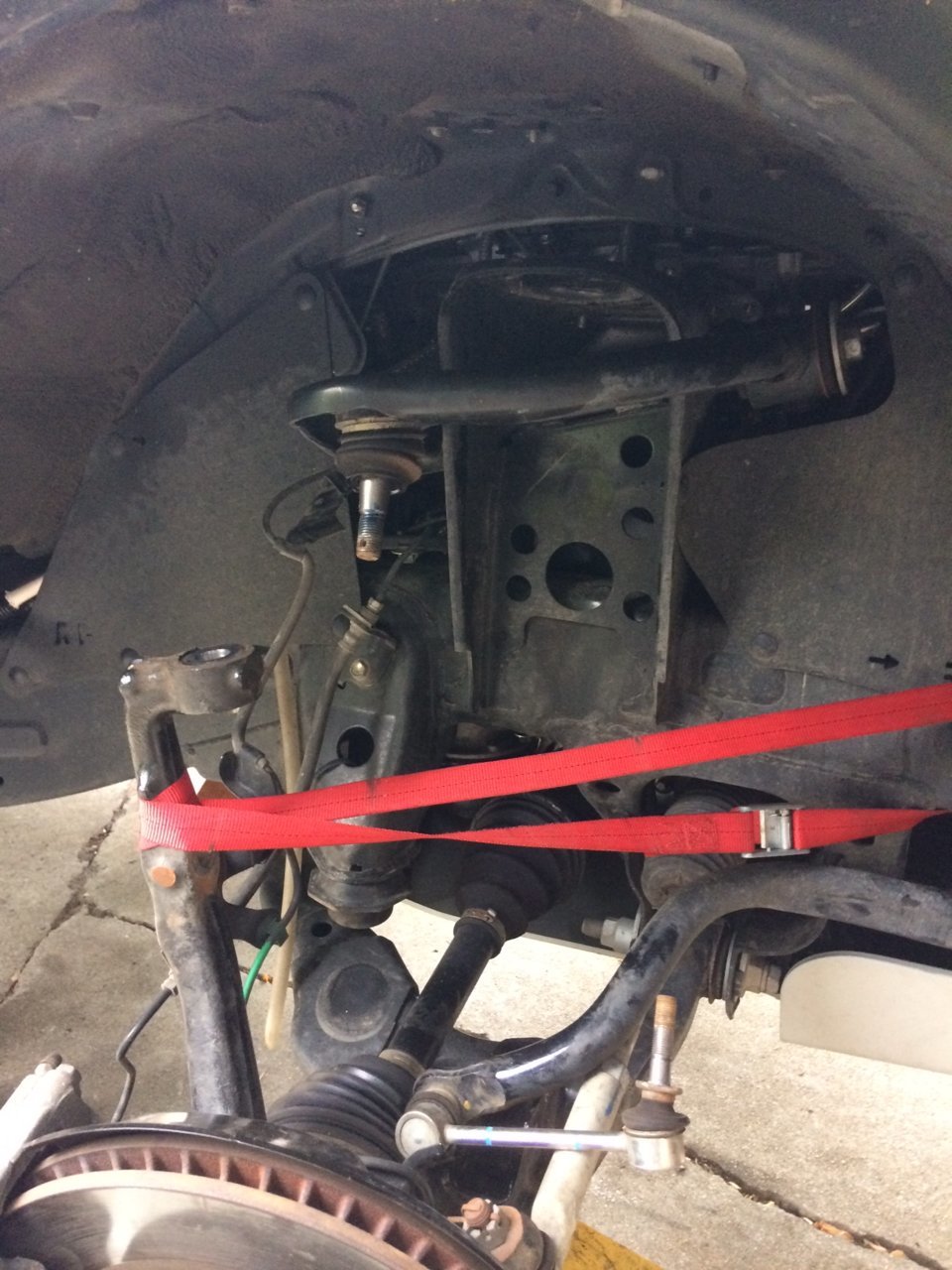

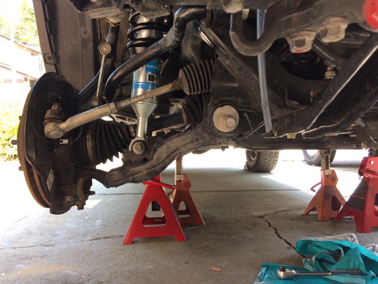

    Did the bushing and finally got the 6112's in and 5160's in the back. The passenger side took half hour to do but the driver involved doing the bushing which took longer..
    Removing the skid plate and disconnecting the sway bar was a must for removing the cv
    shaft. Everything came out great. I went with 2/3 for .50" over stock height, and after it settled was half inch higher which was what I was looking for. The ride was obviously better in every way over the skinny stock Bilsteins. Smooth yet firm, soaks up speed bumps noticeably better by a lot. This is a major improvement over the stock crappy setup it came with. Alignment this Friday. Update, went and got Firestones lifetime alignment which btw can also be done at Wheel works and Tires Plus too. The alignment was off as expected but I'm sure some of that was already off spec before I even did the coil over work. Drives much better than before. Going back in six months and I'll give them my specs next time..

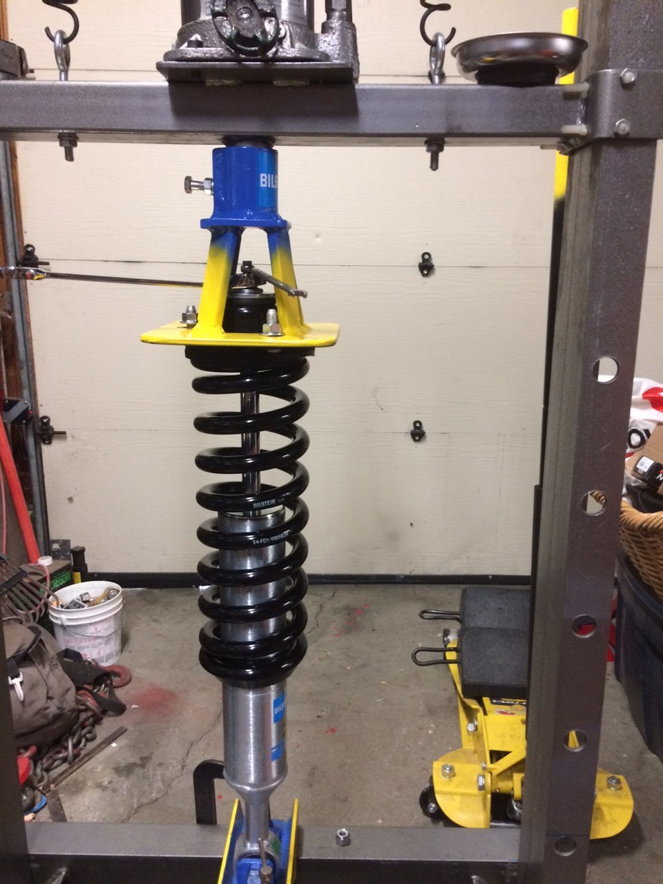

    Where did you get the press adapters for compressing the spring? Did you make them?
    09 Redneck and DrFunker like this.
  11. Aug 16, 2018 at 11:45 AM
    #1451
    Two Hawks
    Two Hawks Well-Known Member
    Apr 9, 2016
    #183729
    152
    Morgan Hill, Ca.
    2016 Tacoma TRD OR 4X4 A-Cab
    Ham radio antenna,Firestone Ride-Rite air spring Snug Top topper, and a rifle rack y'all ..Moroso Catch Can, De-badged.
    I didn't like the one I bought so I made this to fit my 20 ton press. I'm very pleased in how it works. I had to wait for my 6112's to arrive from being back ordered so I had time to fab the spring compressor. I've done five sets of coil overs so far and it works great. Based on the same principle of how the vehicles presses on them so it's safe to use and is much easier on the coil.
