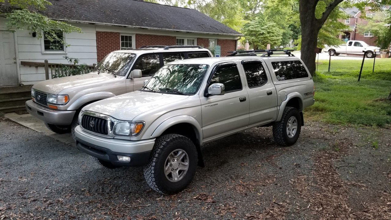

    6112 set at 8/7 (1.8"-1.7")
    OME full pack (Medium) on back
    1st Gen
