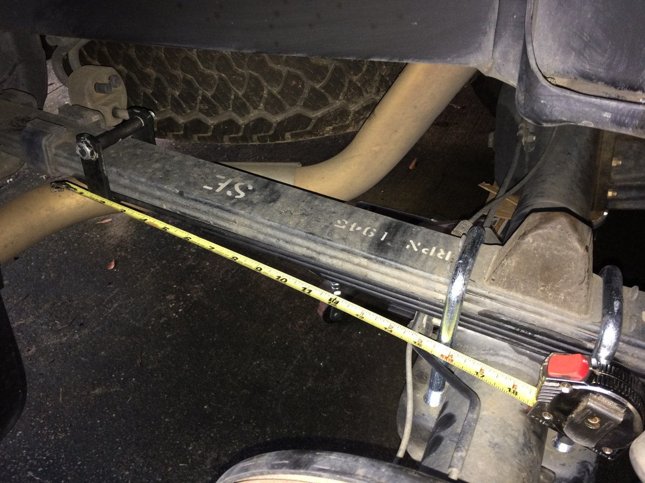

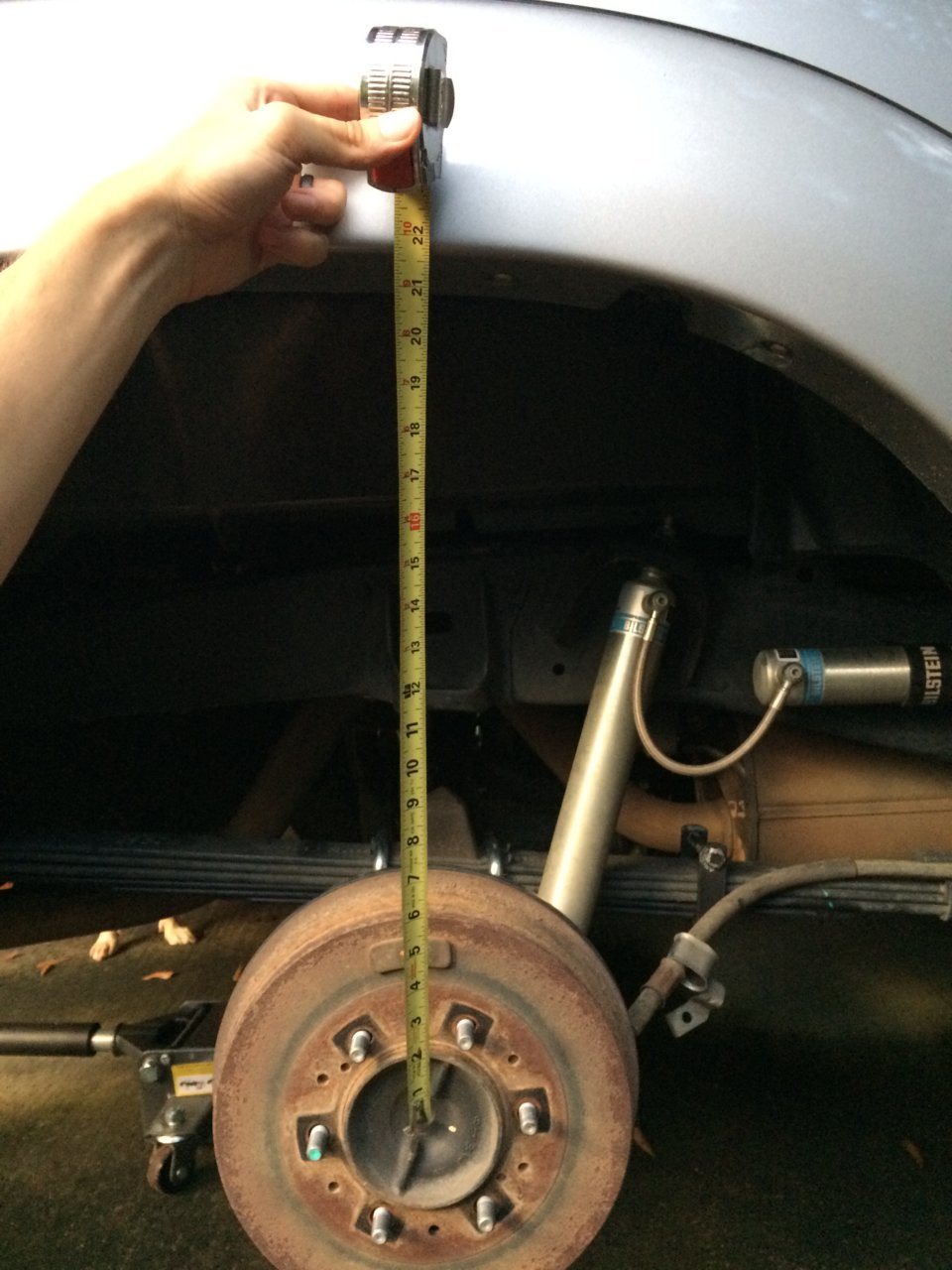

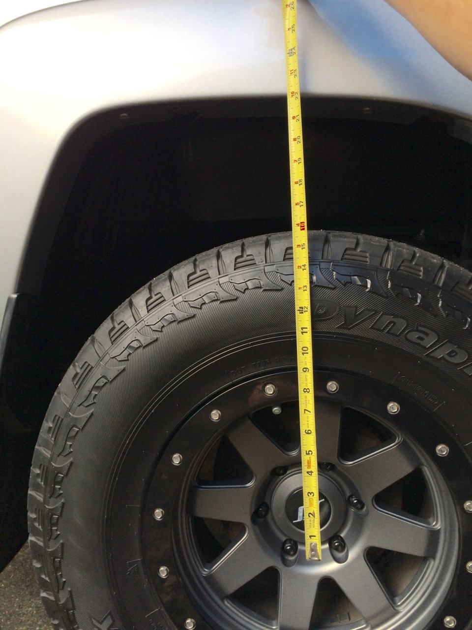

    This has before and after measurements from when I swapped leafs. The stock ones were shot from the weight of the ARE cap. Hope it helps a bit with measurements.

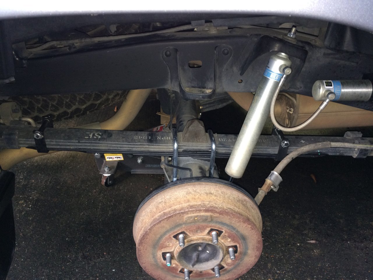

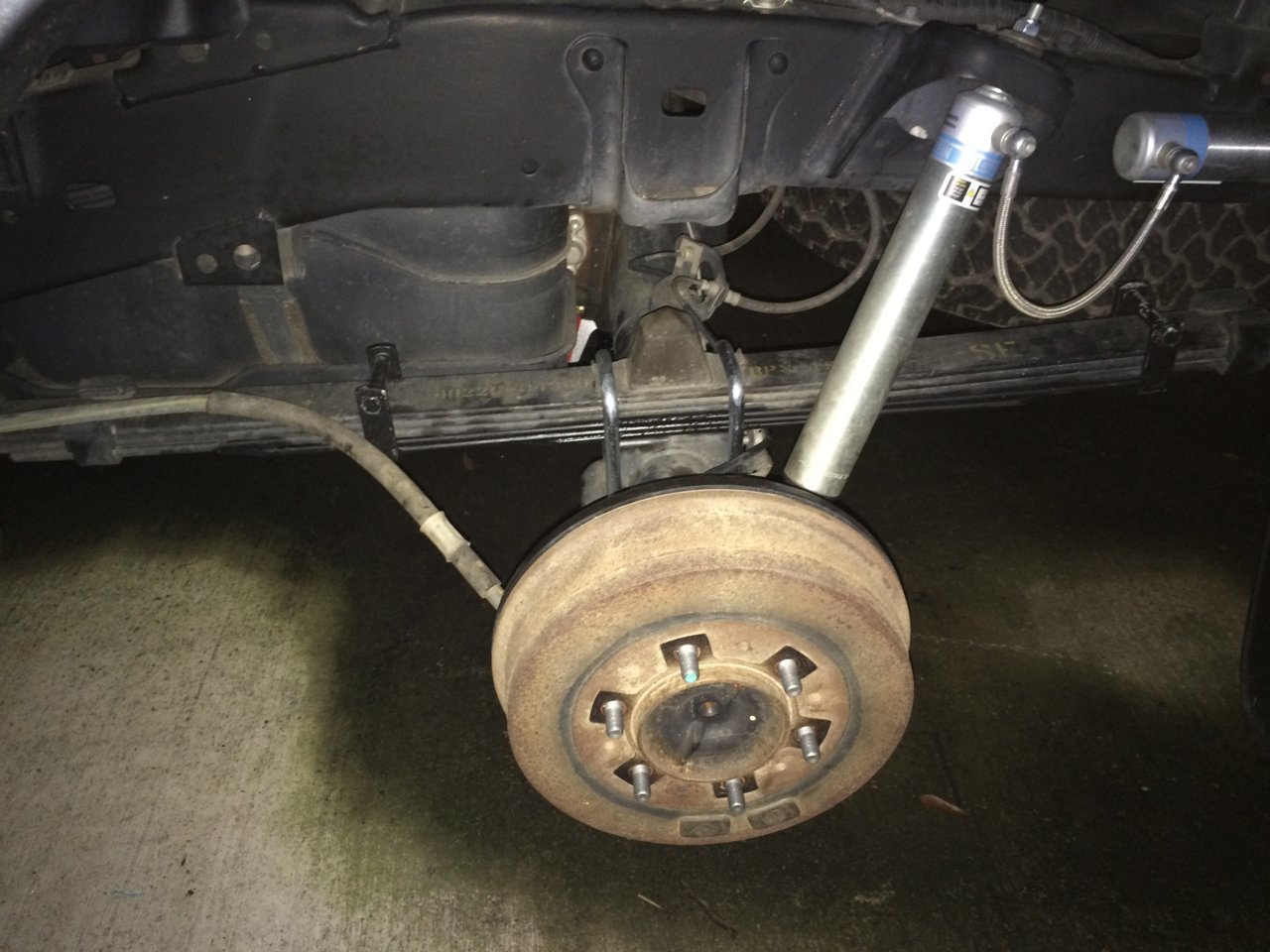

    You bet. These are the same photos I sent to Icon.
    Any thoughts?

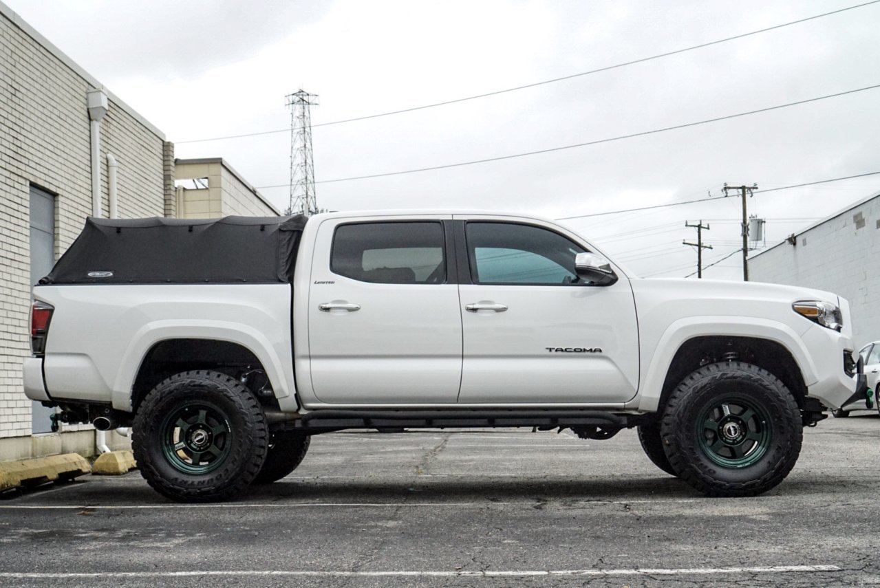

    Havent done a hub to fender but last time I checked I was 39.5-39.75” from ground to fender in a 33” tire.
    I have about 200lbs or so In the bed, waterport, Hilift, and a bunch of gear and tools, sliders as well (pic below).
    When I had about 400+ lbs in the bed, it was at 39”
    No shims, no CB drops, no squeaks, no clanks, no ext fuel lines.

    Nothing's jumping out at me install looks fine.
