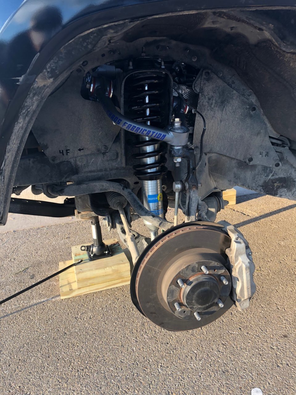

    Finally slapped the 6112s on! 5160s going on tomorrow.

    Welcome to the club. What are you running in the back? besides 5160's. Any rear lift?

    I'd hope so. He will have a tough time seeing over the hood on that setting. :D

    Ya i'm putting the dakar mediums on as well. Serious reverse rake happening right now haha

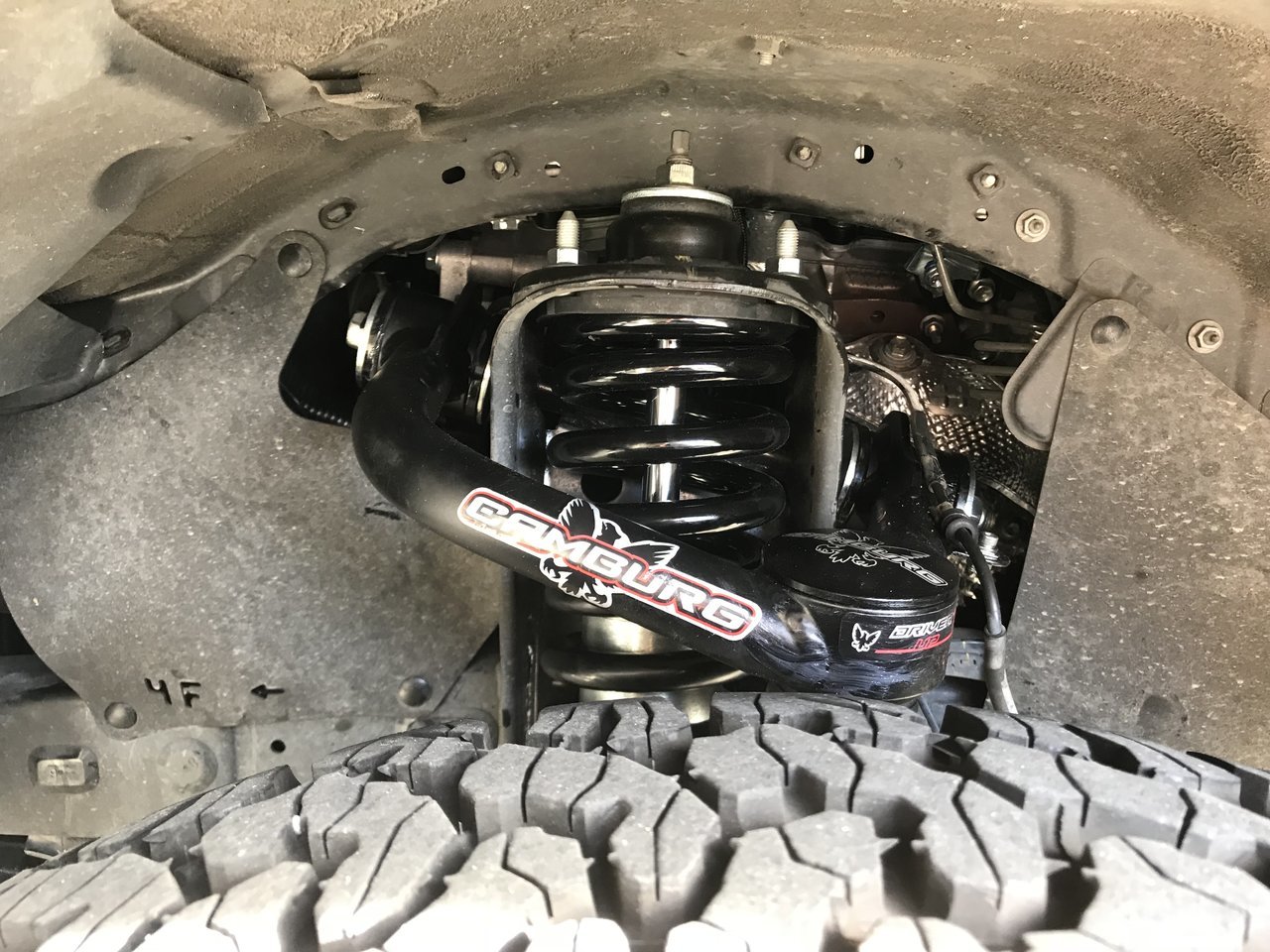

    How do you like this set up? I’m about to
    Get this exact set up. Any issues with anything? Bearing needle, uca alignment, rough ride? Thanks
