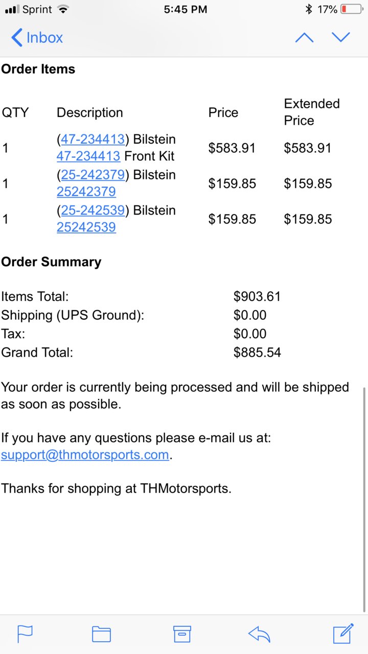

    If anyone is looking for a good deal on these I just purchased the set from thmotorsports 885 shipped. Took two days. There is a 3% off order coupon.

    I did the same. Came in last week. $885 all in is hard to beat. Now just need to find time to install along with the headstrong AAL
