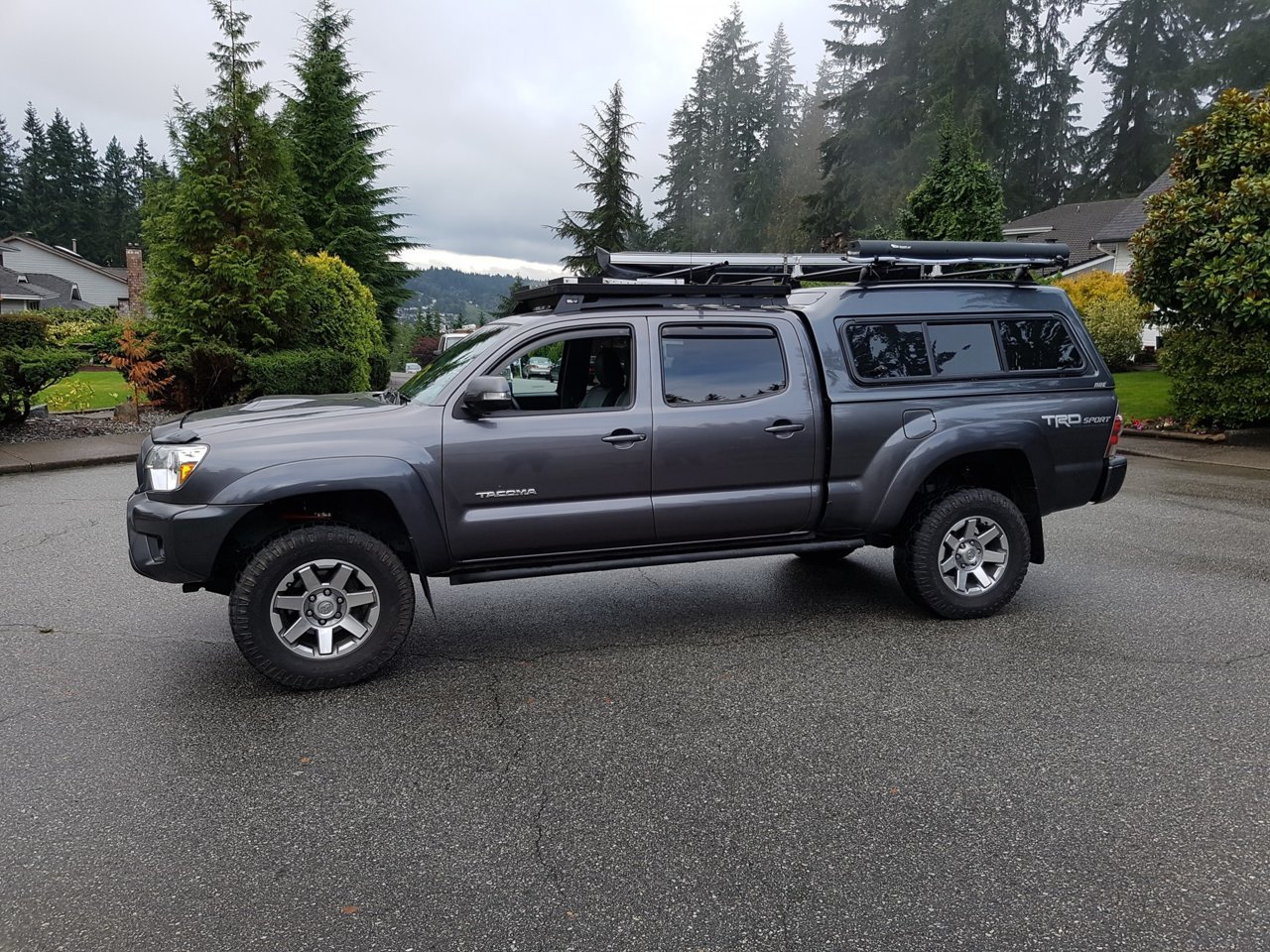

    Set the front at the 4th setting. Here is my truck finished with the HD Dakars, Bilstein B110 w/ Wheelers U-bolt Flip and SuperBumps (front and rear). I paired the 6112s with JBA UCAs
    I'm happy with the end result and rake. We'll see what my final lift measurement numbers end up being once its settled. It gave me around 2" in the front and 4" in the rear.

    That ass end will settle for sure.
    Great set up! :thumbsup:

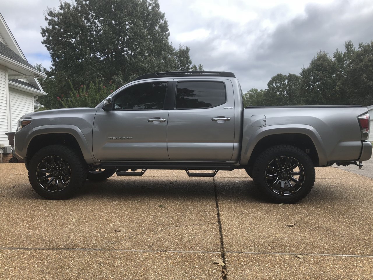

    C71FA43C-59C4-4348-9C78-24380382B557.jpg 07F8B9B9-135C-4F38-B112-CCCBA092E157.jpg Finally got my 6112s installed with Icon 3leaf progressive AAL. Trucks sits level with 5/6 notch on struts and AAL. Got 2” front and rear which was perfect for what I was hoping.
    Ride is much better than my stock limited( very soft) suspension. I had 4wheel parts install and align my truck with stock uca’s without a problem. Love the firmer feel, very planted to the road and much more noticeable in turns.
    Very happy with ride and how it turned out for any others out there wondering the same. Pics below, my driveway makes it look uneven but it’s totally level on flat surface. 7FAFC5AA-21D3-434F-8E48-E74F47DAA2DD.jpg

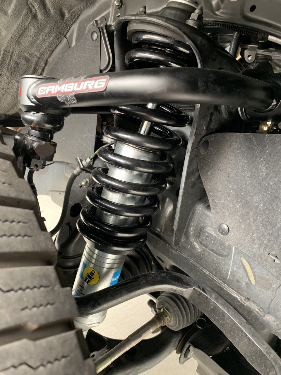

    Just got them installed last night. Top notch and it rides like a doll
