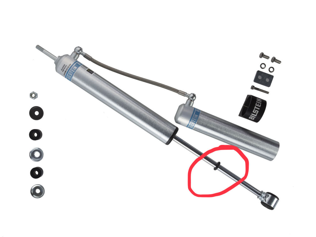

    On the 5160’s does anyone know that the purpose of the black o-ring on the shaft is for? Does it have to be placed at a certain spot?

    You can just push it all the way to the top then it will move down as you drive and compress the suspension. It is just a gauge for you to see how much of your travel you used like when you go off-roading, etc.
    At least that is my best guess but someone else can chime in if that’s not correct. Mine dried up and fell off after having them on for 6 months. :rofl:

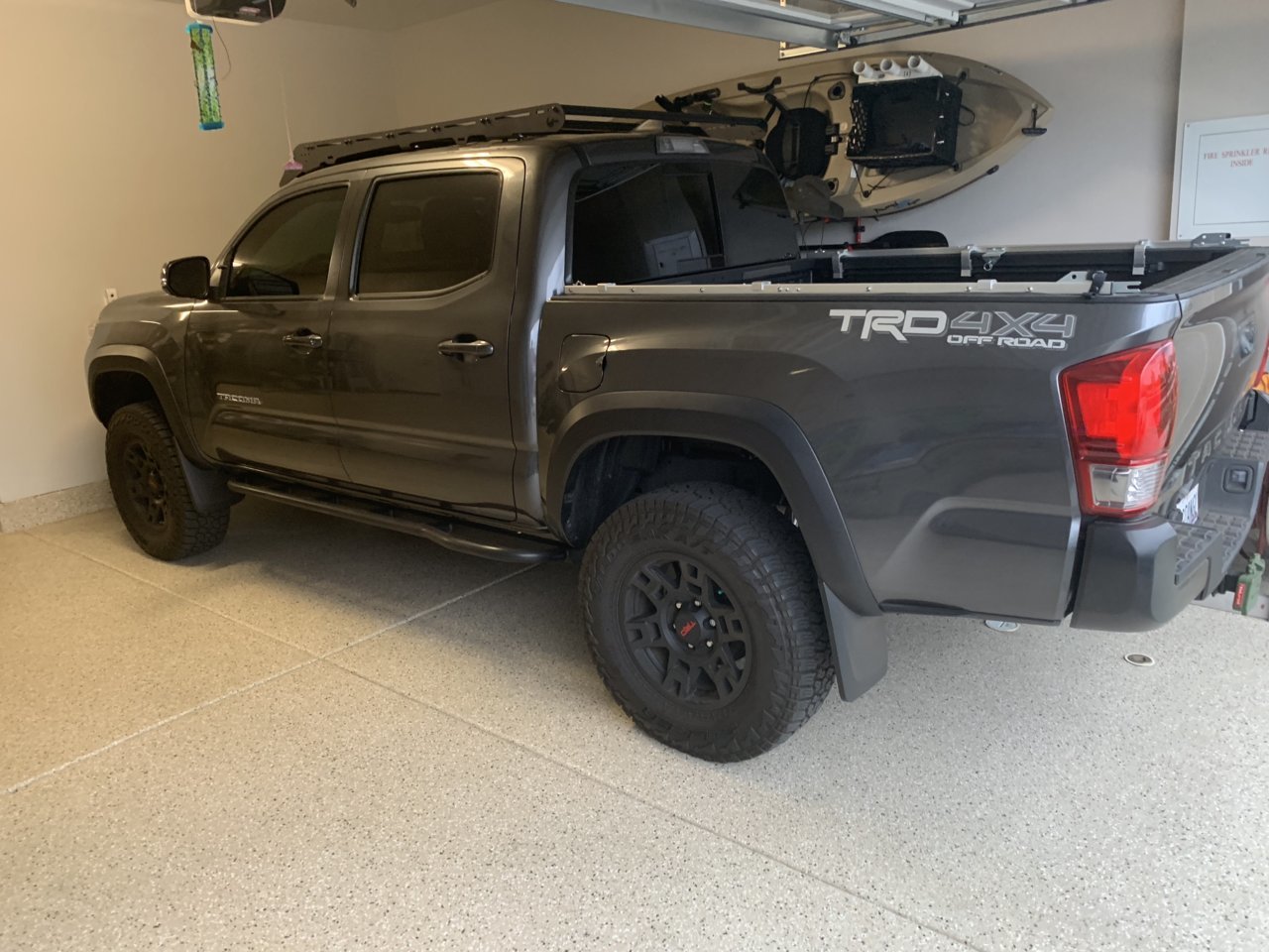

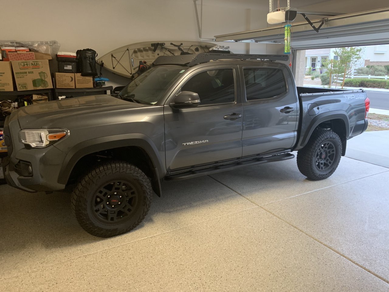

    I just took these in the garage I can take some more tomorrow. But it’s leveled. Shop recommend the overload out because the front will settle and I only really put a Belgian malinois in the back. I didn’t want the rake of a 70 nova. But I have them just in case I ever decide to put them back in. Rides waaaaaaay better then the stock TRD OR Suspension.

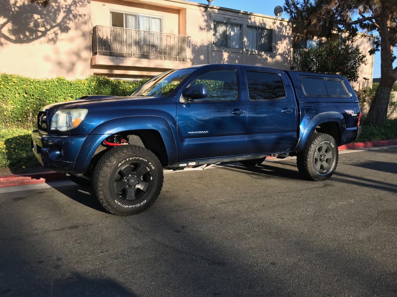

    I put 6112s on my 06 DC as well. Notch #3 gave a little over 2" of lift (versus 1.6" expected). On the back I put medium Dakars with the top overload removed. This also gave a little over 2" of lift so all told stayed level. We will see if either end settles.IMG_5185.jpg
