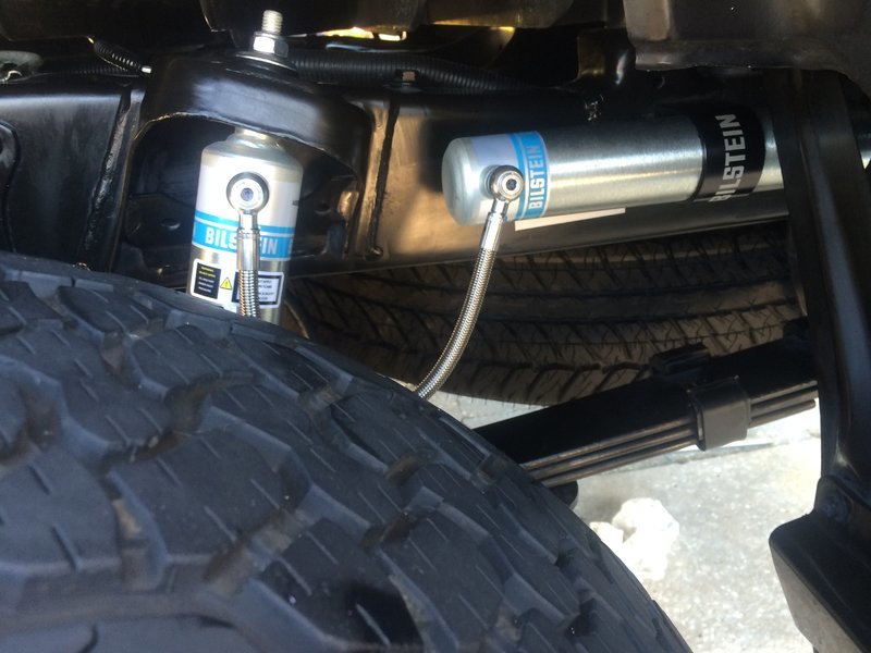

    image.jpg I decided to add a Icon 3leaf AAL so I had to change out my existing rear fox shocks and went with the 5160's witch will allow for the 1.5 lift. So far they're awesome. They work excellent with the 6112's and should have purchased them with the 6112. I still need to go back in and add the AAL.

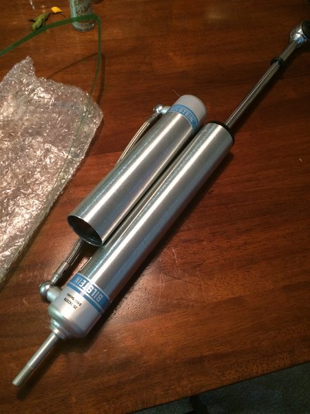

    I got mine in this week, but it will probably be next weekend before I can get them installed:
    By the way, these things are much nicer in person than they are in photos. It surprised me how big the reservoir was.

    Nice!! With some interruptions and it being about 100* out, and doing it by myself about -1.5hrs. The bottom shock mounts are tight, and getting your hand up inside the frame to start the resi mount bracket bolts is tedious. I used blue thread locker on all the resi bracket hardware. It went pretty smooth. :thumbsup:

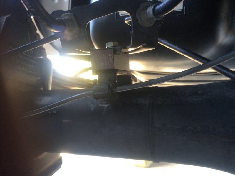

    I did the Drivers side first, and once I removed the existing shock I installed the new hard brake line clamp, and the brake line spacer. Also remember these shocks have different part#'s for left and right location.image.jpg
