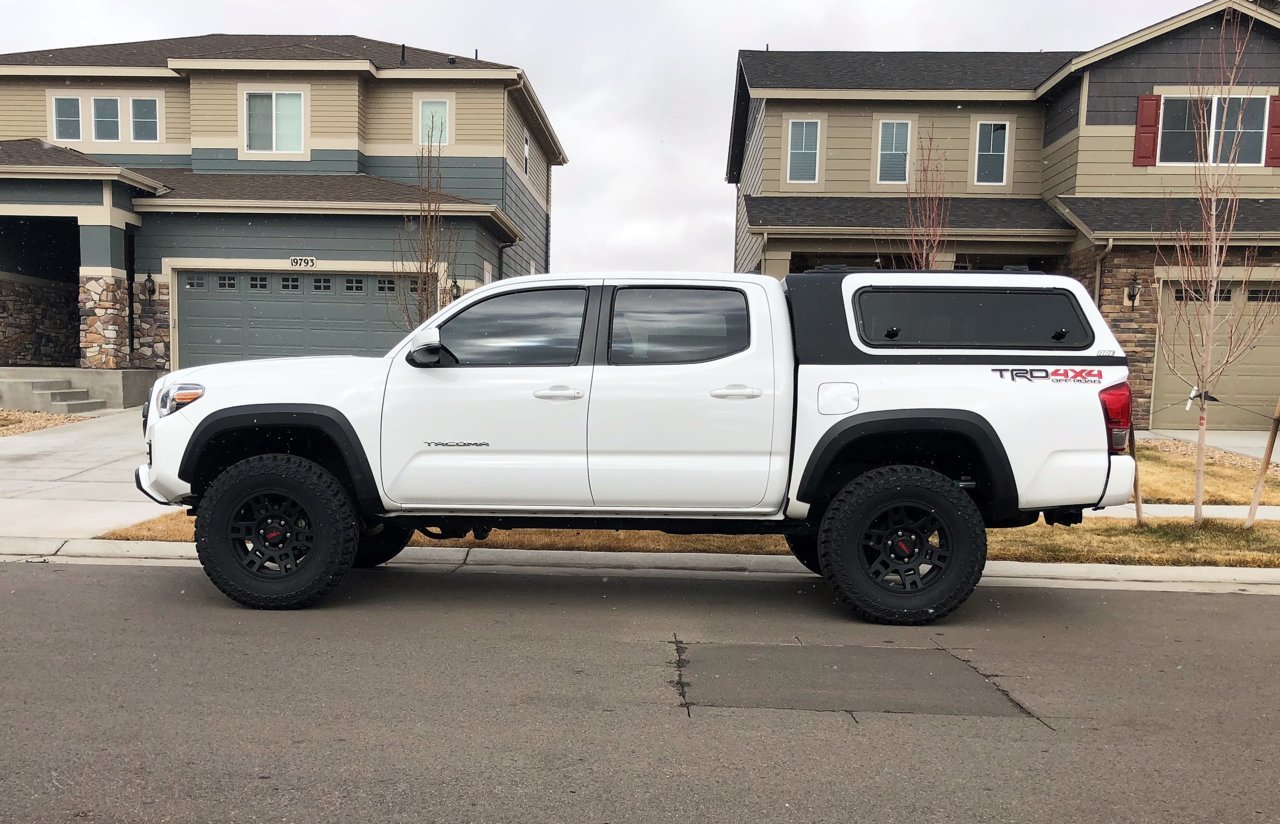

  14. Oct 27, 2018 at 8:14 AM
    #1634
    jholc21
    jholc21 Well-Known Member
    Sep 27, 2015
    #165286
    652
    Colorado
    2017 White Tacoma TRD OR
    Bilstein 6112/5160 w/Dakars Leafs 255/80/R17 Cooper ST MAXX Skinnies 4.88 Gears TRD Pro Fog Lights Cali Raised 5D Combo Leather Seats LED Bed Lighting ARE Overland Shell
    Here are Bilstein 6112 at 4/5 with Dakar Mediums leafs with 5160 in the rear with 255/80/17's around 1.5-1.7 inch lift after settling. I've not run them at 5/6 but some say they work well and some say the ride a bit stiff. Figure the canopy weighs at least 150 lbs plus a bedmat and some gear in the back.

  15. Oct 27, 2018 at 8:25 AM
    #1635
    Eddiwardo9
    Eddiwardo9 New Member
    May 9, 2018
    #253000
    3
    What control arms did you go with?
  16. Oct 27, 2018 at 8:27 AM
    #1636
    ejewels
    ejewels Well-Known Member
    Dec 13, 2017
    #238387
    1,669
    CT
    2018 MGM TRD OR 4x4 DCSB
    6112/5160/Dakars/Pro Tacoma Wheels
    Thanks man, looks good. How did it look without the topper and extra stuff? Also, im assuming since you have bigger tires the lift would look even bigger if you had stock wheels and tires?
  17. Oct 27, 2018 at 11:05 AM
    #1637
    jholc21
    Sep 27, 2015
    #165286
    652
    Colorado
    I like it - the rear feels more controlled and not stiff at all. Handles loads much better. I did the lift after I had the canopy on so it would probably be closer to 2 inches in the rear with dakar medium leafs. Here's a photo of the truck and lift with stock wheels/tires
