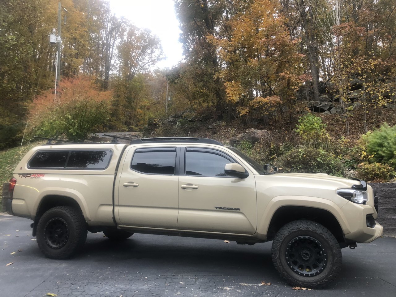

  19. Nov 1, 2018 at 7:12 PM
    #1679
    WV Outdoorsman
    WV Outdoorsman Well-Known Member
    Nov 20, 2016
    #202836
    256
    Lewis
    2017 Tacoma sport
    Awesome day I finally got my lift installed today. Very happy with it so far just drove it home on the interstate and all seems well with it. 6112’s set on the 5th notch, 5160’s and medium Dakar’s. Sorry I forgot to measure before lift this morning before dropping it off. Thanks to marie @HeadStrong Off-Road for all your help!!! I love it!!!
    primodude likes this.
  20. Nov 1, 2018 at 7:31 PM
    #1680
    ejewels
    ejewels Well-Known Member
    Dec 13, 2017
    #238387
    1,669
    CT
    2018 MGM TRD OR 4x4 DCSB
    6112/5160/Dakars/Pro Tacoma Wheels
    Looks great. 5/6 notch or 5/5 with spacer? Also assuming Dakars would be higher but you have some weight back there
