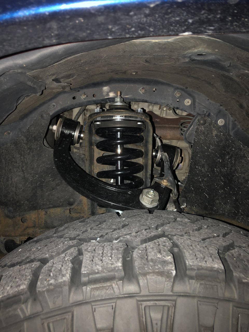

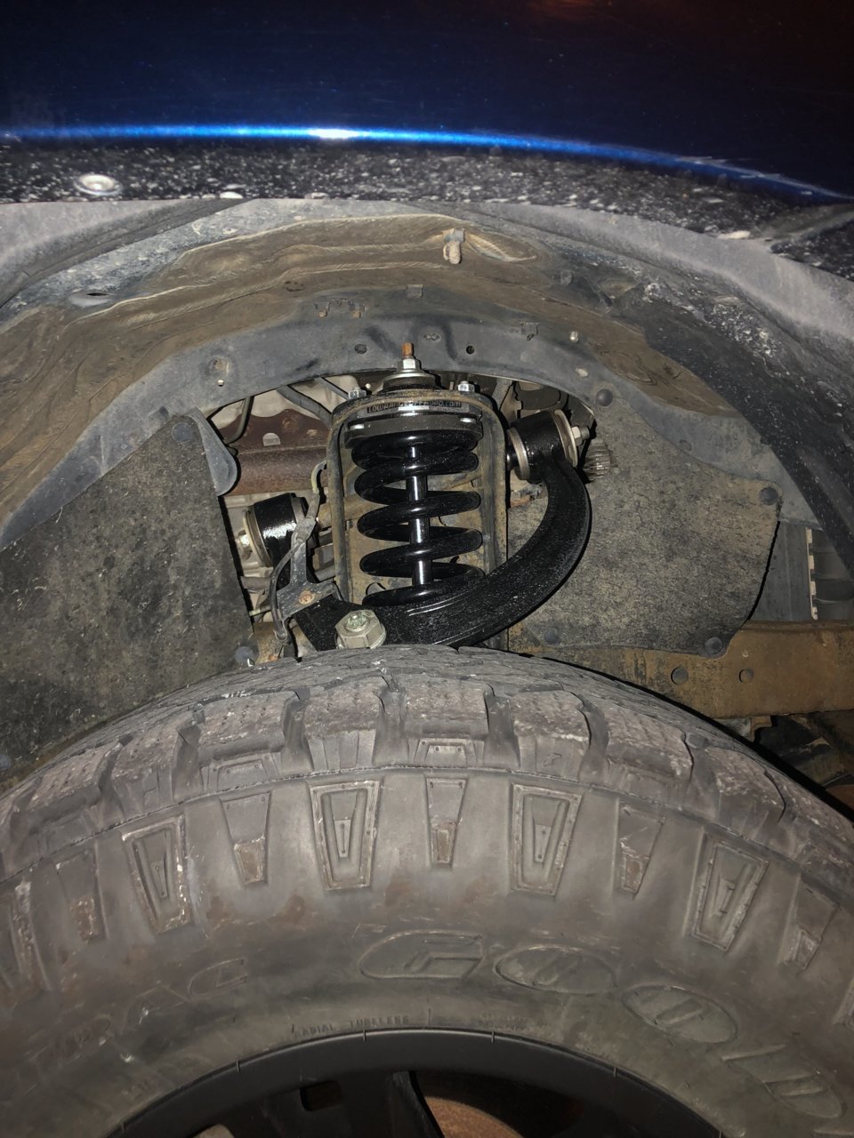

    Thanks for all the feed back, answered a ton of questions! So to answer some of yalls questions... The lift kit was advertised as 1"-2.75" lift. I wanted 3" but couldn't find a 1/4" spacer, I plan on running 33x12.5 or bigger tires so I settled for the 3/4" bringing me to 3.5" total. I have the 3/4" spacer on both sides but for some odd reason I have an extra inch on front passenger.:notsure: I will for sure take my truck back to the alignment shop w/ SPC paper and see what they can do with the adjustable upper ball joint. As far as the cv axles go, I have a diff drop kit sitting back at barracks that ill install this weekend and see if that helps the boots. My biggest questions right now is are the upper and lower ball joints "safe" (off-road worthy) at that level of contorsion and is my UCA supposed to sit that low? might I need to get a balljoint spacer?

    Majority of people do not add a spacer on the passenger side. Most people only add a spacer usually a 1/4” on the driver side to fix “bro lean” the driver side usually sits a bit lower by 1/2” or so because of the gas tank and battery is on that side. This is the reason why your passenger side is higher by an inch.

    I would skip the diff drop. Though I have not personally run one, everything I have read about them is not positive. I am running a similar setup to yours, except I have Camburg UCAs. With close to 100K miles on the lift, my CVs are fine. Yes, the boots show some excessive wear where they rub, but that is it.

    So you're running the 6112 on the max lift setting and you've got a 3/4" spacer on both sides?
    Yeah man, way too much going on there. Need to size down the spacers or remove them entirely. You're going to be doing yourself more harm than good in the long run with CV wear. Others will chime in behind me with more experience, but you're not going to get out of chopping and beating metal if you want 33" + size tires. Extra lift isn't going to help you much, only cutting will. Diff drops don't really help on these trucks so you're kind of spinning your wheels there.

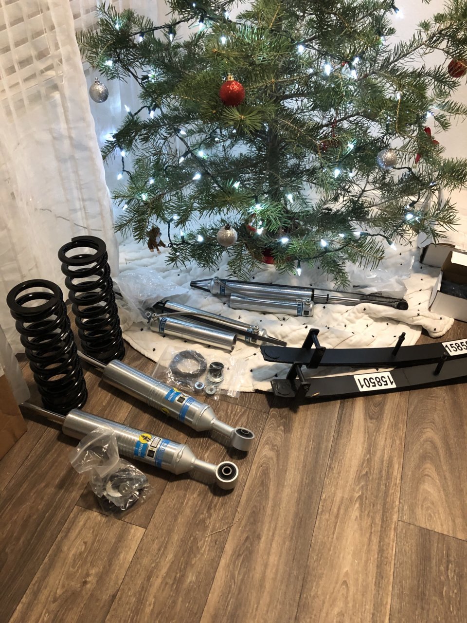

    Fairly certain there is a post in this thread with that.
    Side note: goodies ready to go on tomorrow :D under my Charlie Brown tree lol

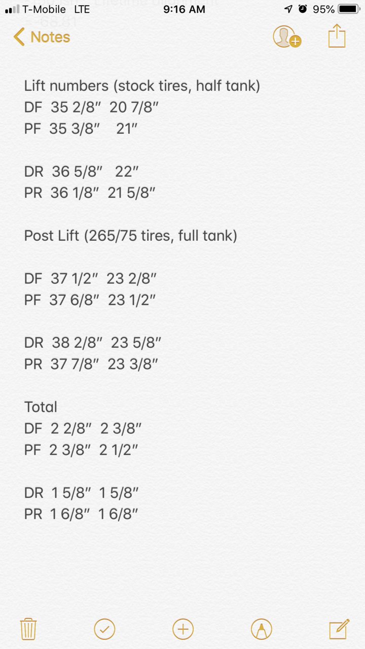

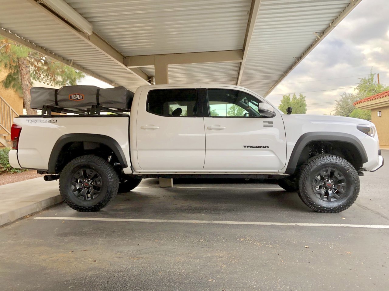

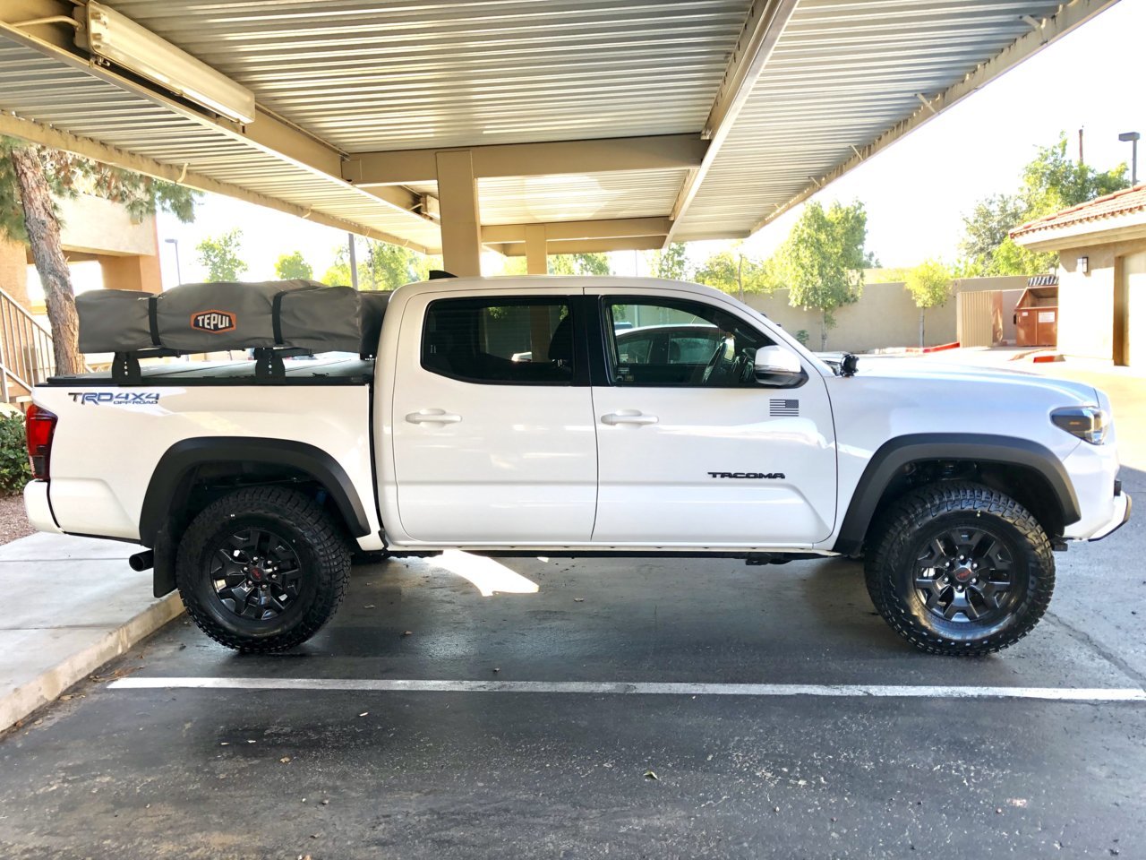

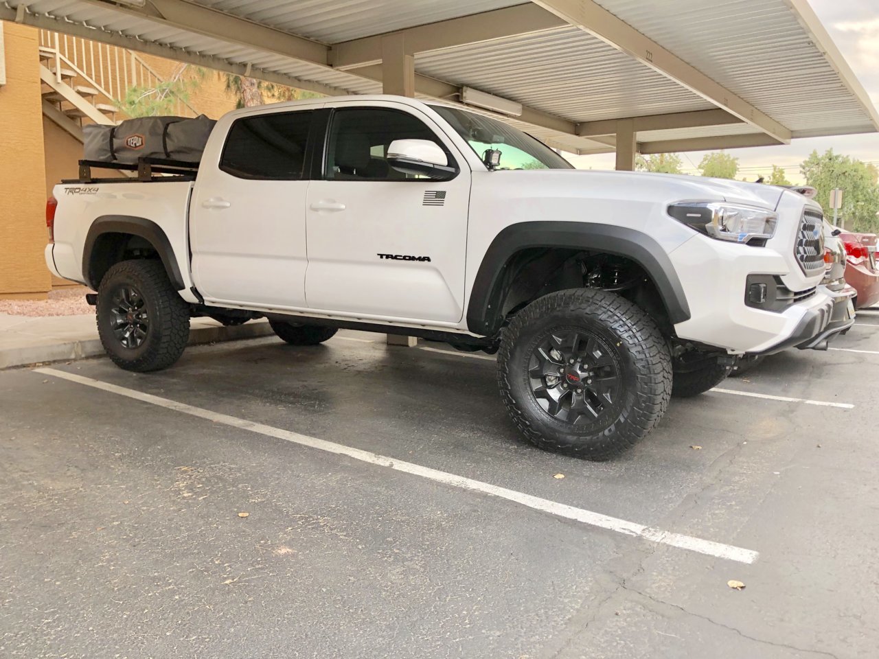

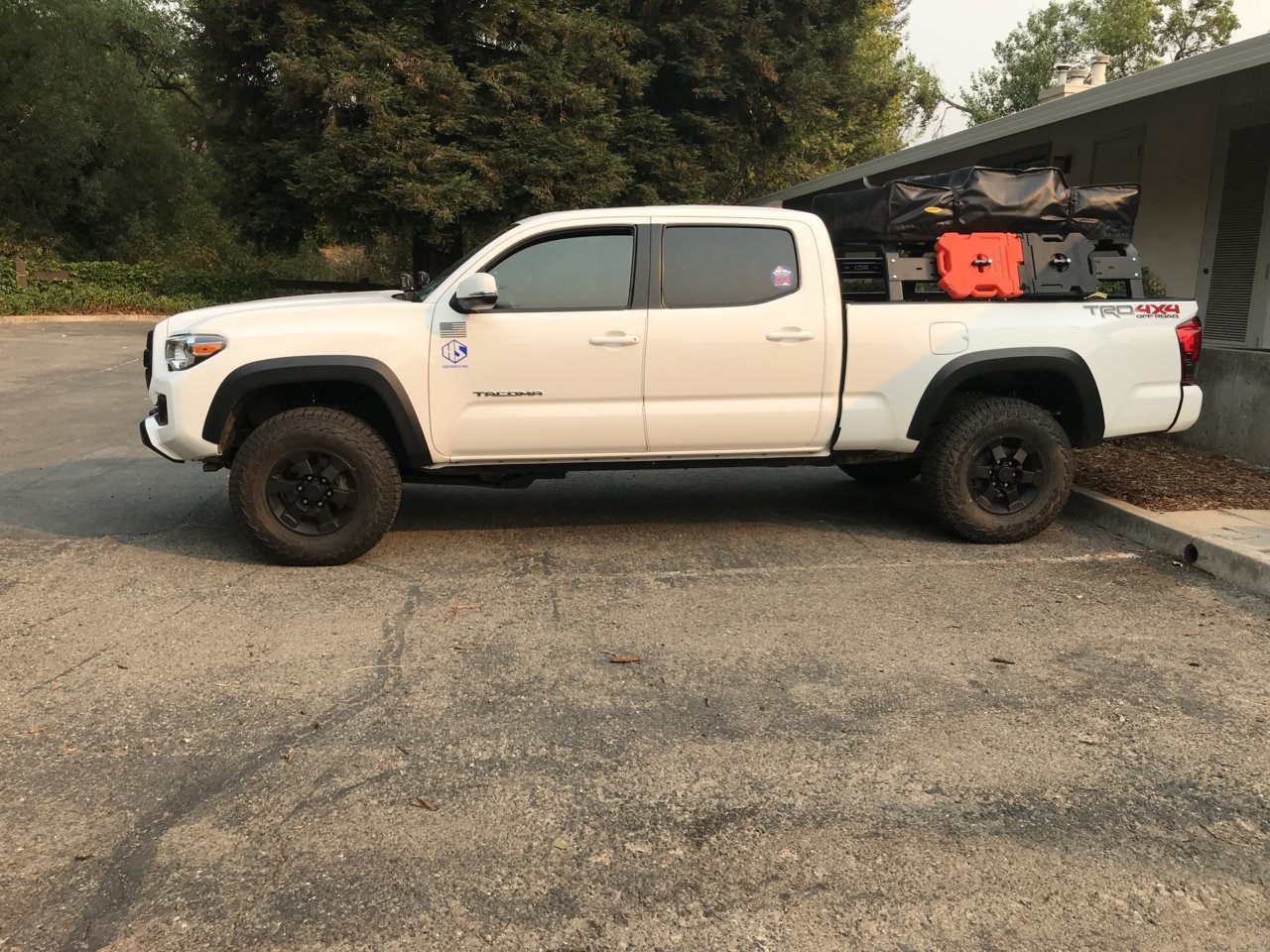

    Installed yesterday myself (probably won’t do that again) using the “no spring compressor” method. Wasn’t sketchy at all. Very easy to do. The rear was a damn pain in the ass putting in the AAL. I thought it would be easy to add the AAL without removing the stock pack. It wasn’t, but I eventually got it done. It would have been very easy if I was taking the overload out.
    Set at 6/5 with the overload in. Still 1” of rake thank God. Drove it a little afterwards and there’s no vibes or anything. Drives great. Getting alignment today.
    Stock
    Post lift
    Numbers. First measurement is ground to fender, second is hub to fender.
    Note the initial measurements were with stock tires and post lift I had 265/75 tires. So I got right around 2” in the front give or take.

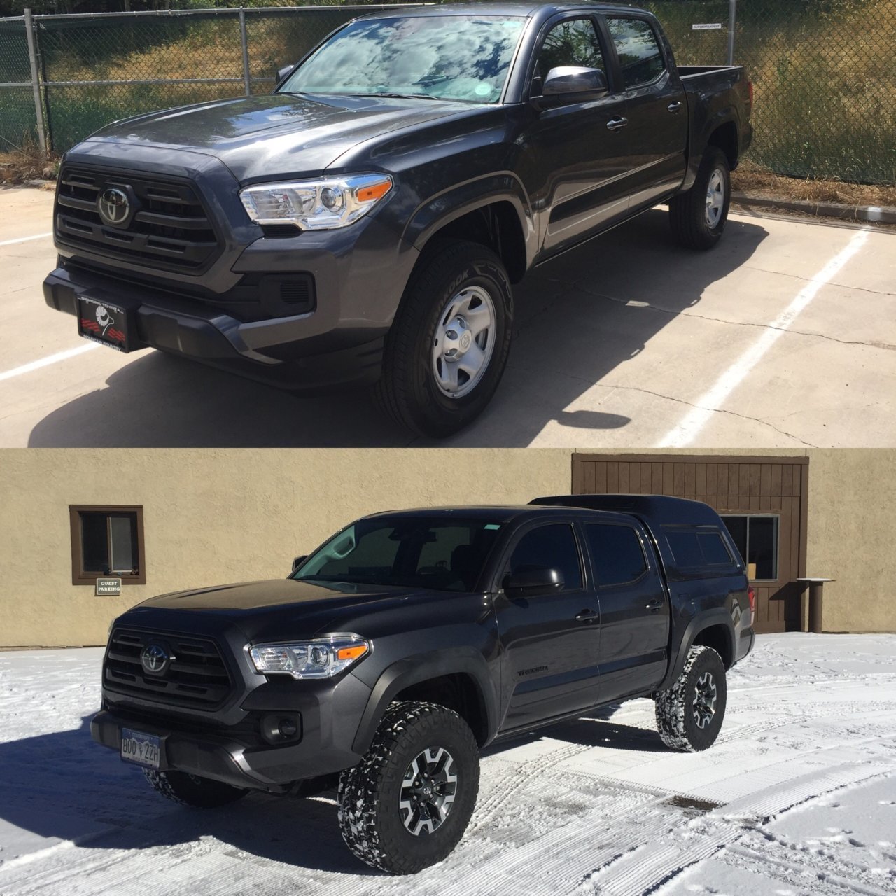

    6112/5160 with wheelers 3 AAL, no overload. Settings #5 and #4. Didn’t take the time for lift measurements. 1inch rake with ARE truck cap.
