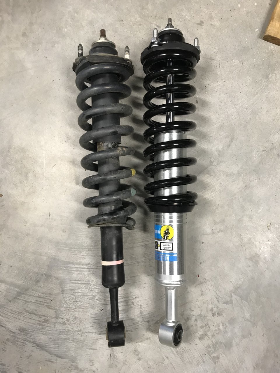

    Bilstein 6112/5160 with an Icon 3 leaf AAL. The fronts are set on the 4th perch. First pic is stock vs. 6112.
