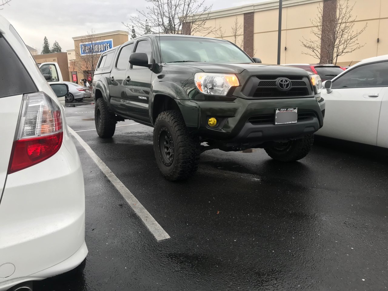

    Yeah I’ll snap some pics tomorrow

    Been busy sorry for the delay. If I get a chance i take some today

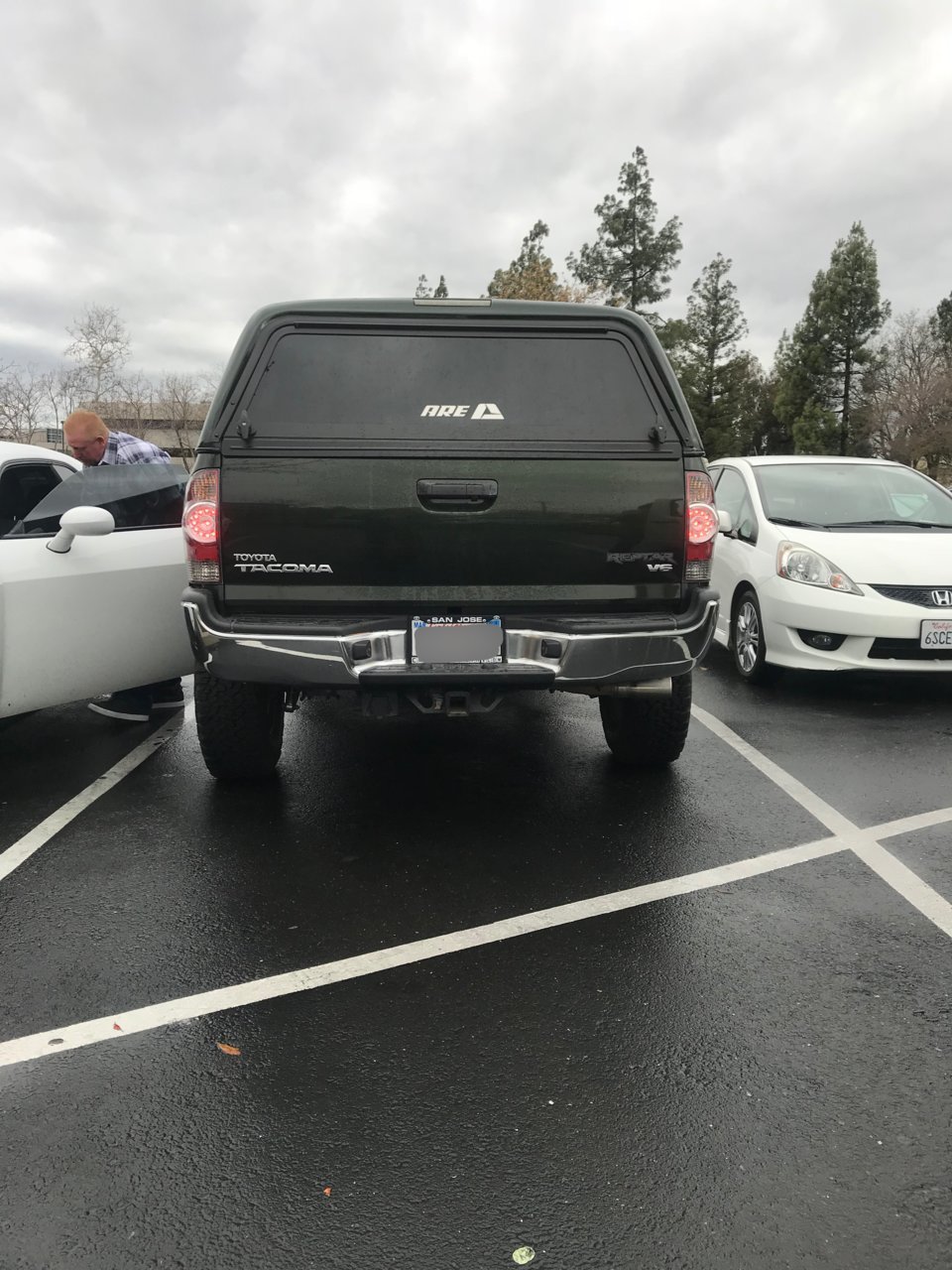

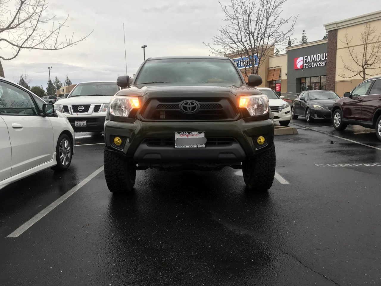

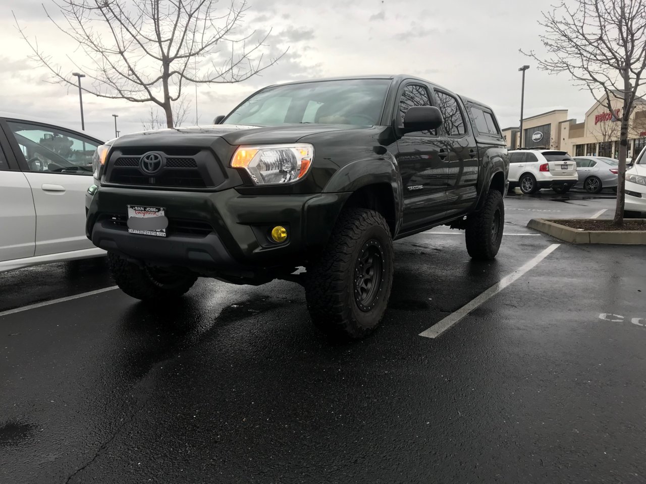

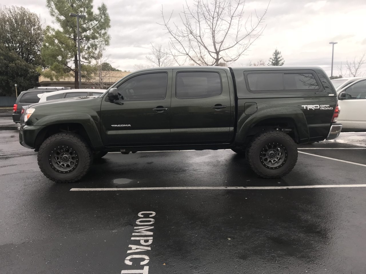

    4th notch in the front with 5160 and icon 3 AAL in the rear.

    Looks great! Thank you for taking the time to post these, it’s much appreciated. I think I’m sold on this setup.

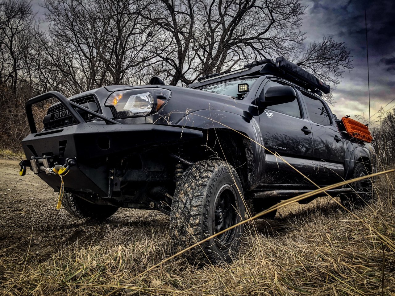

    just a couple of things tbh
    bilstein 6112s with camburg uniball upper control arm no sway bar 1/4 spacer on driver side
    rear end has dakar leaf pack with 5100s
    i have eibach 700lbs springs waiting to be installed to support my bumper and skids better
