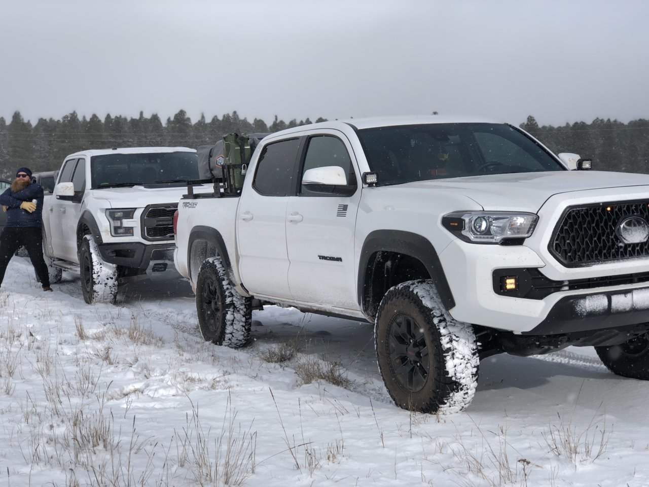

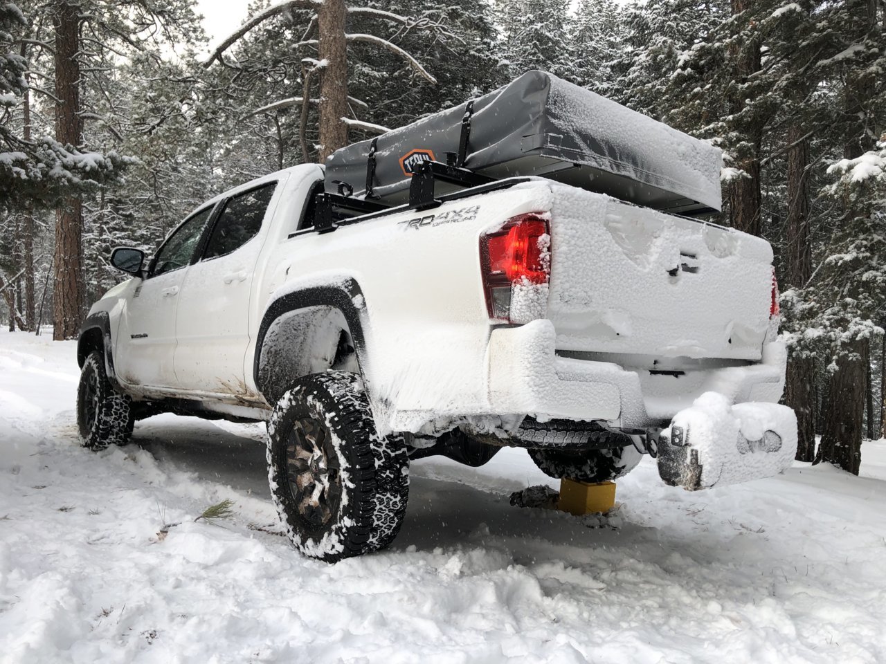

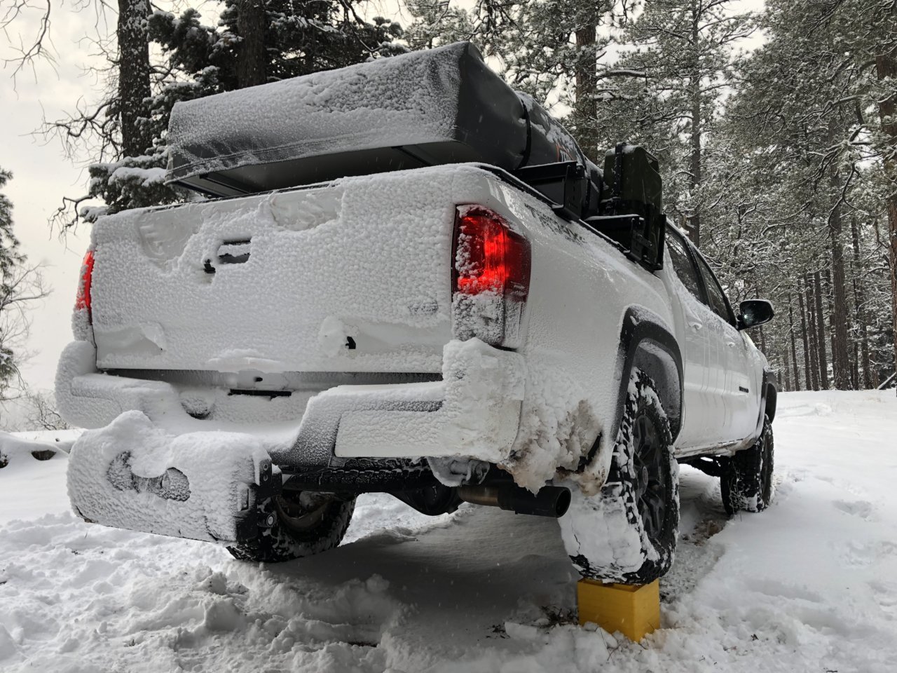

    Small update, after having my set on for a while, along with the winch bumper and winch, plus other armor. My front had dropped down quite a bit. So I replaced the springs with Eibach 700# springs. The fronts back up now.

    Was that with the springs that came with the 6112 or was that from 650 to 700?

    I replace the springs that came with the 6112, which are 610# rated.
