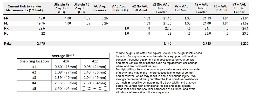

    @iK0NiK & @ajpagosa thank you both for the input... "Gray Area" and "Headache" are both great ways to describe the decision-making process here ;)
    Very helpful. In some ways, I'm worried less about not having sufficient lift (1" + 75r16s will be a nice stance upgrade from stock) than I am with too much rake, the aesthetics of too much lift, or bro lean.
    Made some quick calculations below using your feedback, and now I'm trying to decide on:
    1) #2 and no AAL (until I get a camper shell or my TSB begins to sag)
    2) #2 + AAL + biting the bullet and getting a camper shell soon
    3) #3 + AAL + praying it does not look too "lifted" on that tire size for my tastes
  8. Jan 17, 2019 at 11:01 AM

    On your option 1, I did that for a while. #2 and no AAL on brand new TSB 3+1 leaf springs. It sat perfectly level, no rake. But after 6 months or so and some towing, it was sagging noticeably in back. Then the 3-leaf AAL went in, no overload and I got the lift described above. I think #2 + AAL (no OL) with camper will look good, factory rake. Mine is a tiny bit high in back like this with no camper. #3 + AAL (no OL) will be very close to factory rake no camper. Same with camper maybe dead level or small rake. Hope this helps.
    MancoFett likes this.

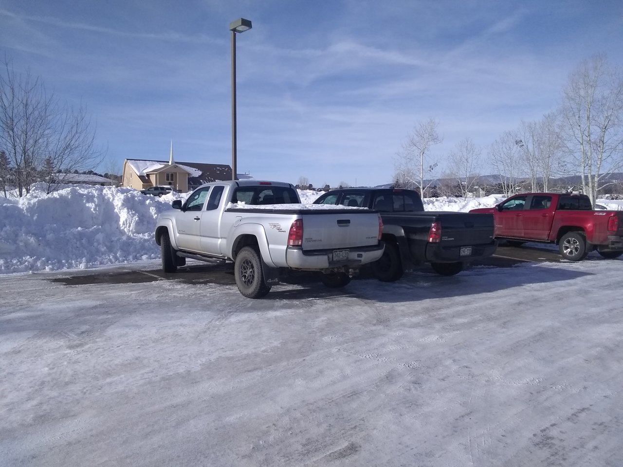

    Right now, as in the past 30 minutes because this is HARD to make a decision on, I'm actually leaning toward #2 notch + AAL, like you.
    Curious: Do you have any recent pics with your truck in this configuration? Since I've been driving around with newish TSB leafs (I never tow and rarely haul), I'm wondering if I might actually have more tolerance for the a higher rear-end (at least until I'm ready for a shell/cap).

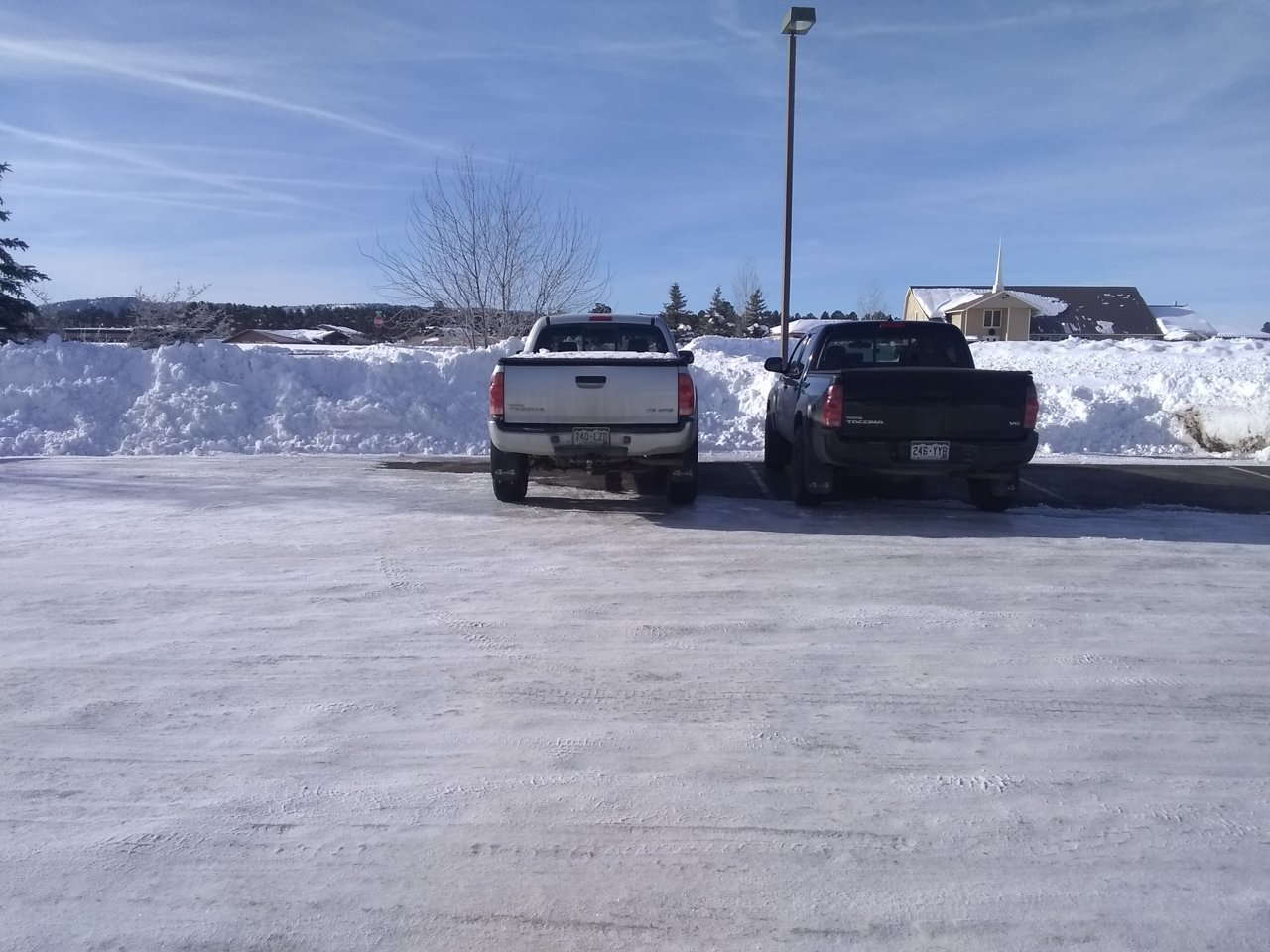

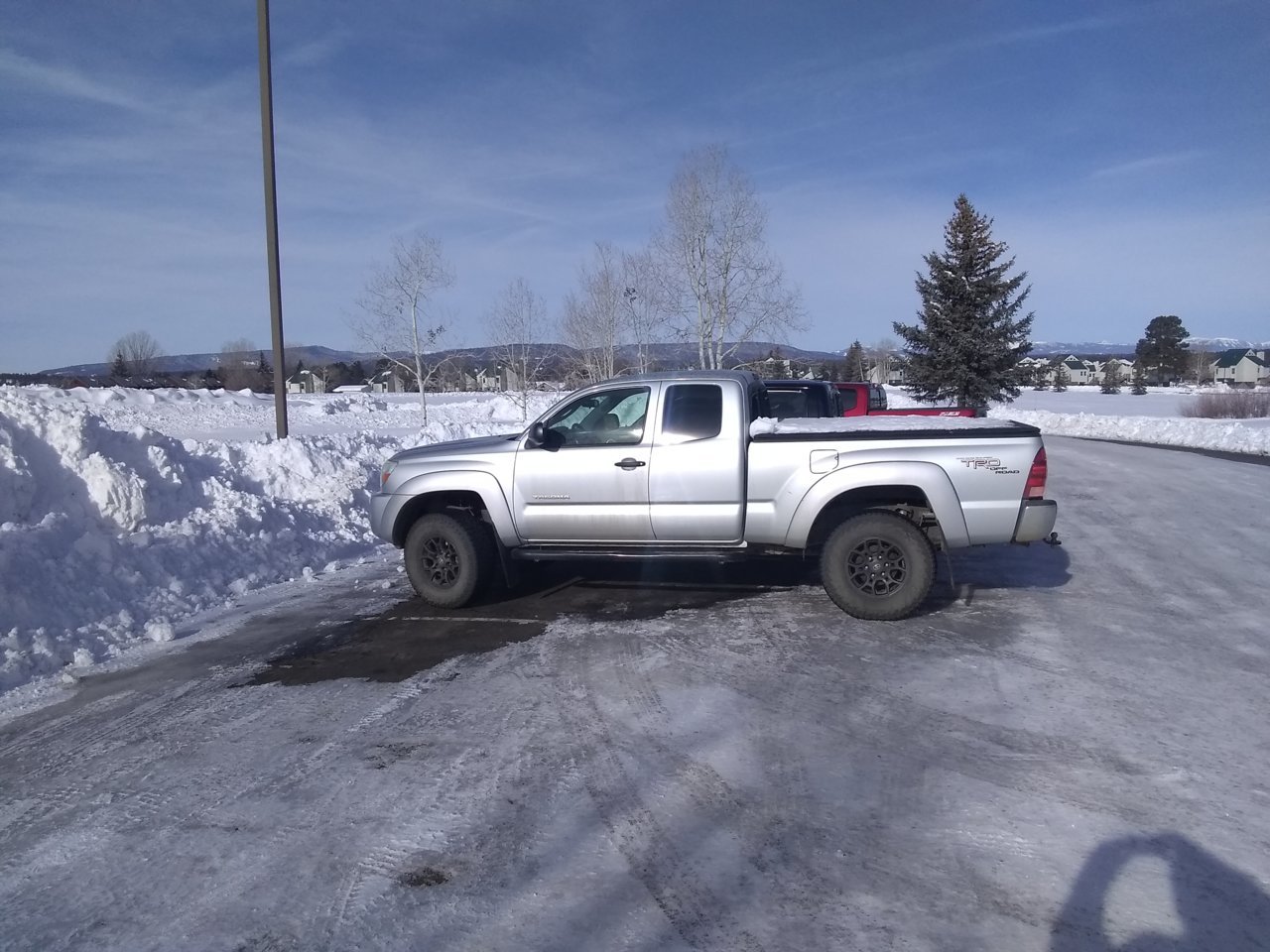

    Sure, I took these earlier today. They are a little misleading obviously a lot of snow and the rears are on about 3" of ice, fronts on pavement. Parked next to my buddy who has dead stock 2012 Double cab, auto V6 SR5. All season tires. His truck's not on as much ice. ALso my truck has taller 265-75/16 Falken Wildpeak AT3 tires.

    Thanks so much for taking those. I think your truck looks badass.

    Thanks. So on flat pavement it would be a little easier to see the rake. I have about 0.5" more than stock. I think if you put a camper on it would drop back down to factory rake maybe little less depending on how heavy it is. One other thing I have is a Helwig rear sway bar kit. You just can barely see it under the rear end.
