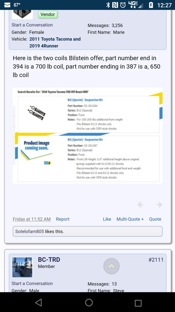

    Did you buy the special bilstein springs make for that purpose Screenshot_20190311-002720.jpg

    If you read the 700lb fine print it says they are to be used with 8112 and the 650lb are to be used with 6112
    DRob and yotatotaco77[OP] like this.
