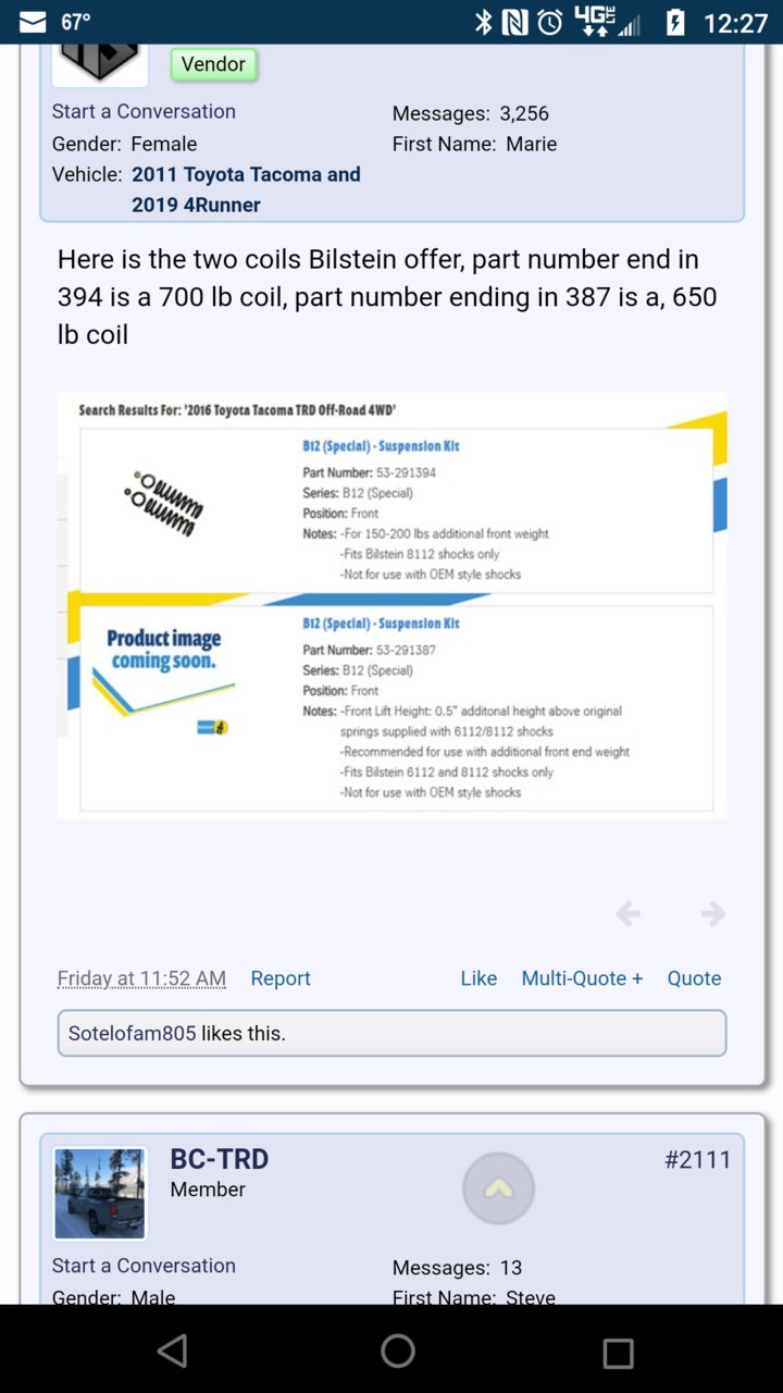

    Spoke with Wheelers again and they reiterated that there is no issue with running the 700# springs with the 6112s. They said they have sold that pairing to lots of customers and have had no issues. So I'm just gonna stay with the 700# springs and hope for the best :fingerscrossed:

    If bilstein says the 6112 are not intended to be run with 700s I would recommend following the directions of the manufacturer. I know money is an issue, but paying to adjust the coilover height to still not be happy with the result will lead to paying the shop again to install the correct coils. Famous TW saying ... pay once cry once

    I agree 100%, but I've already bought once, lol right now this thread has become more about letting others know, if you're going with the 6112s, and need extra spring rate, get the 650 coils! Lol
