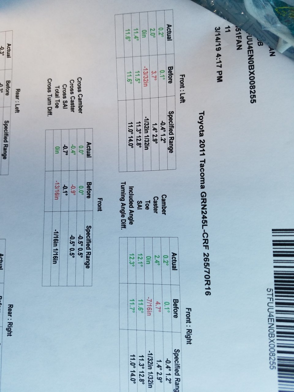

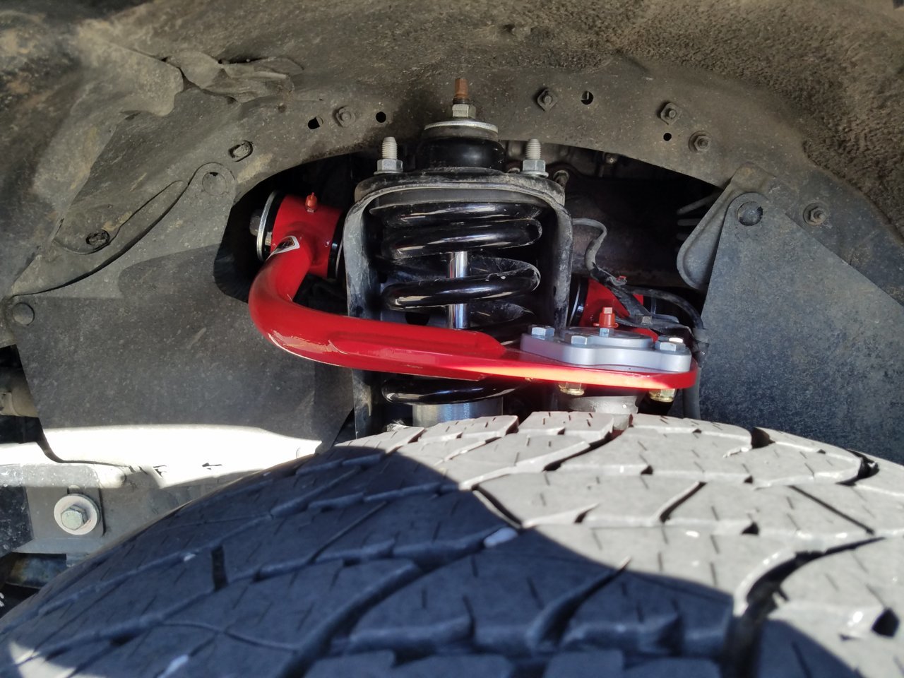

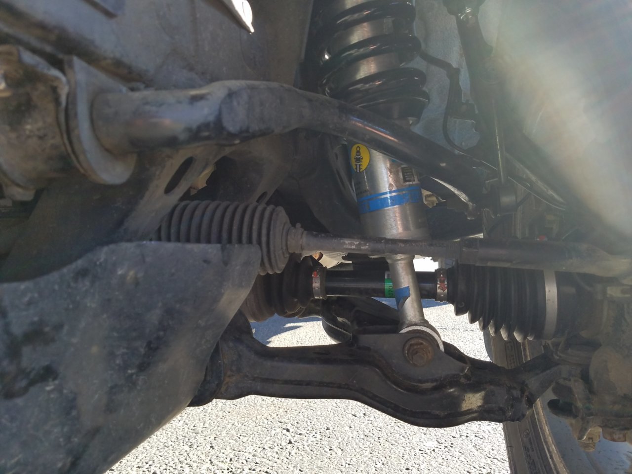

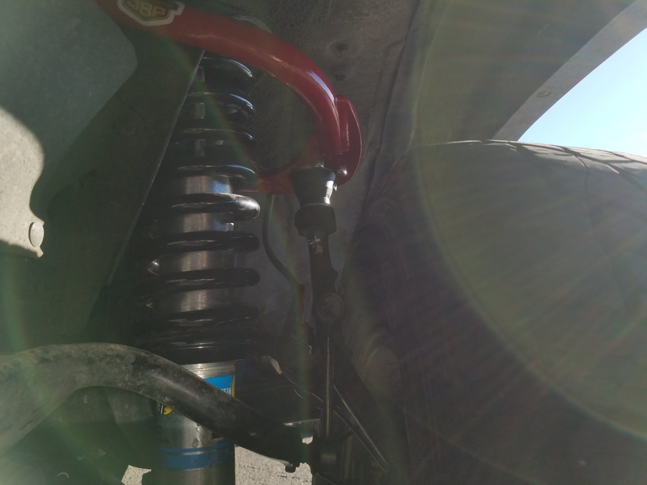

    Ok, got my truck back from the shop this morning, so I'll post some pics. I lowered the 6112s all the way down to the 1st clip on the PS and the 2nd clip on the DS. Its giving roughly about 2 inches of lift, about even both sides. So it came down about 2 inches overall in the front. I had the shop install my JBA UCAs as well, I'll post a pic. I'll post a pic of the alignment too and feel free to chime in, I'm not sure what its supposed to look like after the new UCAs were installed.

    Driver side

    Alignment, sorry idk why its sideways

    One more of the UCA

    I like how the ride height is pretty level side to side. Alignment is with in specs- depending on your level of OCD of where you want the alignment at may get different response. I guess the proof is how does it drive and track. Soooo now that you have it lower and sitting more in the suspension range of motion-how is it riding- Had a chance to hit some pot holes and speed bumps for effect? Hit some dirt ruts and like? Also how is it cornering... one thing I was thinking is with the stiffer spring and shock set up I would consider removing the front sway bar for articulation off road.

    Haven't had the chance to take it offroad yet. I plan on going out on the dunes, take it out on some of the sand rail trails here this weekend. As for on road handling, it's doing great, drives straight, it used to pull left the tiniest bit before the alignment, that's gone. It didn't ride especially harsh before, but it soaks up more of the cracks in the road than before. All in all, in lowered in the front just a little more than I'd like, its sitting right at 2". Maybe 2.5" on the PS. It has quite a bit of rake now as well, but I plan on adding some other stuff to the rear, new bumper, cargo rack, etc.... should bring it down. But I'm happy with the results... for now:D
