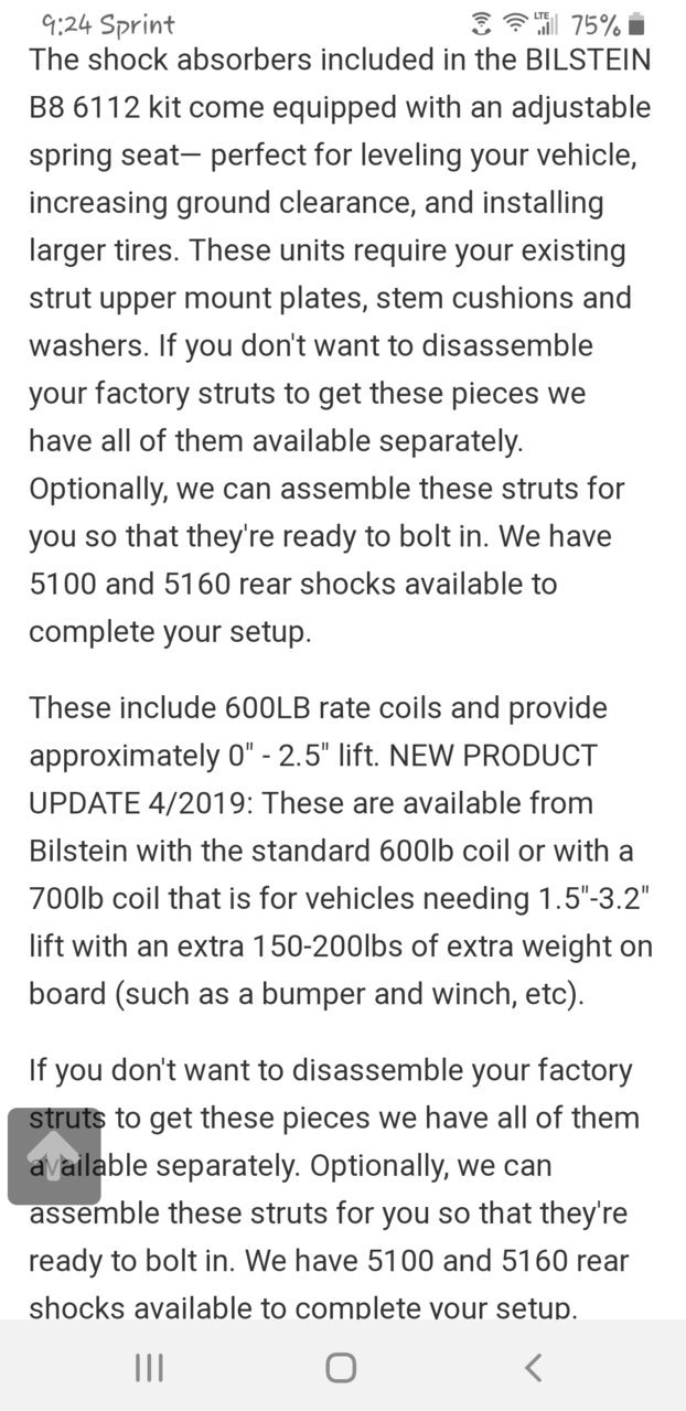

    Bilstein ONLY recommends the 600lb springs that come with the 6112's or 8112's or the 650 bilstein springs that will fit on the 6112's or 8112's. The 700lbs eibach springs that are sold by aftermarket websites are NOT recommended and will highly increase the likelihood of premature shock failure and a voided warranty from bilstein.

    So it says/ Update: as of 04/19, so Bilstein listened to.the masses and made their own springs to accommodate?? As to where this post is way beyond 04/19, and I specifically got the Billy 700 spring.

    I dont know bro, if that email aint from bilstein i dont trust it. I read on this forum about a guy who purchased 6112's with the 700lb spring upgrade from wheelers and had WAY too much lift approximately 5-6 inches or so. The 700 lb spring was not a bilstein brand spring.

    Bilstein did not listen to the masses and they do not make a 700lb spring for the 6112. This is another offroad website (NOT BILSTEIN) coming up with their own combo using an eibach 700 lb spring. The reason I personally went with the bilstein 6112 is due to not only the 60mm shock or its adjustability, but its lifetime warranty. A 700 lb spring will completely void any warranty immediately and most certainly ruin the shock in a shortened amount of time.

    FWIW, the normal spring that comes with the 6112 is 600#. From their web site note that they offer something called a B12 Special spring for the 6112 (and 8112) for 80-140 lbs. of additional front end weight. Translation: a spring >600#, although they do not specify its rating. https://cart.bilsteinus.com/results...id=4520050431512085316&Dr=4351738904601333697

    You are correct sir. That is the 650lb spring. It is the B12 53-291387. It is made by bilstein made for the 6112/8112 shocks. They don't have the specs on their website anymore but they did about 2 months ago. The 700lb spring that some people do upgrade to is not made by bilstein but by eibach.

    So the response I got from them was to send them the part # that was ordered, and I just did. # 53-291387 (B12 SPECIAL) Not sure if that is a proper designation, but added it anyway. Hence, I'm awaiting again for the reply. I'll keep y'all posted.....

    So Bilstein part # 53-291387 is for the 6112 and is the 80-140 HD coil that will work; as mentioned in previous kit. After calling Bilstein and asking, because emailing just sucked booty, this spring is the 650lb spring, and not the 700 the idiot at 4WP told me it was. So anywho, should I drop a few notches when I get these spring gas since I lack bumper, winch, lights, and mounts, (lol)??? 2nd or 3rd will sound adequate. Any suggestions??

    This is a FYI for everyone that has 6112's. I just received the new 650lb Bilstein springs to get installed in my 6112's. This answers the question of the 650 vs 700lb debate.
