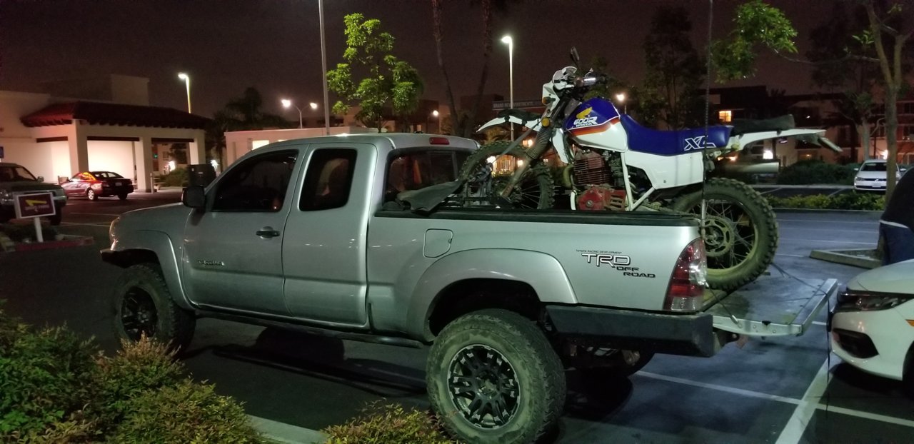

    Not enough
    I just love going offroading/camping and I'm more interested in following my friends in there massive rigs, so I want lift and ground clearance.
    700lb
    5/4 notch, I've been fine
    I did a huge road trip in 2018,over 5000 miles, wheeled at moab, wheeled in big bear, these trucks are pretty tough. I just like to drive it, yep its stiff but its smiles per gallon, even broke a carquest axle doing so, but it turned into a cool story and learned from it. Part of wheelin DSC06462.jpg

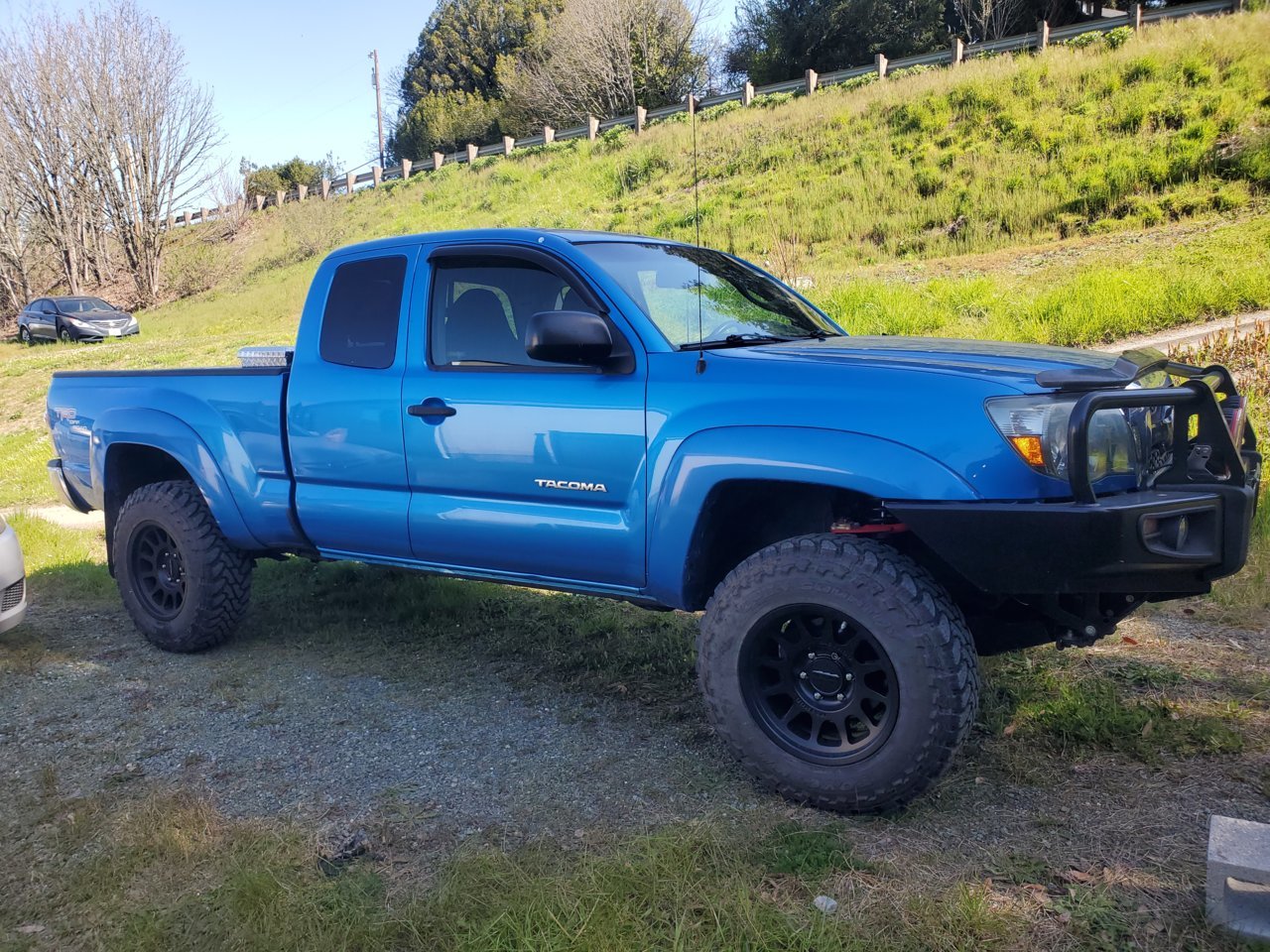

    Bilstien 6112s with 700# springs ARB Deluxe Bull Bar 9k winch Bilstien 5160s Icon progressive 3 leaf AAL
    OP here. This is my truck as it sits, still with the 6112s and the 700# springs. Haven't had any issues. 3rd notch passenger side, 4th notch driver, for the lean. I would say it gave me about 2.5" lift. Which is right where I wanted to be. Still have the Icon 1.5" AAL in the rear, so it sits pretty level.
