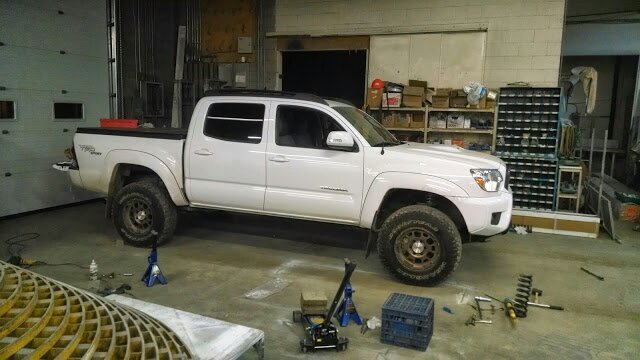

    This is my truck just after install of 5100 and eibach set at 0. I have since gone to camburgs!

    Okay thanks, how level did your truck sit?

    It would have leveled it perfectly. I also installed a 1.5AAL at that time.

    Okay perfect, and what size tires are you running in that picture.

    No problem! 265/75/16 duratrac's

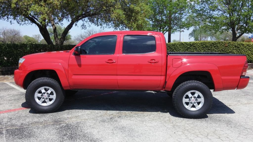

    Here is my Eibachs and 5100 at.85 w 2" Toytec AAL in rear with 285/75/16

    ^^^ This is the one pic I have been looking for for some time now! ^^^
    Your truck has just the look and stance I'm going for Schleygo. How you like that set up? Any problems clearing the 285s? I can't wait to get lift installed! Thanks for the post!

    How's that ride quality, I have the 5100's and 883's, set at 0, been debating on how the ride would be if I bumped my clips to .85, sweet stance on your truck.

    I lost the soft factory ride for sure. It has stiffened up the ride but after it broke in after 3000miles or so, it got better.
    I also have light racing UCAs help with the alignment. I drove around for about 500miles lifted without the UCAs, it was on roller skates. I definitely recommend getting UCAs so the alignment is within spec..

    I've seen people run the 5100 @ 0 and barely look lifted, others run 0 and look lifted and the picture above @ 0.85 looks more like a 3" lift. I just got my 5100s from DSM today and have the Eibachs on backorder from ToyTec. I'm planning on going @ 0.85 in hopes my ARB will drop me down enough I don't need UCAs. It appears that needing them is largely truck dependent. I'm hoping to get away without them, but will most likely drop to the 0 setting before I go UCA at this point.
    If I wanted to go the UCA route, I would have gone full OME, but at nearly $1,000 more than the Eibach / 5100 / AAL route, it wasn't practical for me at the moment.
