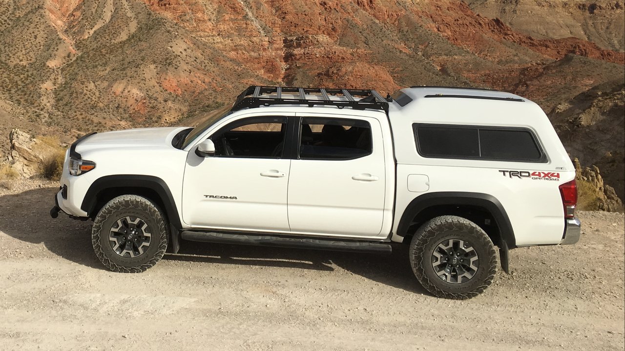

    With Headstrong Off-road (Marie’s) recommendations, I went with 5100’s and a Deaver single leaf- She recommended that route based on my having BFG 265/75/16’s, and occasionally towing up to 4000 lbs, and loading with camping gear, rocks, etc., along with 4w driving. My front 5100’s were set at 1.25”, and the rears at 0 with about 1.5” added from the AAL. I also kept my overload leaf intact. Marie as HS was very helpful! Couldn’t be happier!

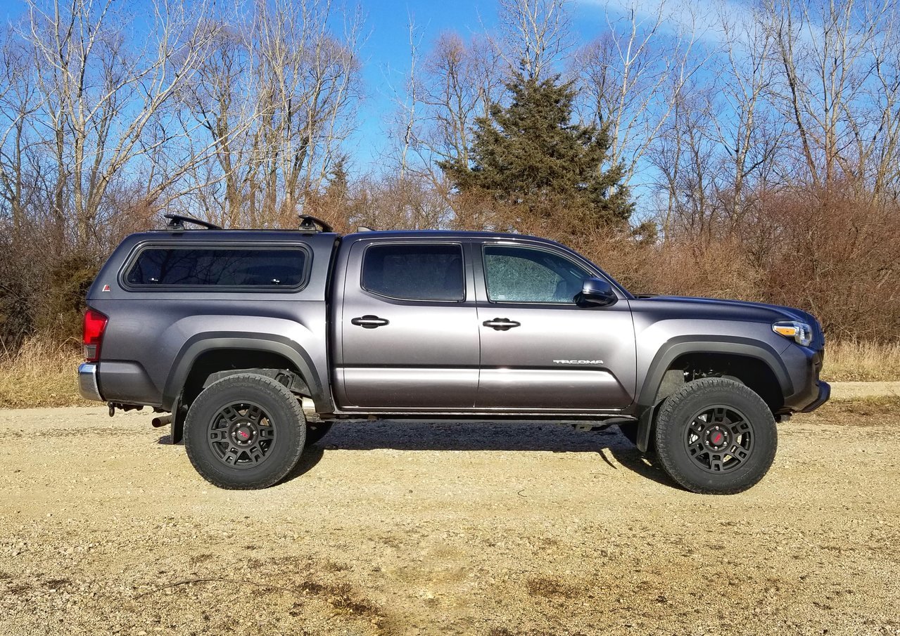

    Just had mine installed today. 5100s w/887 coils. Deaver single AAL in back. The 887s netted me about 2.75" but I expect them to settle. Not sure what i got in back because still have take-off tires and rims and stock suspension in bed. Rides really good though.

    That height looks perfect in my book! What size tires?

    Thanks. Tires are 255/75r17 Dynapro AT-m. They come in at about 32".

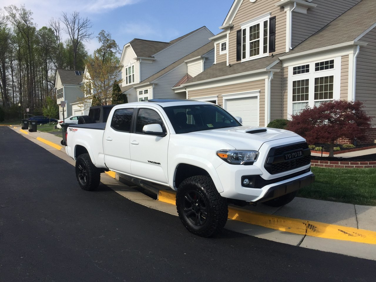

    vprgts
    vprgts Well-Known Member
    Jun 30, 2011
    #59106
    422
    Walter
    Centreville, VA
    Tacoma TRD Off Road Hybrid
    285/70/17 Nitto Ridge Grapplers, RRW wheels 17 x 8.5, Wescott designs pre collar lift, rough country power side steps, Truxedo pro x15 soft roll up bed cover, OEM bed mat, OEM bed swing out box, OEM Trd pro front skid plate, aftermarket pro grill, diode dynamics led fog lights, OEM sport hood, PPF and tint,
    265/70/17 BF Goodrich K02, OEM 17" Sport wheels, Bilstein 5100's, OME 887 coils, single Deaver rear AAL.
    Thank You again headstrong Marie!
