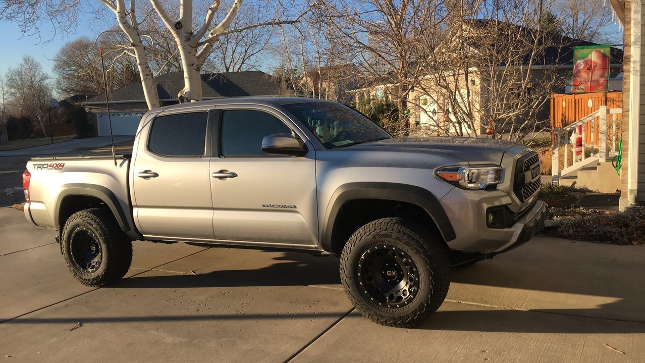

    Technique
    Technique Well-Known Member
    Nov 4, 2017
    #235046
    2,922
    Alex
    Utah
    2017 Silver Offroad DCSB
    -285/70/17 Toyo AT3 -Tuned
    5100s all around with 885 coils (1.75" in the front to level it out)
    265/70/17 Falkens

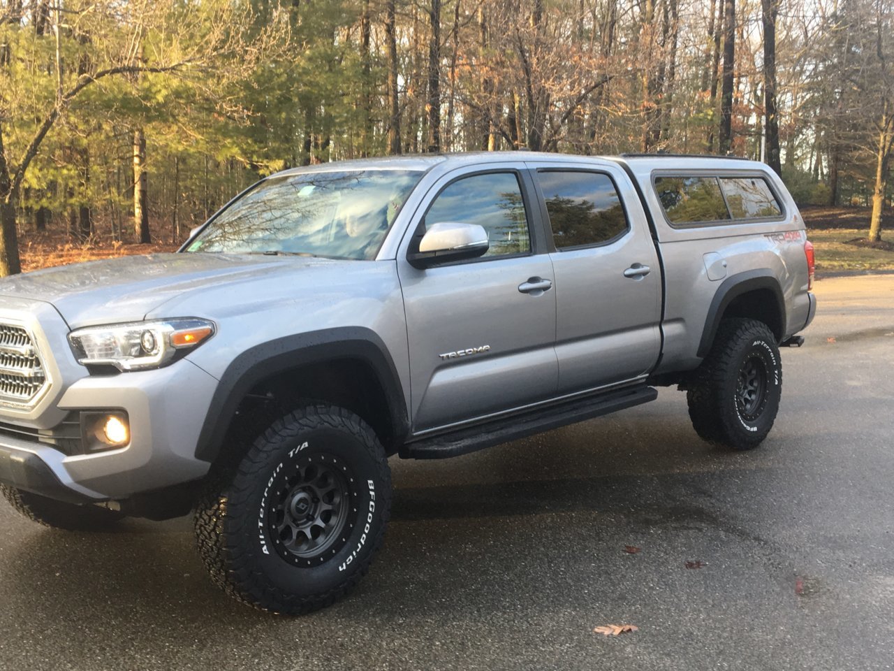

  13. May 5, 2018 at 5:35 PM
    #33
    TimmyC
    TimmyC Well-Known Member
    Jun 25, 2013
    #106985
    140
    Tim
    Central MA
    2017 TRD OR DC Long Bed
    Billstein 5100's, OME 888 Coils, Dakar Medium Duty Leaf Pack, SC Ray Rims, BFG K02 - 285's, Leer XR100 cap, Topper EZ Lift System
    888 OME springs, Light Racing UCAs and Dakar Medium Duty leaf pack. Rides like stock and couldn't be happier with the lift and how it looks! IMG_1552.jpg
    vicali, MikeR585, sorgon82 and 3 others like this.

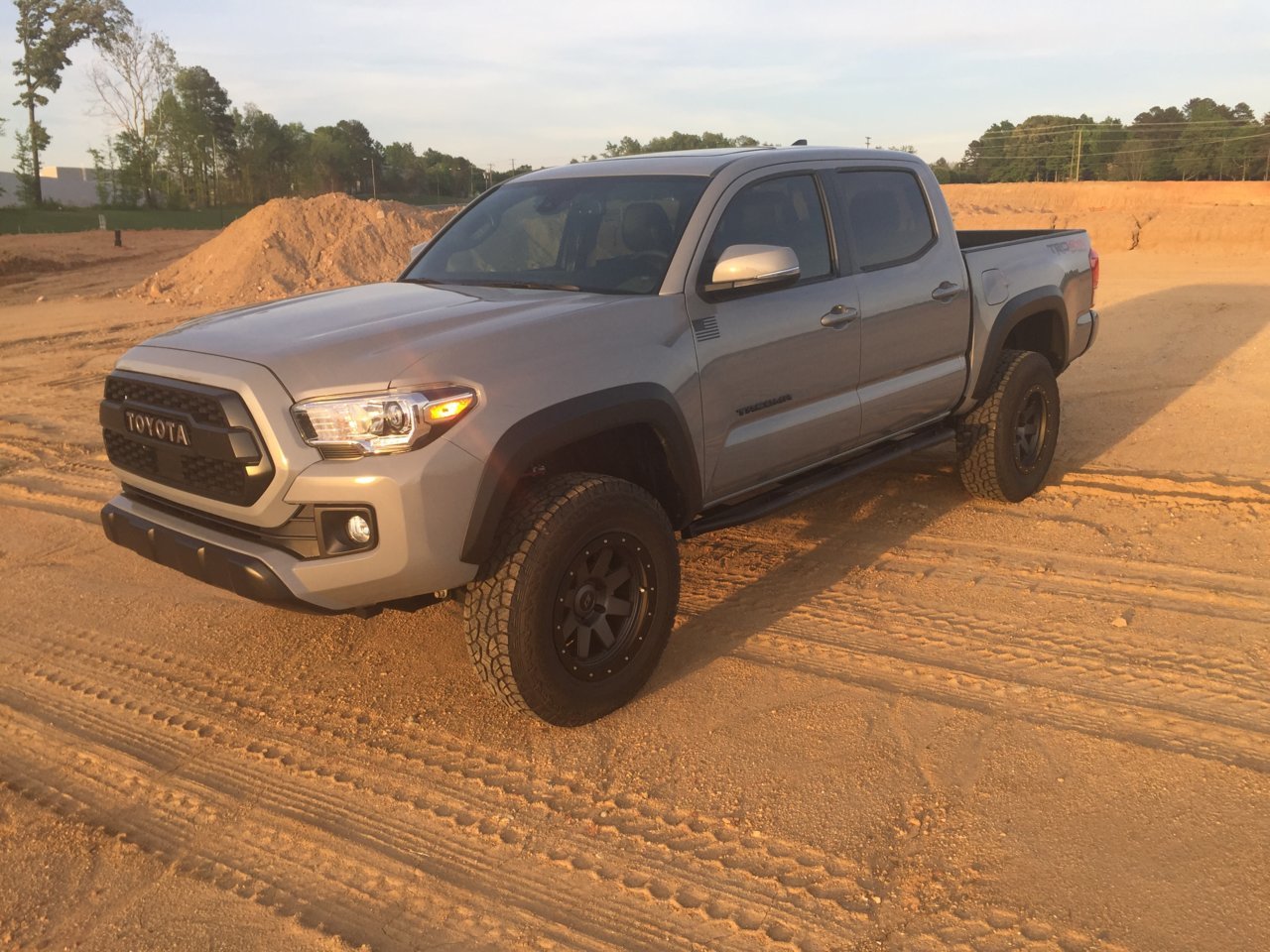

  15. May 5, 2018 at 5:53 PM
    #35
    jerzsubbie
    jerzsubbie Well-Known Member
    Aug 23, 2017
    #227834
    976
    Davidson, NC
    ‘13 GX460
    Bot_Chu likes this.
