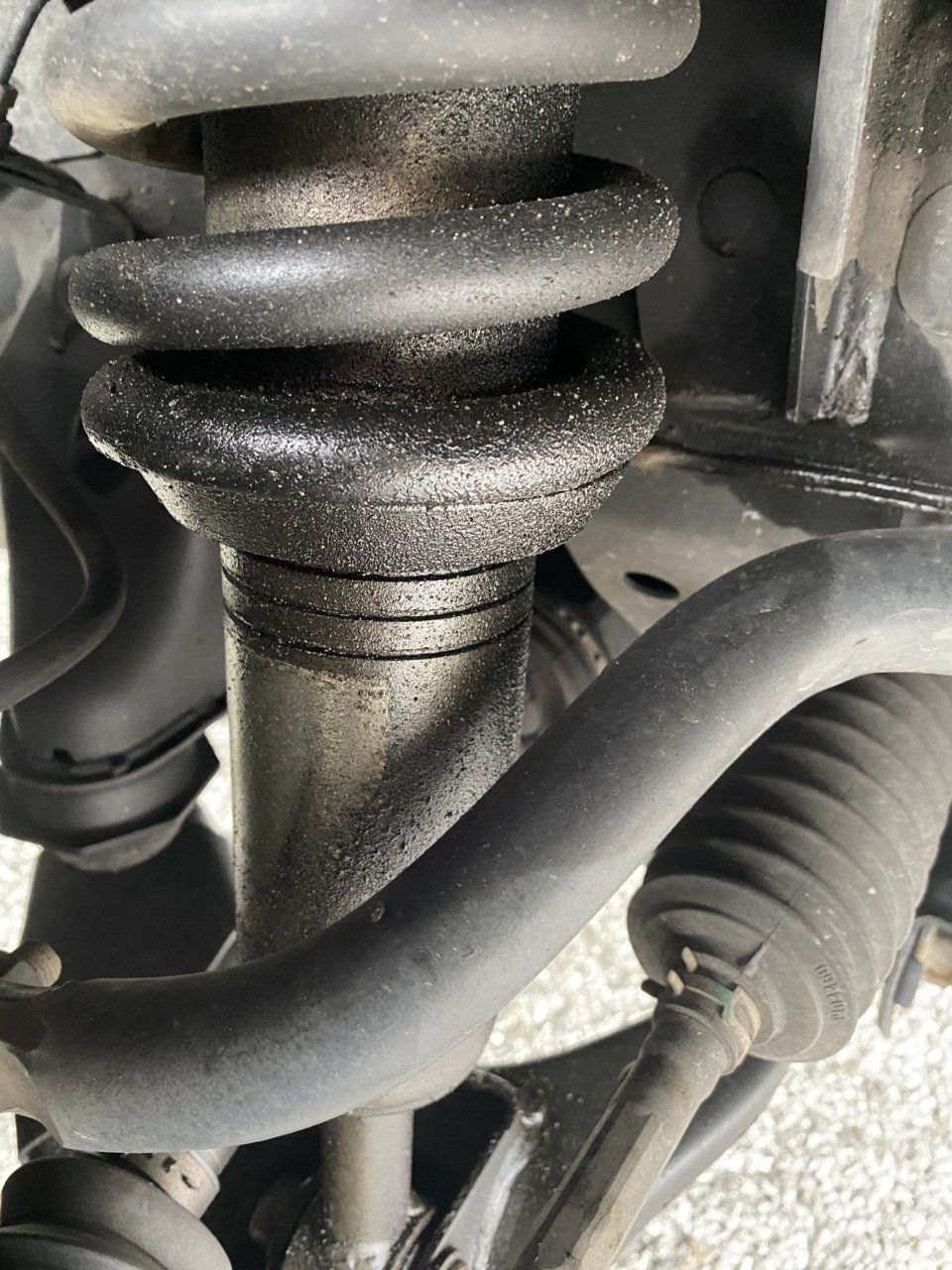

    i put a 6112 series 0-2.5" in my 15 taco. front right shock is starting to leak, confused if there just 5100 shocks to replace, and the kit model is 6112, i need front replacement shocks

    Are they still under warranty?

    I put them in in 2016 I don’t know how long the warranty is on them?

    Bilstein 6112 Series Leveling Kit - 46-241627
    Post your results when completed for others
    Bilstein-aftermarket-warranty-North-America-v.-2020.pdf
    Within the warranty period the authorized BILSTEIN distributor shall be obligated to repair or replace a defective Product at its discretion. This does not apply if the Product has been used improperly and contrary to BILSTEIN’s instructions. Further claims for defects by Purchaser are excluded.

    Thank you for the information they are under warranty I contacted low range off-road where I bought them from. They contacted the BilStein department and they authorized for both shocks and both springs to be replaced the only problem is they have none in stock it seems that when the stimulus checks went out all their products will wiped out. Thanks again
