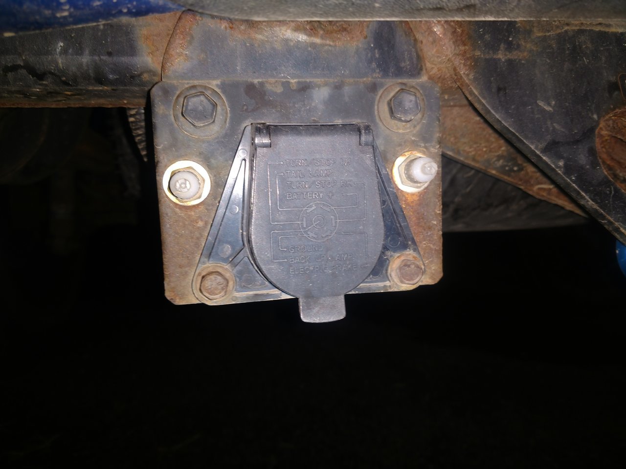

    On my trailer socket bracket.
    I also added the Daystar cradles under the airbags due to off-roading, etc. I tow a 3750# dry travel trailer and keep the bags at 25-30 when towing They made a huge difference in the 'porpoise' action.

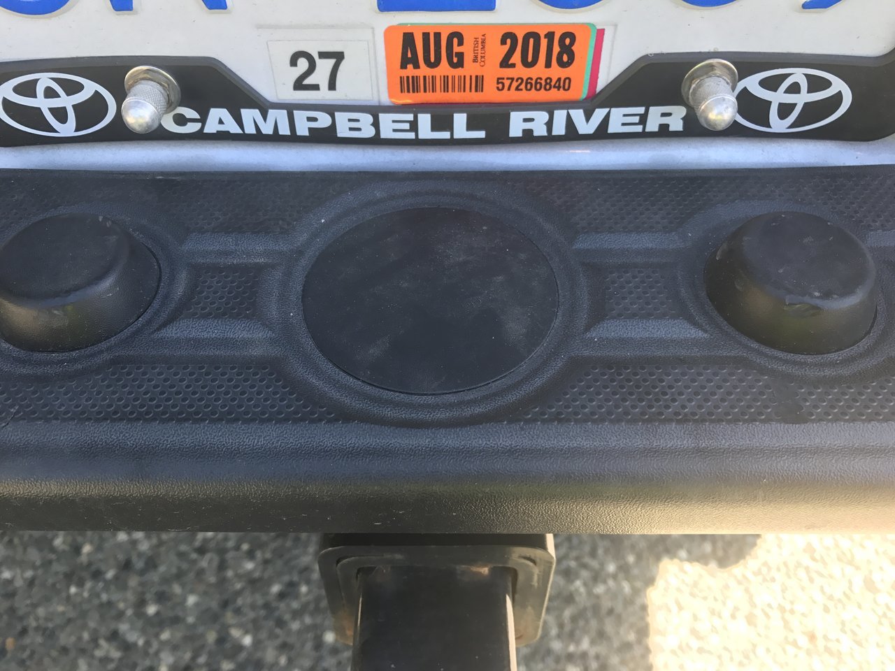

    I'll try and post a picture but I drilled through the bottom holes on my license plate bracket and stuck them through there. They look factory and they work awesome!

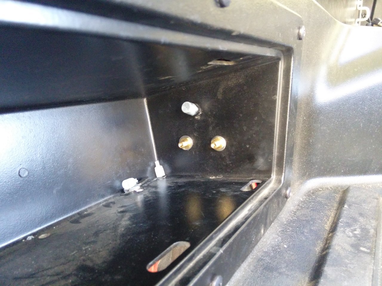

    I put them in the driver side bed cubby. Didn't want anyone messing with them.
    pmstoy10 likes this.

    I thought about putting them in the passenger side storage cubby, just forward of the AC Inverter outlet, but when the truck is mostly loaded, thats not easy to access. My driver side cubby has a couple cam straps, a pair of channel locks, a whisk broom, and a pair of work gloves in it...

    This is the location I chose. Fits perfectly and never had an issue
