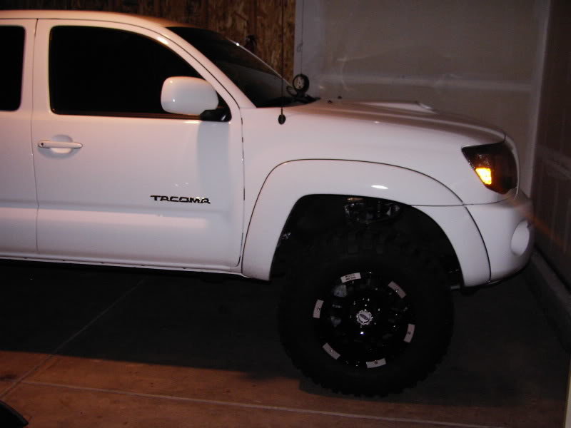

    So my 09' Sport now has the billies installed and set at 2.5" pro-comp 1.5" AAL, Moto-Metal 951's and I went with a set of BFG KM2's Mud terrains....
    The truck drives straight dow the road but has a nasty wobble. I'm hoping its a poorly balanced wheel....

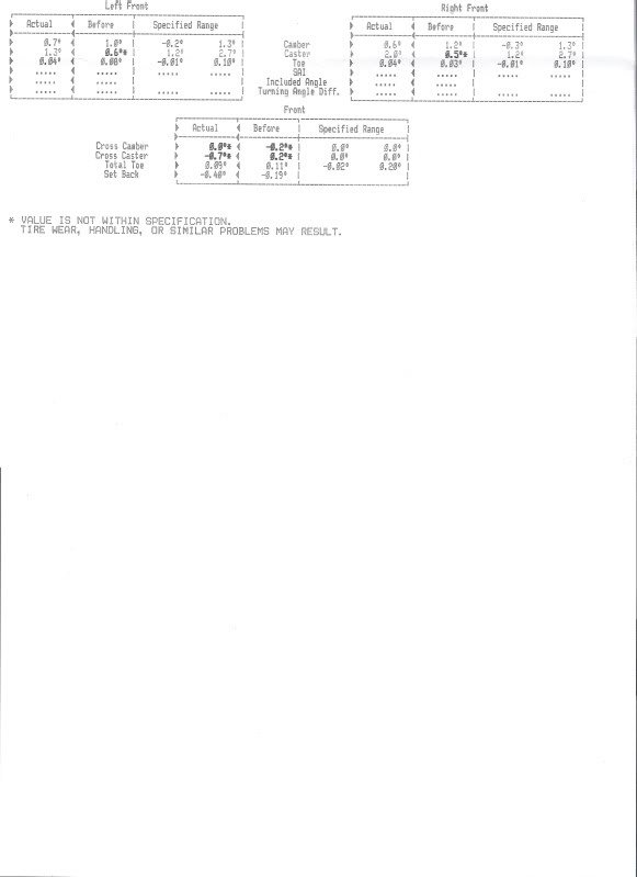

    I 'm not sure what to make of this alignment sheet....I think its begging for a set of TC UCA's as its not in "Spec"?
    Heres the sheet where I had the truck aligned today at the shop that did the lift...This was done with the factory wheels and a set BFG 265's...I then drove it to discount tire and had the wheels and tires installed. I'm assuming I now need to get the truck aligned again with the bigger tires and aftermarket wheels? if anyone wants to give me some guidance on how to address these parameters?
    Lil' dark in my garage but heres how I'm rolling now:

    Now that I have the bigger tires and different wheels the truck should be aligned again no?
