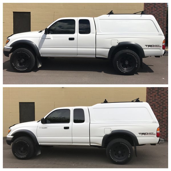

    IMG_1606.jpg Here is a before and after photo. I love the way things turned out, and so far the ride is very nice. If the rear ends up settling, I can always put the one leaf back in. That's why I went with the dakars. Below you'll see the wood deck that I built when I first got the truck. All of the panels are removeable, that way I can take everything out in an instant if need be. The last photo is from the day I bought the truck! IMG_8726.jpg IMG_8731.jpg
