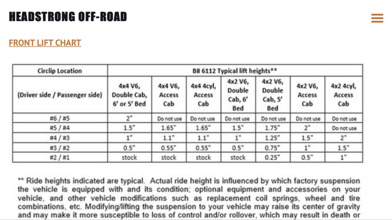

    so do the 6112's and 5160's add any height?
    if so what are the specs in the front and rear -- height wise?
  13. Dec 18, 2018 at 11:25 AM
    #33
    Juforrest
    Juforrest Dumb!
    Nov 23, 2015
    #170434
    5,936
    Justin
    Seattle
    Reformed Taco driver in a GX460
    5160's are just a reservoir shock they don't add height. The 6112 were assembled on the first notch and added 1" of lift on install. They have settled a little and are closer to .75" of lift.
  14. Dec 18, 2018 at 11:30 AM
    #34
    Juforrest
    Juforrest Dumb!
    Nov 23, 2015
    #170434
    5,936
    Justin
    Seattle
    Here is the table for lift with 6112's from @HeadStrong Off-Road IMG_1394.jpgHit up Marie for some more accurate answers. Bonus points for buying from them as well.
