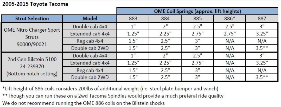

  11. Jul 4, 2020 at 7:35 AM
    01 dhrracer
    01 dhrracer Well-Known Member
    Aug 27, 2013
    #111316
    1,918
    Palm Desert/Bermuda Dunes
    Still Shopping
    OEM spring chart.
  12. Jul 6, 2020 at 12:00 AM
    jjgandarillas
    jjgandarillas [OP] Well-Known Member
    May 9, 2018
    #252973
    314
    joseph
    Anc, AK
    SPORT DCSB MT
    ICON 2.5 VSRR, icon 2.0 ext travel, UCA’s, Ray 10 17x8.5 -12, 285/70r17 BFG Ko2
    What is the source of this chart?
  13. Jul 6, 2020 at 7:47 AM
    01 dhrracer
    Aug 27, 2013
    #111316
    1,918
    Still Shopping
    If I remember correctly I pulled it off of www.headstrongoffroad.com website. They do currently have a link to ARB's product page. I will see if I can find the source but it may not exist anymore.

  14. Jul 6, 2020 at 7:29 PM
    jjgandarillas
    May 9, 2018
    #252973
    314
    joseph
    Anc, AK
    SPORT DCSB MT
    after viewing the chart im concerned i bought the wrong everything lol. so if i ha ve a winch and bumper i really dont know what spring to get in order to get atleast 2.5 icnhes. I already ordered the 887 but im beginning to think that the 886 would have been a better choice.

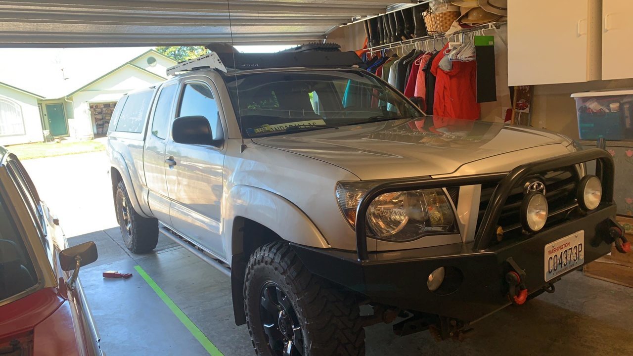

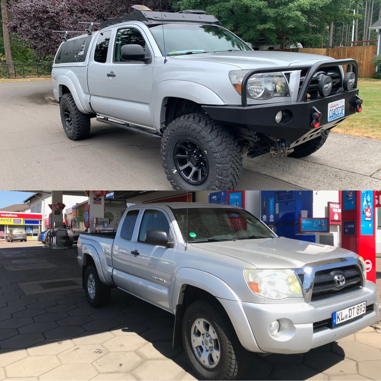

  17. Aug 12, 2022 at 2:59 PM
    #17
    jjgandarillas
    May 9, 2018
    #252973
    314
    joseph
    Anc, AK
    SPORT DCSB MT
    At the end of the day I am extremely happy with the ride quality and ride height. Pic shown is a before and after
