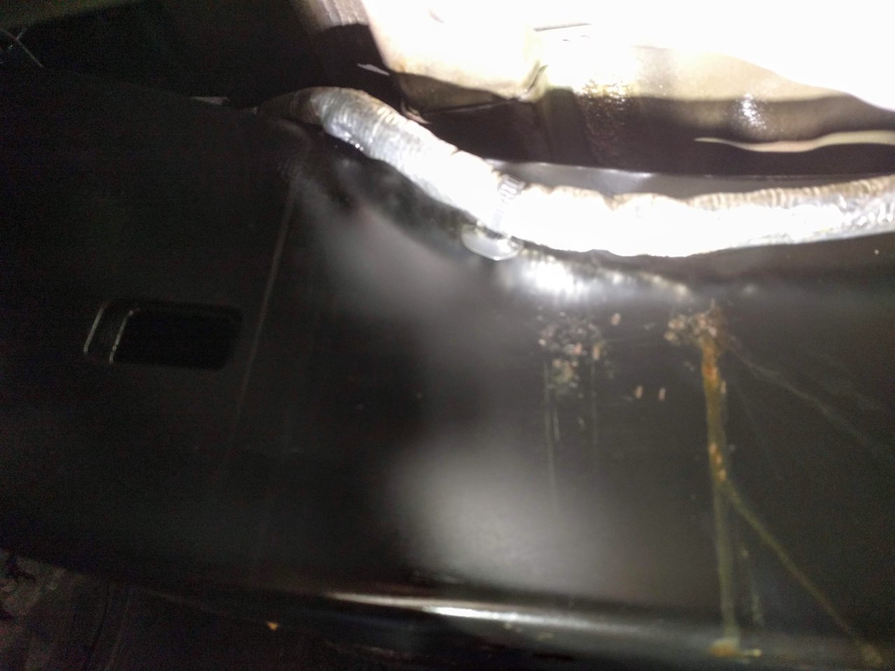

    IMG_20181126_163939.jpg Mine is rusted in the exact same spot.

    You just seeing it now? Wonder if a screwdriver would go through there. Dealership didn't seem to be surprised by the location on mine.

    I didn't see it till this past october . The rest of the frame looks pretty good.

    Jigheadworm that is a hole on its way its just a matter of time. Find out how much time you have for replacement eligibility. That rust is sandwiched between the metal can't get to it. That's exactly how mine started. Good luck

    I have till 3/21/2021
