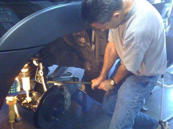

    Another reference: part time helper

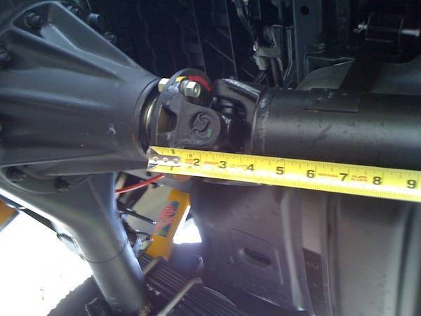

    Here I am measuring the bottom - tape measure positioned at the rear
    ...and taking the measurement at the front:
    Measure the length on the bottom of the shaft, as shown, and on the top (not shown) We're measuring to the nearest 16th of an inch here - and not so interested in the TOTAL length, as we are the DIFFERENCE between the top and bottom. This will make diagnosing and correcting any drivetrain vibrations easier. Unfortunately, I did NOT do this before I started, and I'm having to *guess* that the bottom was 1/16" longer than the top before I started.
    Record the measurements, we'll use them later.

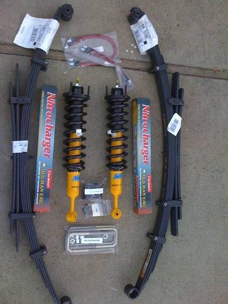

    Here's what we're installing.

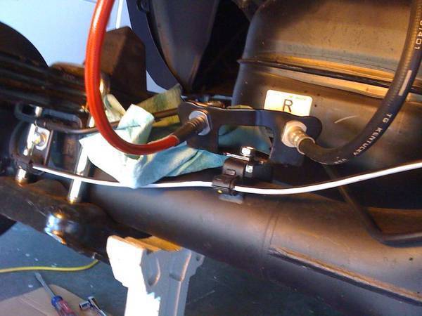

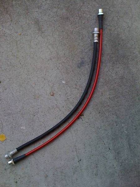

    If you want to run new rear brake lines, now's the time. 2014 EDIT: My perspective on elongated brake lines has changed over time.
    I found the extra clearance of the longer lines real helpful when installing the new leaf packs, but not enough to make up for the extra work of installing them. And over time I've come to realize that the OME shocks are the thing that limit the maximum droop of the rear axle, and ARB deliberately makes them so that they're NOT ANY LONGER than the stock shocks. So there's really no need to run extended brake lines if you're installing the OME suspension.
    Not shown, but you'll need flare wrenches for those brake lines. If you round off an ordinary nut, you can replace it. Round off a brake line flare connector and you're just hosed! :eek: Brake line flare nuts are torqued to 11 ft-lbs.
    The manual cautions that letting air get into the master cylinder means towing to the dealer. So as soon as I disconnected the old line, I clamped it with a vice grip. I'd like to use a non-destructive technique, but couldn't think of any. (no photo)
    Test fit the new lines in the brake line mounting brackets. I tested ONE end in ONE fitting and concluded they would fit, so I installed them in place. Mistake. The other line would NOT fit, even though it looked like it, so I ended up Dremelling out the brackets in place on the frame and axle. Would have been easier to unbolt them, put them on a bench, and fit them.
    Shop towels to keep brake fluid from dripping onto axle paint and floor.

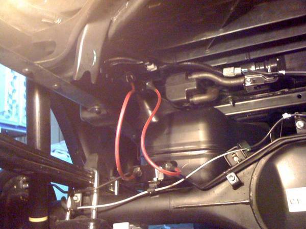

    One brake line in place - bottom:
    One brake line in place - top:

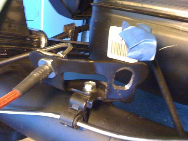

    Dremelling out the lower mount bracket. This would be much easier on the bench. Note tape to protect metal brake line end and to keep shavings out of brake line.
    Both lines installed. This will give extra clearance when we go to replace the rear shocks and springs, and need to lower the axle to create room to work.

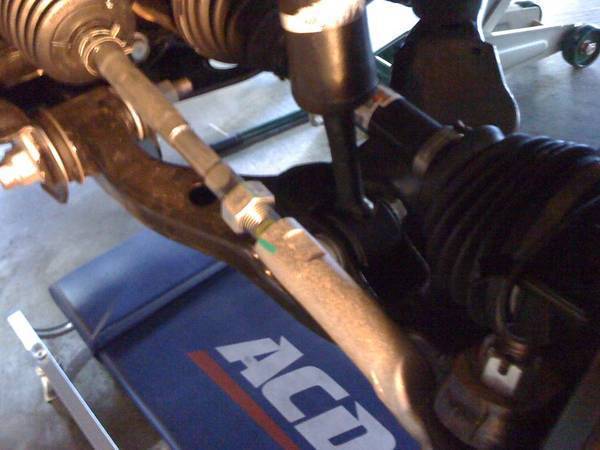

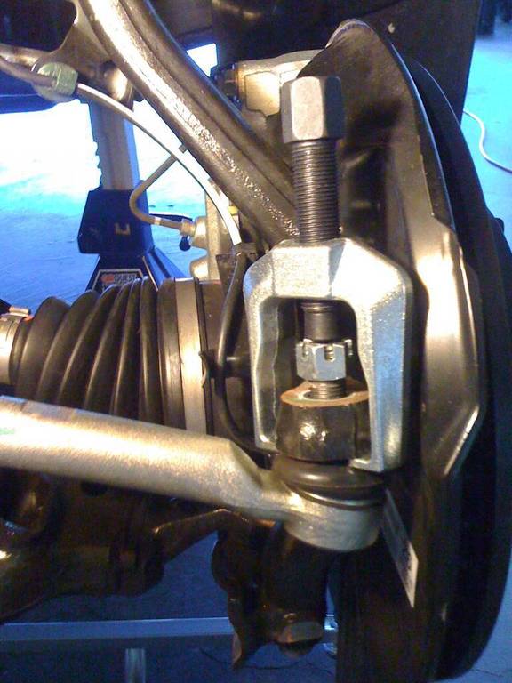

    I loosened the tie rod end fixation nut because the manual said to, but I don't think doing so is necessary since we're not replacing it, just moving it out of the way.

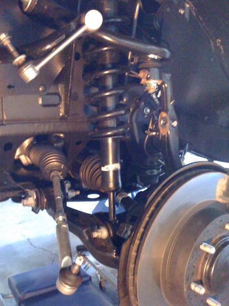

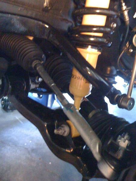

    I used a tie rod end puller to disconnect the tie rod end. This worked REALLY WELL! Kragen rents 'em for free - and I think it's only a $15 tool in any case. No risk of ruining the rubber seal or damaging the threads.
    Tie rod disconnected, ready to access the strut.

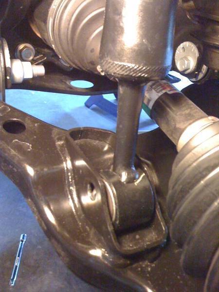

    Remove lower shock mount bolt.

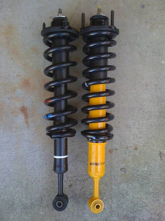

    Old vs. new strut. It's much beefier, but not much longer. This is the OME 885 spring, no spacer, but with trim packer on the driver side. If I had it to do again, I'd probably go 884 for a regular cab since it's so light, and after seeing my finished lift height and the final angles on my CV boots.

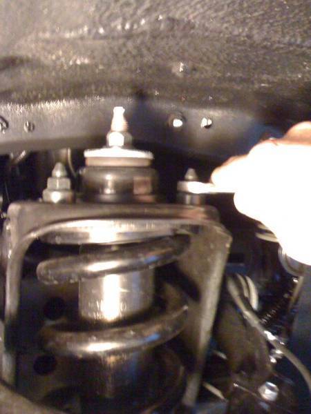

    Put the upper end of the new strut into place and put nuts on loosely to hold it there. Lower end will be hanging down. Now use a crowbar to pry down the lower control arm so the new strut/coilover can be put in place. You've gotta cowboy up for this. I tried having my sons, then my wife, do the prying while I tried to put the strut in place and that DID NOT work. It only worked when I put all my weight on the crowbar to pry the lower control arm down, then my wife could slide the new strut into position. Yeah, this photo's a cheat. We took it AFTER we got the new strut into position, but you can see how we did the prying. Use your brain in figuring out the pry/leverage points. That light skid plate down there is NOT going to hold against the crowbar. Again, be cautious of the ABS data wire.

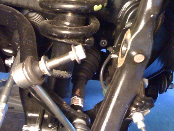

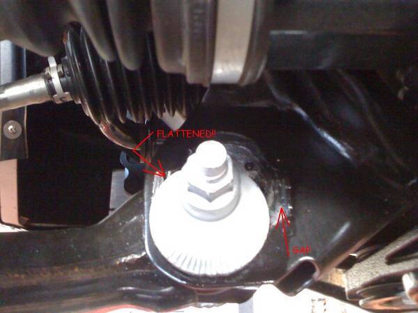

    EDIT: Use caution here!! A couple days later when getting the truck aligned, we discovered this failure in the LCA Pivot.
    You're looking at the driver side lower control arm pivot from the back towards the front. It's supposed to be held in place by two little flanges. The one on the left has been flattened, allowing the nut and and alignment ring to drift down and left. (The same problem exists on driver-side-front, but didn't photograph well enough to see.)
    No way to know for sure when it happened. But a fair guess seems to be that it might have been when forcing that LCA down with the crowbar. So -- use caution and inspect the LCA pivot point as you're applying that force! Make sure you're not damaging anything when creating space to put the strut into place!

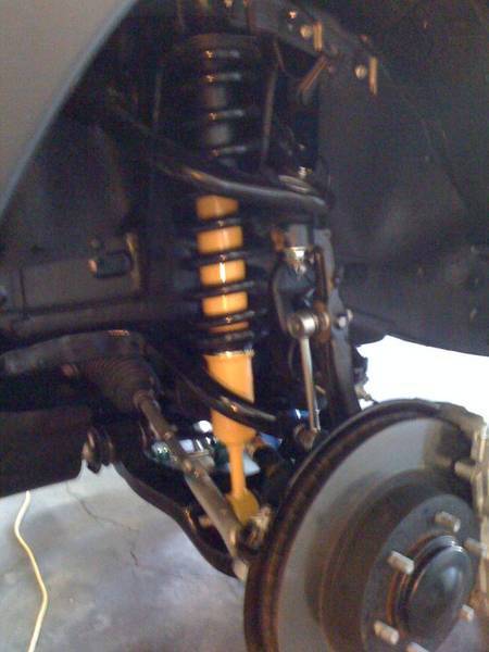

    New strut in place.

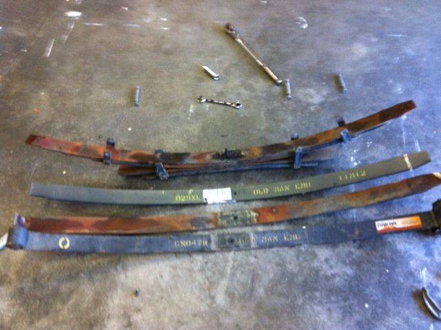

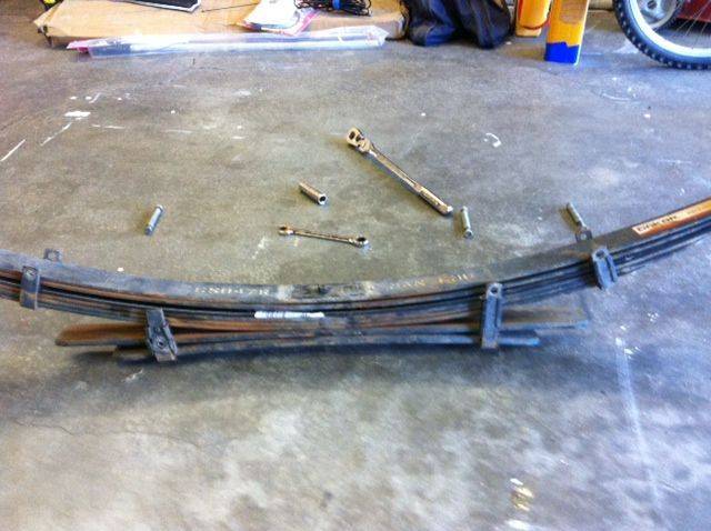

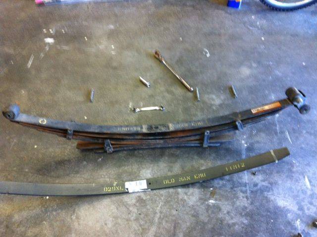

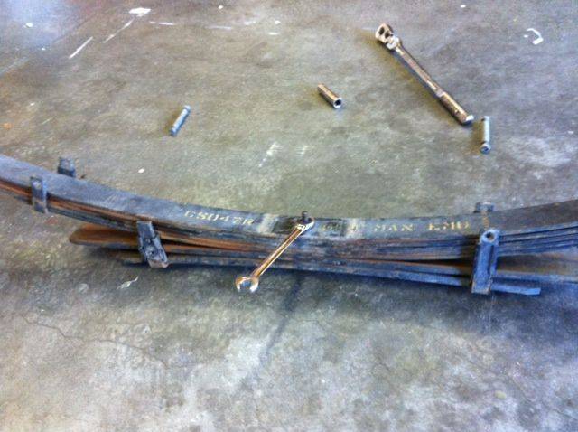

    Old vs. new leaf pack:
    AUGUST 2014 EDIT: If you want to install the Dakar Add-A-Leaf into the pack - skip to the end of this post (not the end of the whole thread) for a series of pictures showing the add-a-leaf install. For me, it was fine to begin with but over time I added a high clearance bumper with tire gate, mounted my winch in the back of the bed for storage, and started carrying a heavy load of tools and spare gasoline. Once all that was accumulated, it was time to go back and insert the extra leaf.

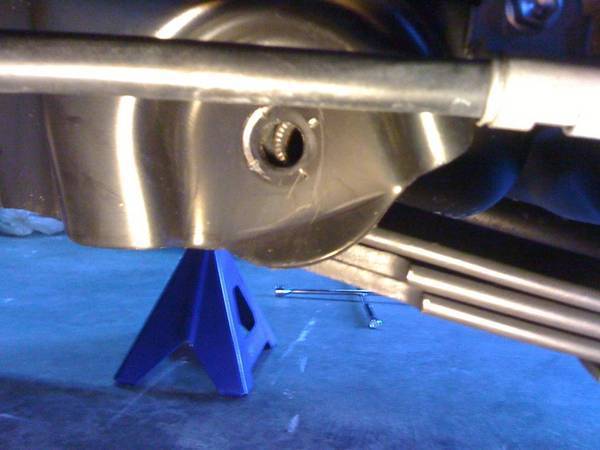

    Jack up rear under rear diff, place jackstands. Leave jack under the rear diff to support the axle, since you're removing it's support! (no photos)
    Remove old shock and leaf spring from one side (no photo)

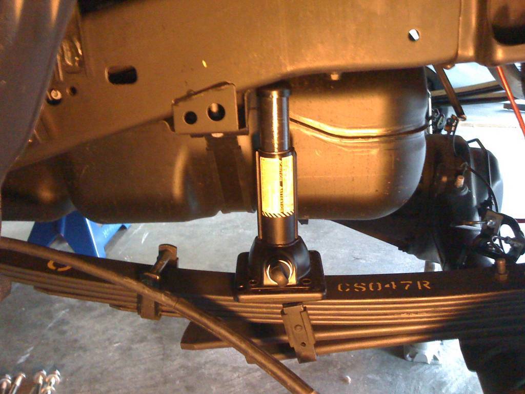

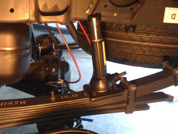

    Mount the nitrocharger shock. The bottom mount is wider than the factory mounting point, so you'll need to "persuade" it open with the crowbar again. It's easier to open it too far and let the bolt/nut close it up again when you tighten it into position. (no photo) Torque the lower mount bolt to the axle 74 ft-lbs (big bolt!) and to the frame 15 ft-lbs. (little bolt.)
    Repeat on the other side, and lower the car onto its wheels. It's the gangly teen look - suspension stretched out, but not "filled in" yet with larger meatier tires.

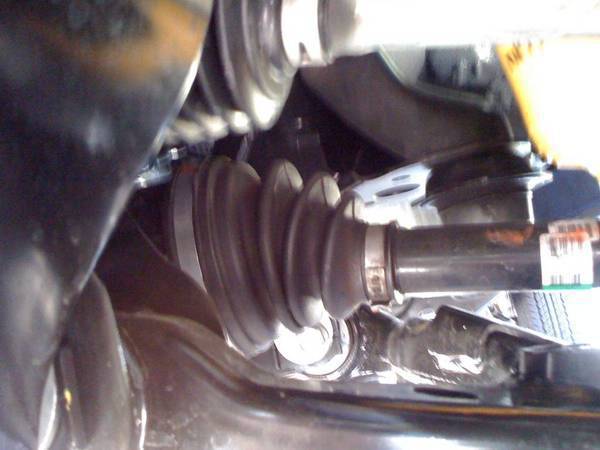

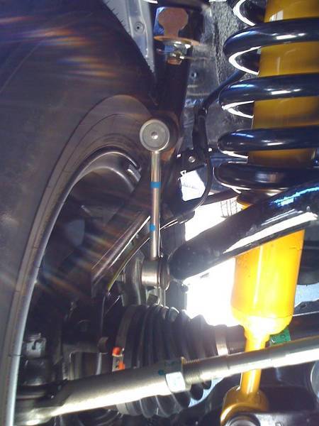

    A final look at those inner and outer CV boot angles:
    and

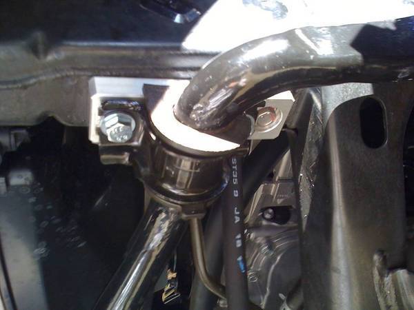

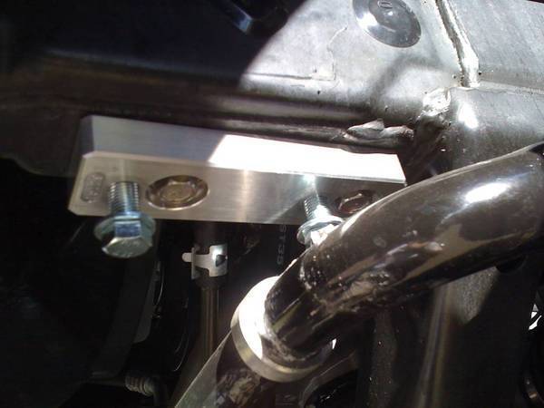

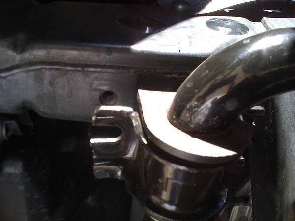

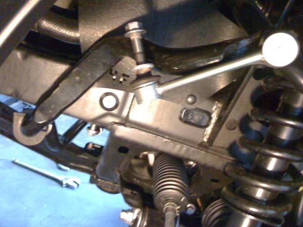

    Ever since the install, my driver side coil has been striking the sway bar on extreme extension, as after going over the far side of a speed bump. OME is not "supposed" to do that - it's supposed to clear. Nevertheless, mine hits. So I ordered a Toytec swaybar relocate and installed it as follows: really easy - hardly worth showing 3 pics for. Piece of cake. Don't remove the wheels, don't disconnect the sway bar ends. Do take off the front splash guard.
    Disconnect:
    Add the relocate:
    Bolt it back on. Thats it.

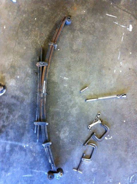

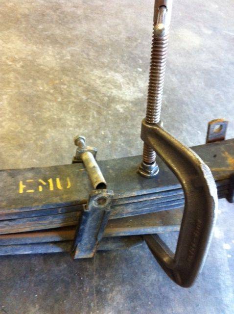

    AUGUST 2014 EDIT: Installing the Add-A-Leaf into the Dakar Leaf Pack:
    Removed the Dakar leaf pack:

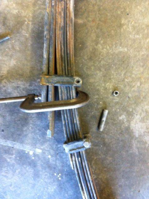

    You can remove the bolts on the "military wrap" easily, but ONE of them requires you to relieve the tension with a C Clamp. This is a 6" clamp.
    You can just remove the nut on the center pin bolt with no clamp. It'll unload gradually.
    New leaf in front of the unloaded pack. Where does it go?
    Well, it's easy. You can't miss it. Just keep pulling leaves off the top until you come to the first one that's smaller than the new add-a-leaf and stop there before removing it. There is a front/back direction to the leaves and it's obvious, as long as you remember to check and don't just slam it in there.
    Stack em up and put the nut back on. Again no clamp required. You want it tight but not nuclear. There's no torque spec and it's only a 14mm nut - a strong guy could easily overtorque and shear it off.
    But you do need the C Clamp for that middle wrap again.
    And, ready to install or re-install:
