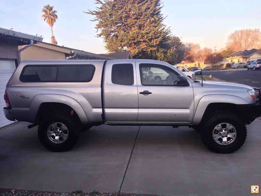

    OME 886, AAL, ARB Bumper, XRC8 Winch, Sony MEX-N5000BT, and one angry beagle.
    Just finished doing OME kit up front by myself. This writeup was a great help.
    I started with a pre-assembled set of 886 coils and rancho 9000 shocks + top plate spacer.
    Here are the steps I followed.
    I removed the sway bar completely and separated the lower balljoint from the spindle.
    I had trouble moving the lower control arm, it seemed to be totally stuck. I loosened the alignment bolts and it moved with a great deal of grinding and complaining but much easier, I believe the people who damage their alignment tabs fail to loosen these bolts.
    Putting it back together was pretty easy, I used very tall jack stands to I had no trouble getting the new shock/coil in by swinging the LCA out of the way.
    Once the shock was in place I put the lower bolt in first then used a jack to lift the LCA up and guide the top three bolts through the shock mount and installed the nuts.
    Getting the LCA balljoint back together with the spindle was tough as jacking the LCA up lifted the whole truck.
    I turned the stock bottle jack upside down and pushed down on the UCA, once it was close I put the two bolts back in and tightened it up.
    Torqued everything to spec and took it out for a drive.
    Notes for next time:
    A second set of hands would have helped a lot.
    If you can find someone who has done an install before it goes a lot faster.
    I'm super tired. Took about 7 hours with a food break. The other side took WAY less time to do than the first. I bet I could do the whole thing in half the time now that I've done it once.
    The sway bar is a pain and I suggest not putting it back on.
    Alignment seems ok, but needs to be checked.
    ARB bumper/Winch put so much weight on the front that the inside of the tires wore down with the stock OR suspension. That was something I did not expect when I put the bumper on.
    Need to do an AAL in the rear tomorrow.

    AAL is done. It was a huge pain keeping the leaf pack aligned while compressing it.
    Alignment came out great with stock uca. ebe6ure5_1b20ddddf2eea422adbe34f227fc7706d738cd65.jpg
